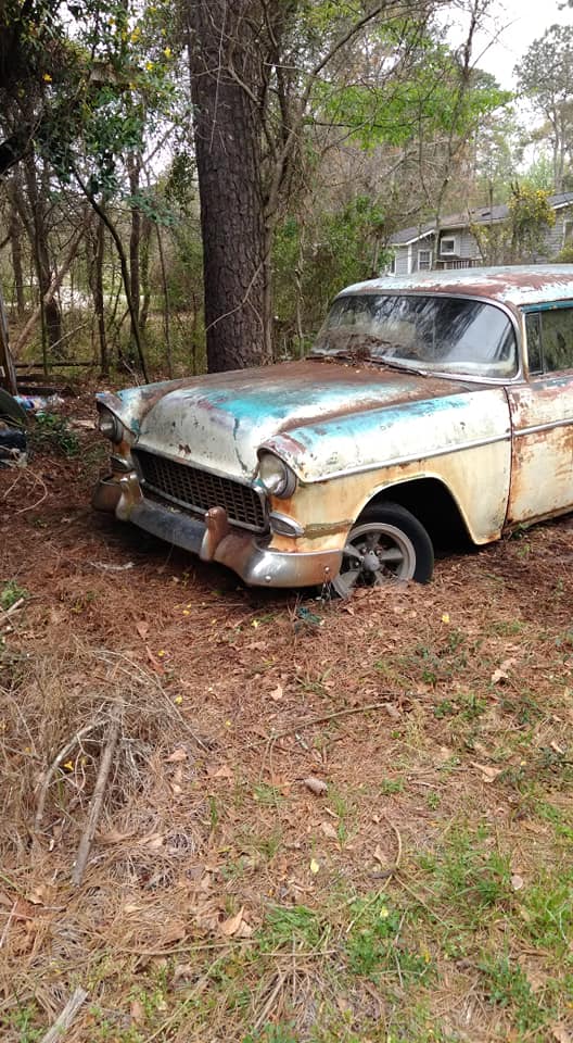

running the numbers on the engine...325 horse 327 from 1967.

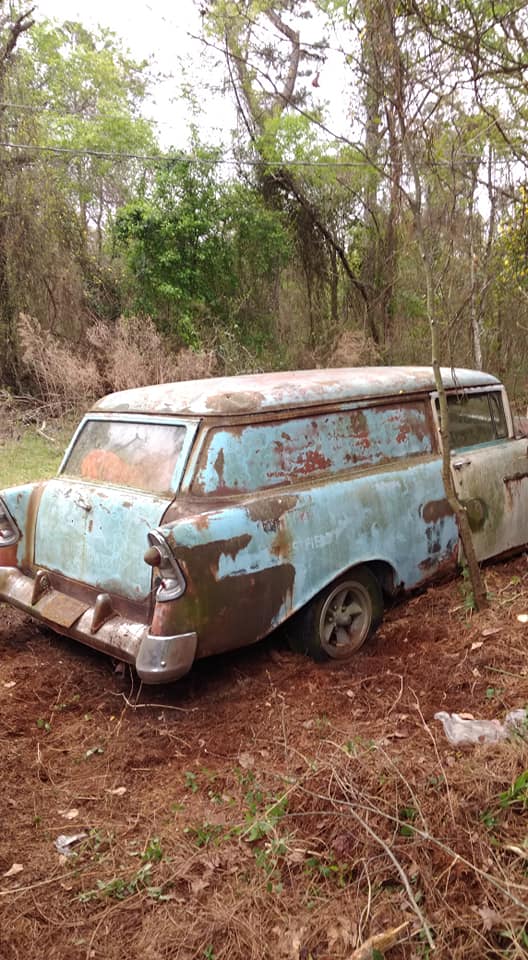

once I get her pulled out,ill take photos of the rust issues. Needs front floor pans,rickets,lower panels,holes in top from ladder rack, interior shot,etc etc. I will be attempting a first crank video tho.
it all depends of the amount of work the fenders take.I like the 55 front myself. Now,the hood itself I believe is 56 yet it's missing places for the front chevy shield. Inside on the floor is a 55 hood bird but it doesn't match the mounting holes the hood has yet the chrome lip fits the grill perfectly and that is a 55 grill.

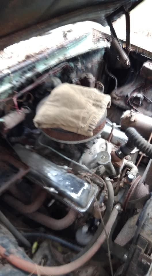

and underneath rests a 327,4 speed with a alloy scatter shield ,and a 12 bolt out of either a nova or early camaro with traction bars bolted from spring plates to clamps on the springs. Rear springs look heavier than they should be.

gonna keep the drive train set up the way she came.I want to bring her back to her former glory.
