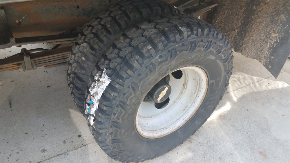

I put 4 new 215/85-16 Ironman tires on the rear of my Chevy 3500 with a 12' dump bed on it last week. As soon as I got on the road I felt them wandering around the road. Made the truck feel like it was swaying like it had a huge load on it. I called the tire guy to let him know and he had nothing else in stock so I had to wait a few days but he traded them out for some Nexen of the same size. They do the same thing.
I had worn out Ironmans on it that he took off. I jacked up the truck and there's no issues with suspension or steering. I tried 80 psi on both stes of tires and it may be worse with the Nexens. I just ran them down to 65 psi to see if that makes a difference. He mounted them at 70 psi.
He will work with me to get it resolved. He even said that he had issues with two other sets of Ironman tires after he put mine on.
It feels like the truck is way overloaded and is trying to balance on the center but not doing a good job of it. I have to drive it to keep it between the lines and don't even think of getting it swaying on the highway at speed!:eek:
What could it be? They are E rated tires. I'm thinking just cheap chinese production?

the thread might be 10 ply but how thick are the sidewalls. most tires need to be scuffed in some i would give it a 100 miles ( so the thread can loose the oily shine from manufacturing) and see if the traction is any better. Could be running to much air pressure in them. make a thick mark across the thread surface on the rear tires with chalk and then drive straight for about 50-100 feet and see of the chalk has worn off evenly. wear on center too much pressure wear on edges not enough. this is assuming everything else mechanical is in good shape.
