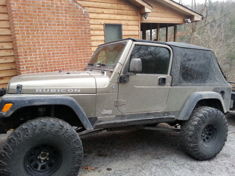

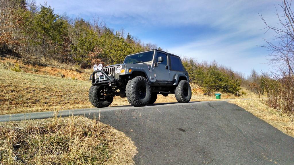

Well I just purchased my newest Jeep, a 2006 Unlimited Rubicon, khaki metallic, and am loving it. Thought I would share and keep everyone updated on how I plan to personalize it (built up from the previous owner) and make it mine.
First things first, a name is in progress, currently debating between Cleo, Lucy 2(first Jeep was Lucy), and Isis, I am open to suggestions!
Now here is the current list of modifications:
2006 Jeep Rubicon Unlimited
Khaki Metallic in color. Only 59,*** miles!
4.0 Engine w/ Automatic Transmission/ 4:1 Transfer case/ Dana 44
Axles/4:10 gears
Front/Rear air locking differentials
Superior Cromoly Axle Shafts
RUBICON EXPRESS 5.5 inch Long Arm Suspension System (full kit w/skidplate)
*Recently lowered using brand new 4" springs for a more stable ride
and lower center of gravity but 5.5" springs included with sale.
ACOS coil spacer/bumpstops in front (Jeep sits perfectly level)
RUBICON EXPRESS Sway Bar disconnects
CURRIE ENTERPRISES Currectlync Heavy Duty Steering System
TOM WOODS C/V Driveshafts
37"x12.50" SUPER SWAMPER IROK radial tires (30% tread or more) on 15x8
Black Rockcrawler Wheels
Custom Front Bumper w/WARN M8000# Winch and HELLA Offroad Lights
Brand new Roller fairlead and Winch Cable (not pictured)
POISON SPYDER CUSTOMS 'Rocker Knockers' rocker protection w/ tube sliders
Poison Spyder rear corners
ROKMEN Rear Bumper w/ 3/4" tow points and 2" receiver hitch
EMP Gas Tank, Radiator, Steering Box Skid Plates
Stainless Braided Brake Lines
K&N Air Filter
RUFF STUFF Specialties 1/4" steel Differential Covers
SPIDERTRAX 3/4" Wheel Spacers
Flush Mount LED Taillights
MAGNAFLOW Muffler
Great shape and super reliable.
New Rampage Soft top
I plan on selling the tires, wheels, and wheel spacers as well as the fender flares, I am searching for the best pair of 35's (or 37's) and wheels to pair with, and buying Metal Cloak tube fenders. I also plan to bedline the interior, switch the gears from a 4:10 ratio to 4:88 ratio, rear tire carrier.

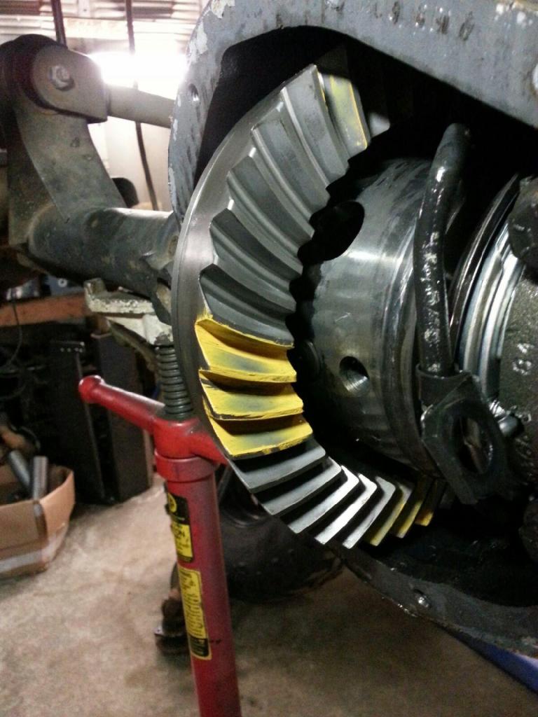

I recommend 4.56's over 4.88's on low pinion dana 44s due to the size of the pinion gears. I have seen more failures with the 4.88s than the 4.56's and the ratio difference is not significant.

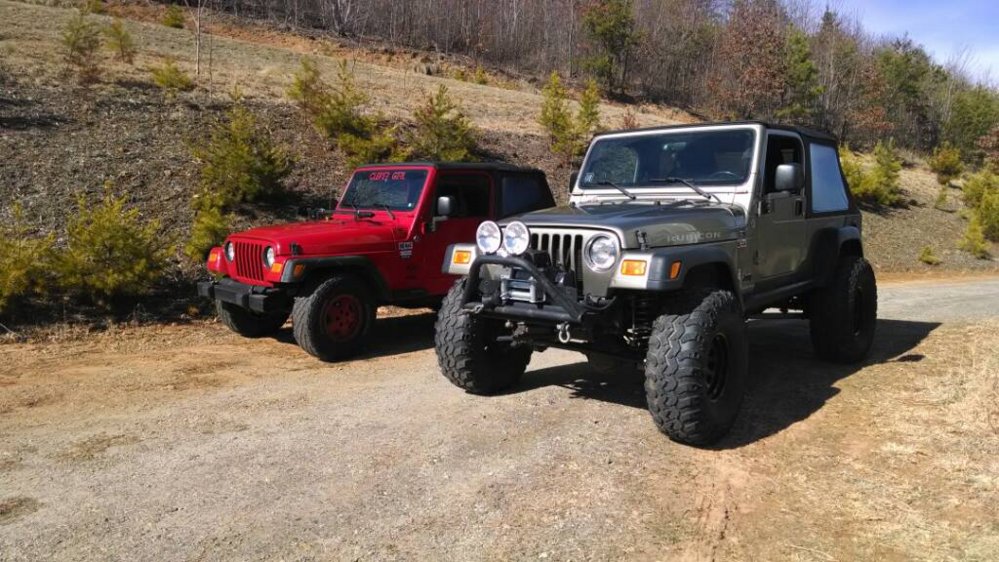

Had to do a side by side with Lucy. She was a great jeep and will be missed.

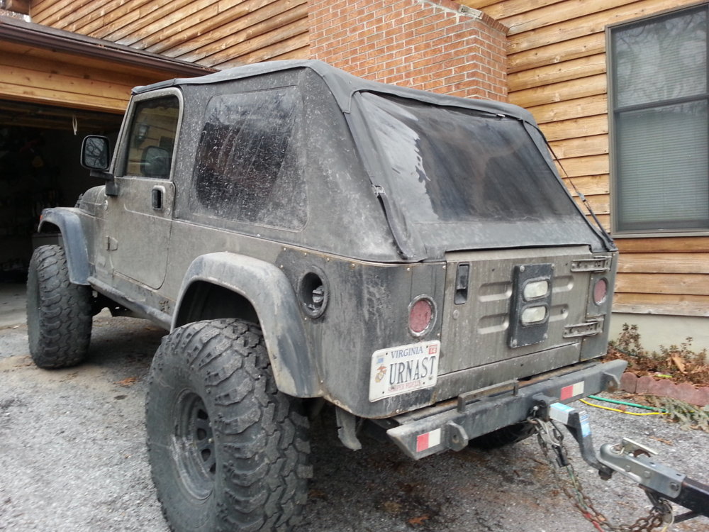

For example, in the picture is my previous Jeep Lucy, originally going to be a Jurassic Park TJ so the windshield decal became Clever Girl.
I need suggestions and opinions of clever decals.

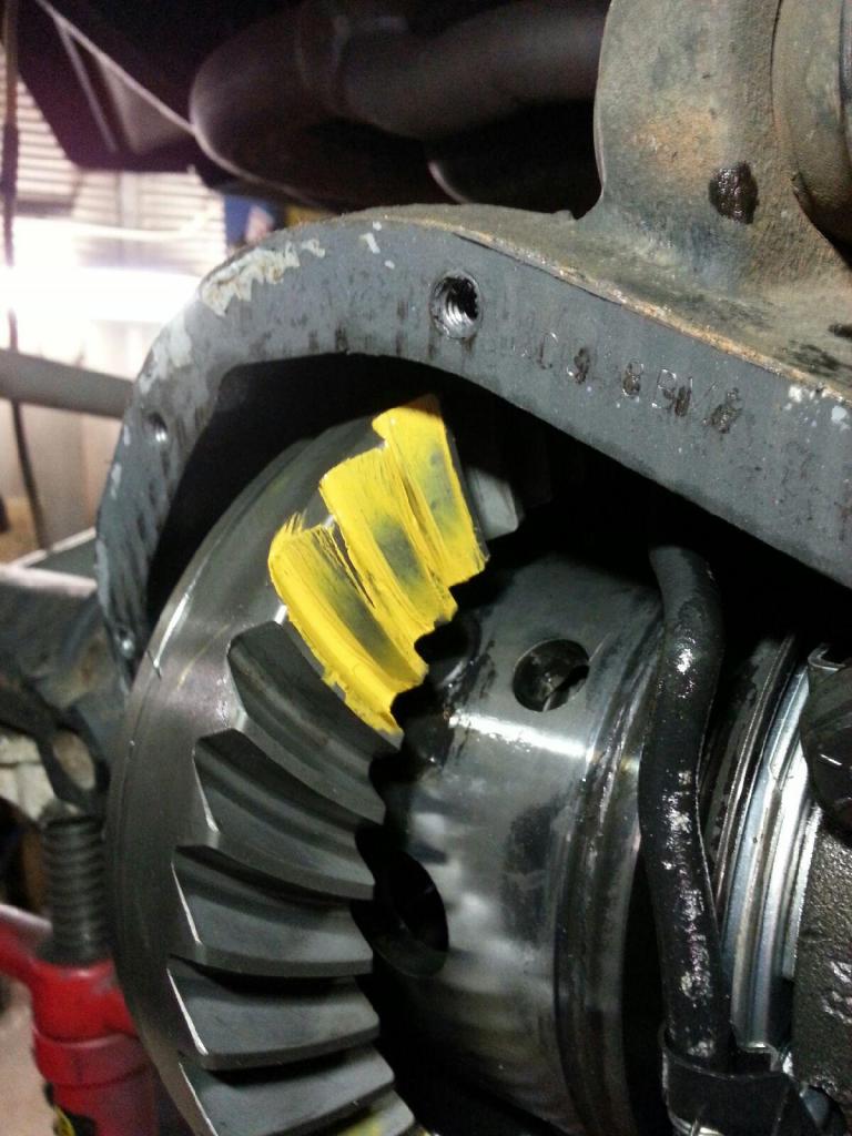

Well, I finally decided to go with my gut and what advice my technician decided, I upgraded my gears to the Yukon 4:88's and had them installed last week. The pull now behind the Rubicon is far greater than what was originally installed. Runs smoothly and shifts even more smooth.

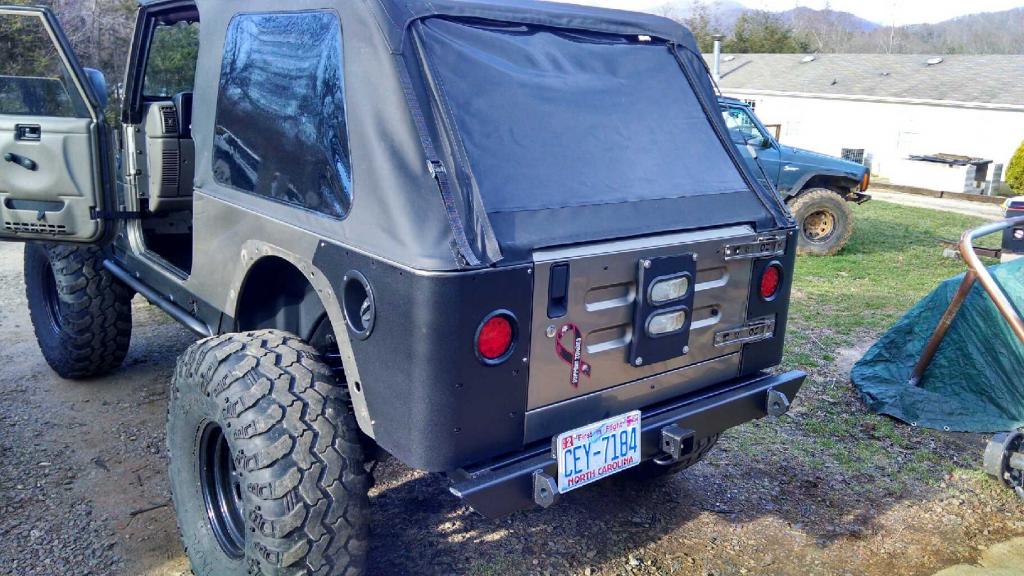

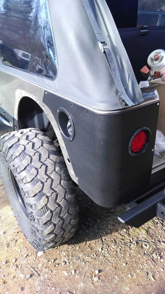

Spent a day out at the shop and had a chance to remove the rear corner armor to find the right side had rust stains (no physical rust) and the left side had specs of rust and rust stains. Cleaned up as much as I could, we sanded/buffed the corner pieces down and re-painted them with the rustoleum bedliner textured spray and they look brand new.

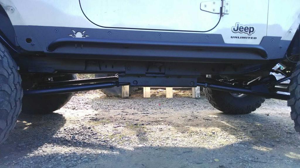

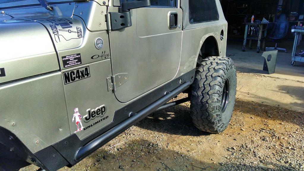

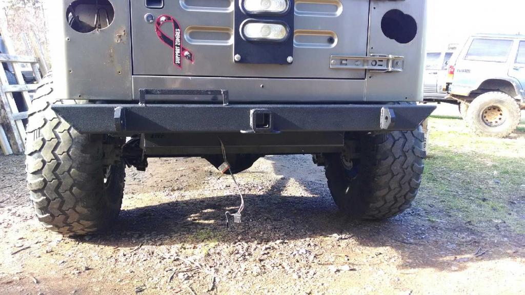

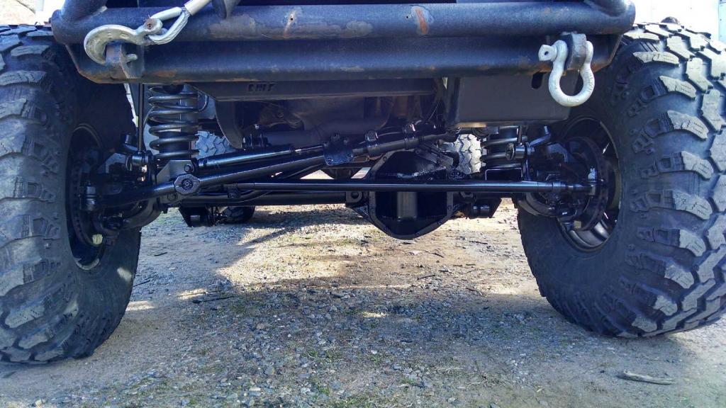

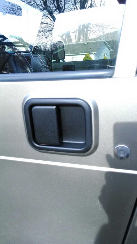

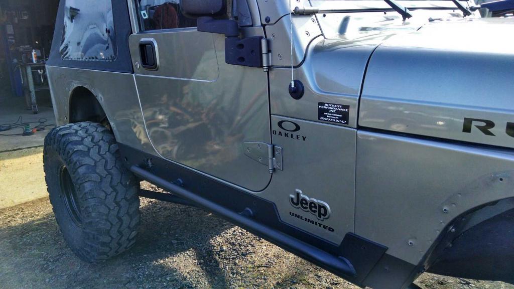

Got around to painting the rear bumper as well as the poison spyder rocker panels, as well as the rubicon express long arm suspension lift and undercarriage with the rustoleum bedliner textured spray as well. Also painted the door handles; They cleaned up very nicely!

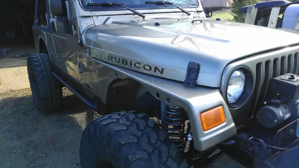

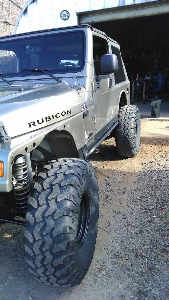

Removed the fender flares since I had sold them, discussing and potentially ordering tube fenders tomorrow if my fabricator doesn't have time to fabricate new ones.

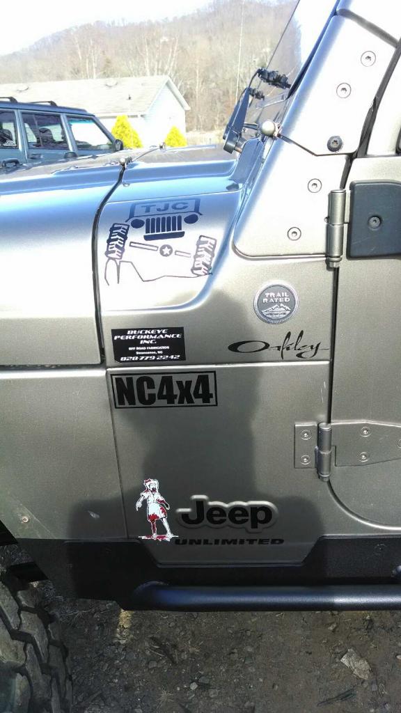

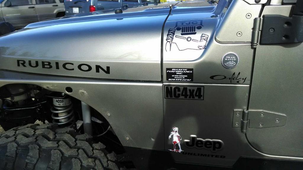

Replaced the factory Rubicon and Unlimited stickers from silver to black, added a customized NC4x4 sticker in black.
