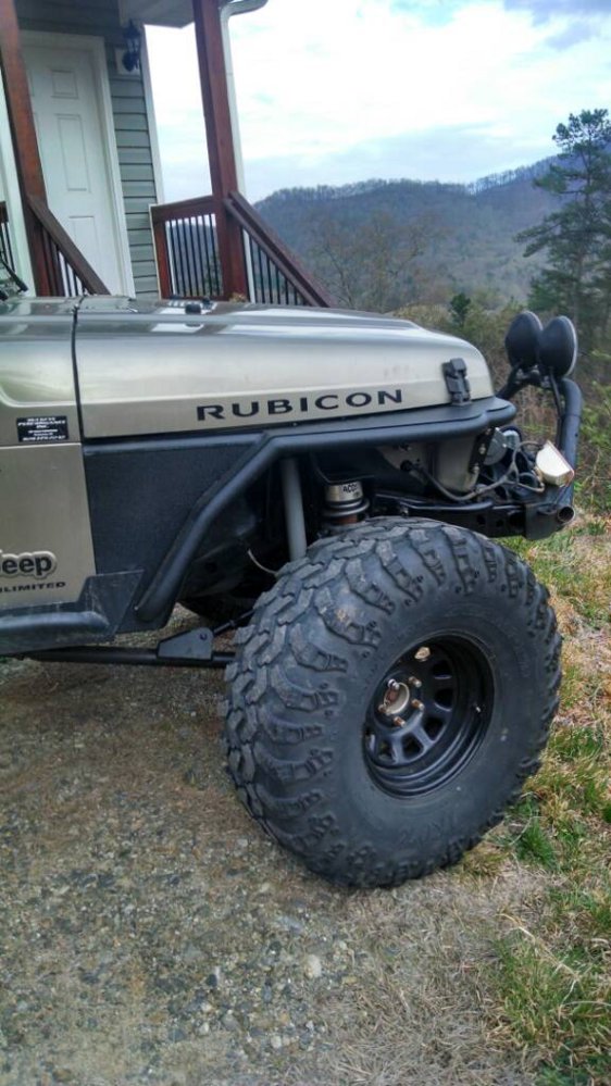

Got one tube fender installed. 6 hours per side. Guess I'll be driving lopsided for a week. Lol

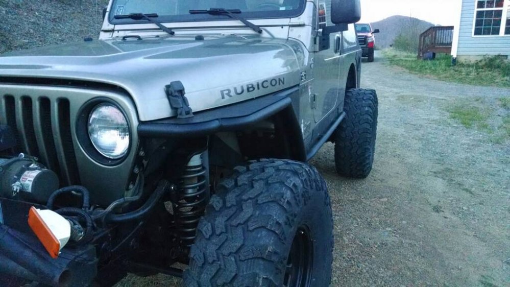

Finally installed my other tube fender and temporarily relocated the lights.

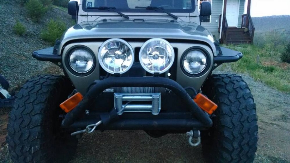

Something isn't right with the front end there. There shouldn't be that big of a gap between the hood and the grill. It looks like the grill needs to be moved up because the hood looks like it is in the correct spot.
The hood is sitting a little higher after we installed the tube fenders....
