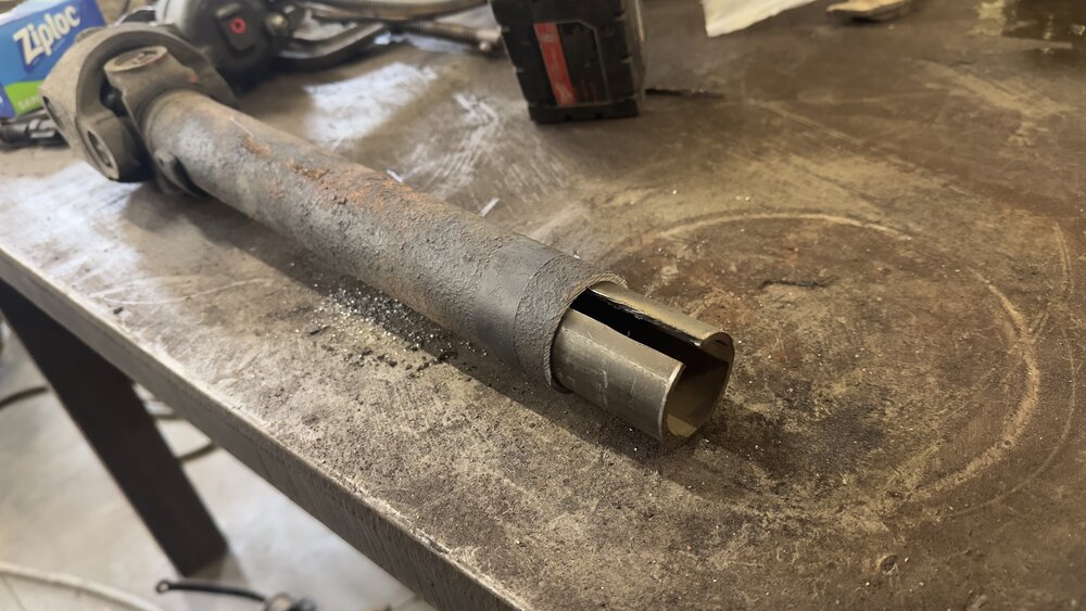

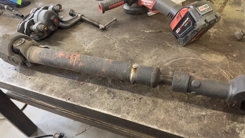

Yes, and also so I didn’t have to turn the tube down. If I recall correctly it was like ~10 thou oversize compared to the ID of the driveshaft, so it gave it a sort of pre-tensioned press fit without being way overboard. All it needed to do was align the two halves until it was tacked and give me some extra metal to burn into.
