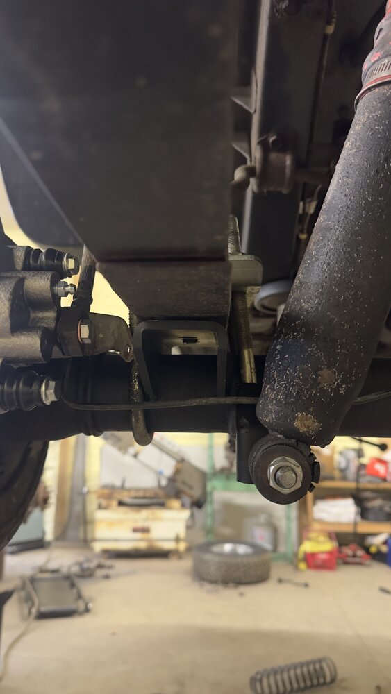

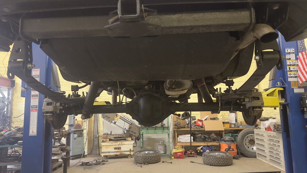

Also the rear shocks are completely blown. They were old, rusty, and for a 4” lift, plus when I put the shock mounts on the new axle it raised them up about 2” and I only had about 2” of up travel. So not too much of a loss, haha.

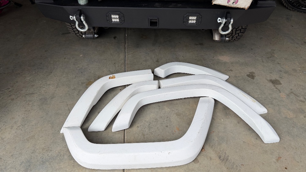

Install Xmax fender flares
