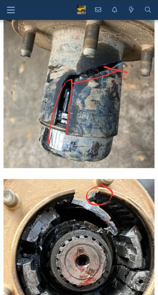

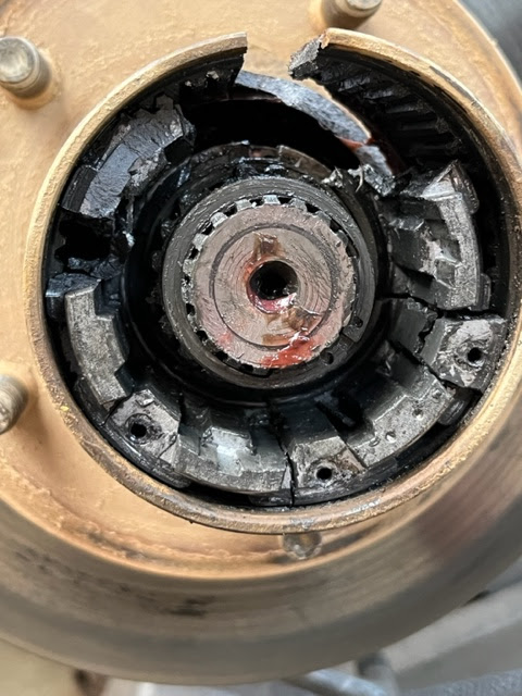

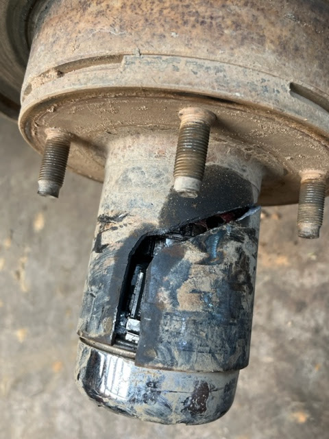

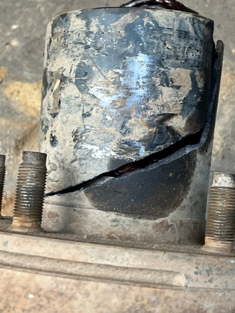

My right front hub let go on the first ledge of Cripple Creek last week. The axle and ujoint is fine. I'll be needing a good 5 lug hub if anyone has one laying around. I haven't even looked for the replacement yet.

If I were to guess I'd say that the locking hub mechanism failed and bound up.

Pretty cool. Looks like there was a little crack at the outside edge, and when you sent it the final burst of torque, the crack shot up the hub and then tore from the torque until it was loose enough for the innards to bust.
That's a good catch, Mr. Engineer
I actually bashed this side on rocks 2 years ago at Harlan so I'm not surprised. This is a replacement Warn hub on it but I didnt look for nor see a crack when I replaced it.
