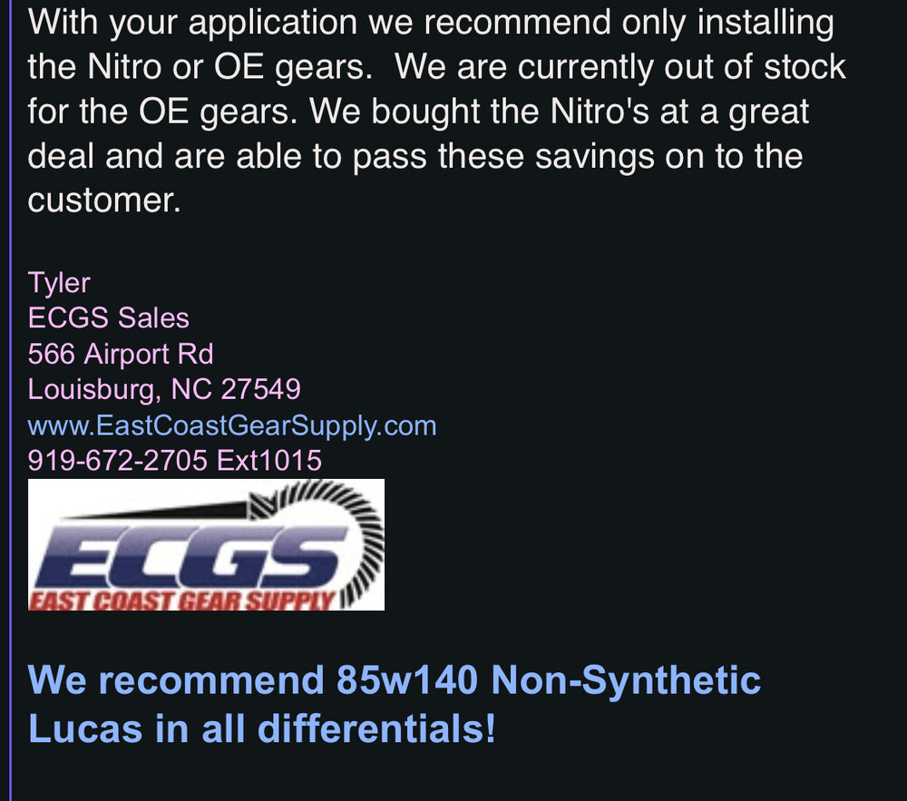

Going to ECGS they said nitro is they're go to for jk's. They're a good company that has done other axles for me so I trust their opinion. Like I said tho it's been years so I don't have any knowledge of which brand is better when it comes to anything inside the axles.
