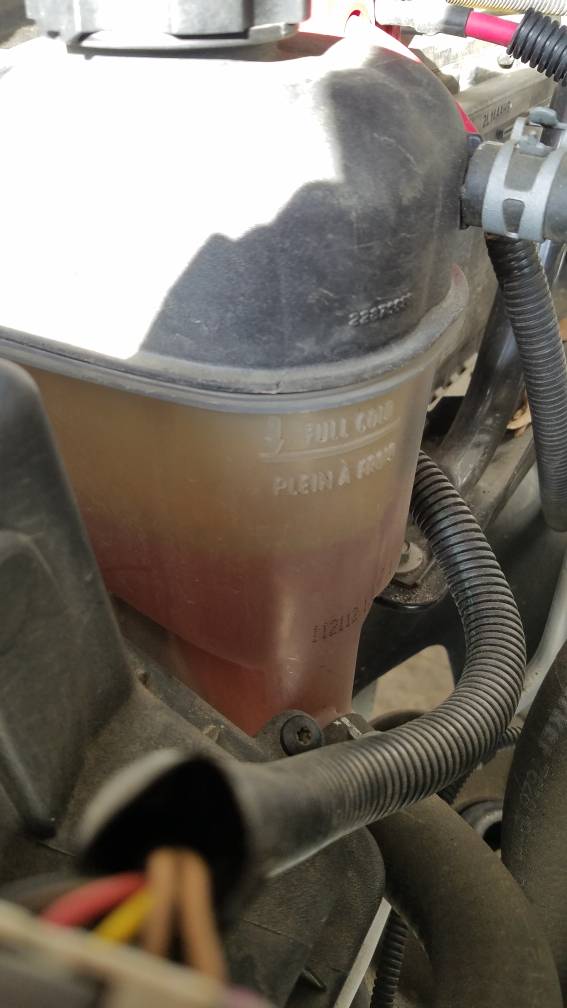

Only thing I found was the coolant level was a little below the cold full mark. I drove it to get a bottle of coolant and had heat before I pulled out of the driveway. While driving I changed the settings back and forth and it did what it was supposed to do. Not sure if it was a fluke or my wife doesn't know how to work the heat after having the truck for 5 years. Maybe an air bubble?
