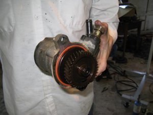

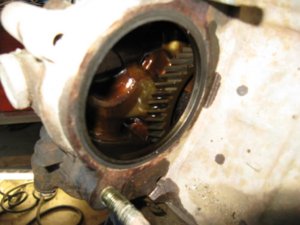

Also, may be important to add, this engine (1FZ-FE) uses a gear driven pump driven by the timing gears.
Pics:
