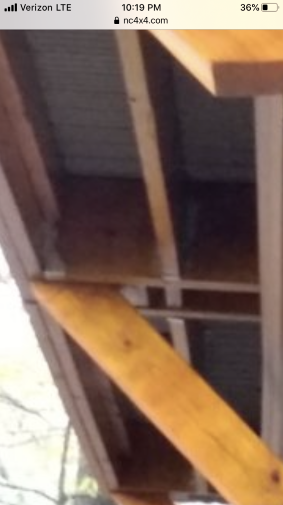

Basically @shawn was concerned with the "header" material used (2x8) to support the deck sections. Nothing really wrong with running joists parallel to house, but over time you'll end up with sagging in the joist, leaving deck surface wavy. The braces, if they were supposed to be functional, most of the strength is on the outer 1/3 of the upper and lower section, so the notch does compromise the strength - if it's functional support, but if it's truly cantilevered, I'm not sure why they were installed. Usually one would just use a spade or forstner bit to counter sink the head of the bolt perpendicular to the post.
In addition if 2x8 header(if that's what they are) were insufficient for the span and load, the whole deck is probably under built. How long are the sections running parallel to house? What material are the joists? What material is the decking? 5/4? 2x?
I see all kinds of questionable things going on...
looks like a poor attempt at a girder that is cantilevered with joists hanging from them. As Shawn said, that’s not correct.
not sure what their idea was at this attempt at a double 2x8? girder? Also, looks like the girder is hanging off of the band joist? And floor joists are hanging from the girder? The band joist hanger supporting the girder is incorrect; the hanger is supposed to support the joist from the girder.

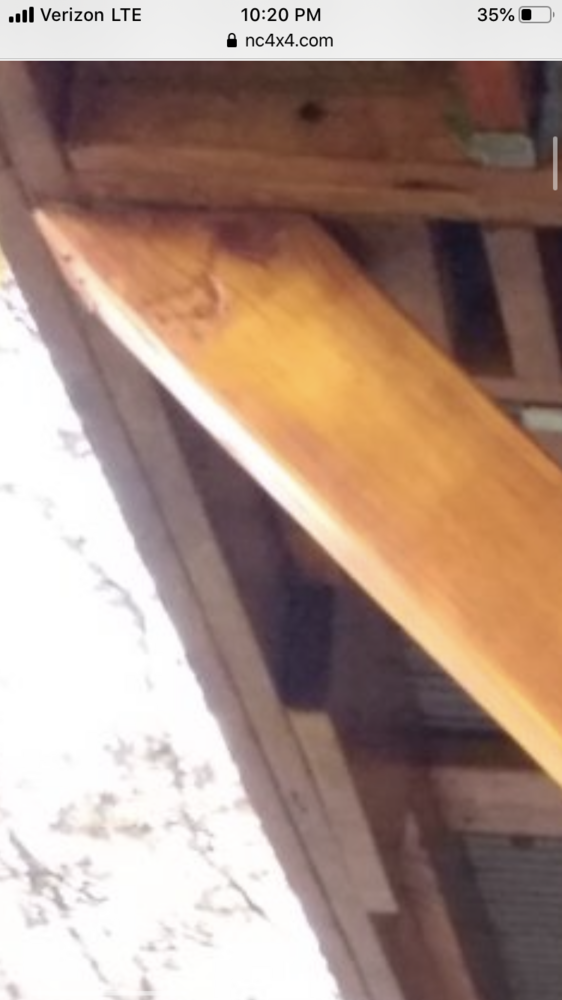

not sure what’s going on here with what looks to be scabbed together band joists? Also, not sure what kind of hangers exist on this band joist to the girder? Again, girder doesn’t look adequate or constructed correctly. No blocking between joists.
and, the obvious notches in knee braces.
