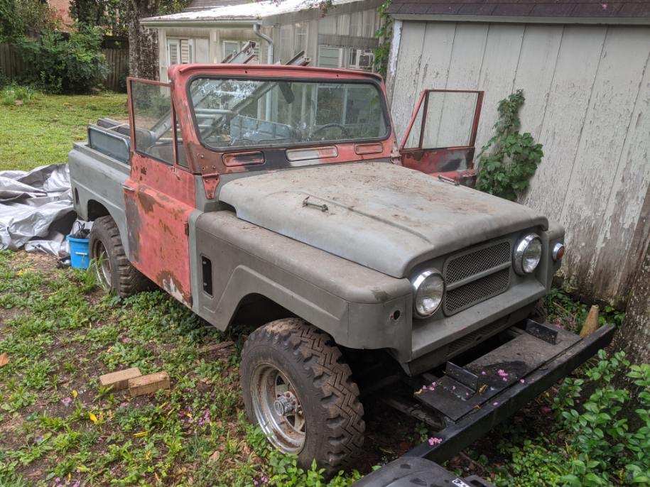

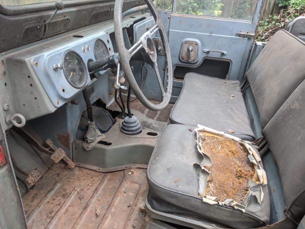

Well, it is official! Bona fide even! I got my title from the great state of South Carolina so here we go....

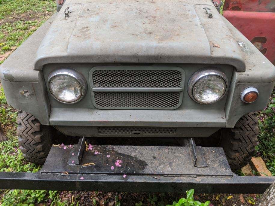

The subject is a 1967 Nissan Patrol. It runs and is in pretty good shape considering its life. The plan is a Ford 302 with an NP435 transmission, a Ranger torque splitter, and a Dana 300 transfer case driving an Isuzu Trooper rear axle and a Dana 44 front axle (4.56 Gears). Originally, I was going to keep leafs at 4 corners but I an really considering a radius arm front suspension and a leaf rear. Running gear is planned to be 35x12.50xr15.

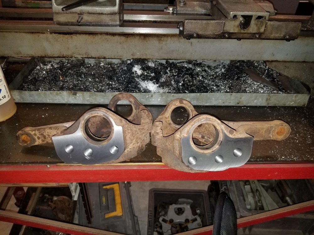

I picked up a set of D44 axles from a Waggy with flat top knuckles. I need to disassemble them and send them out for drill / tap to accommodate the high steer arms

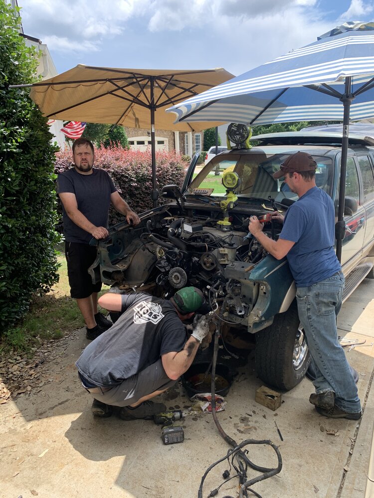

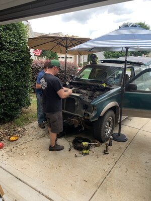

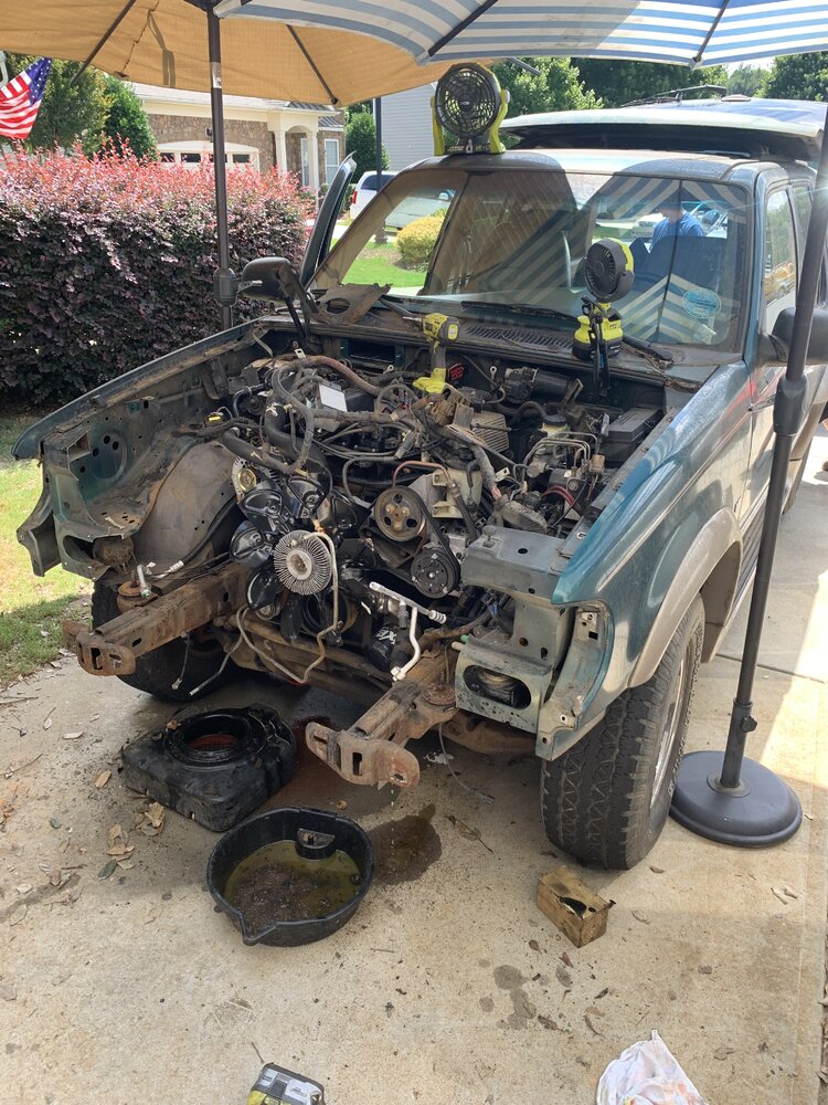

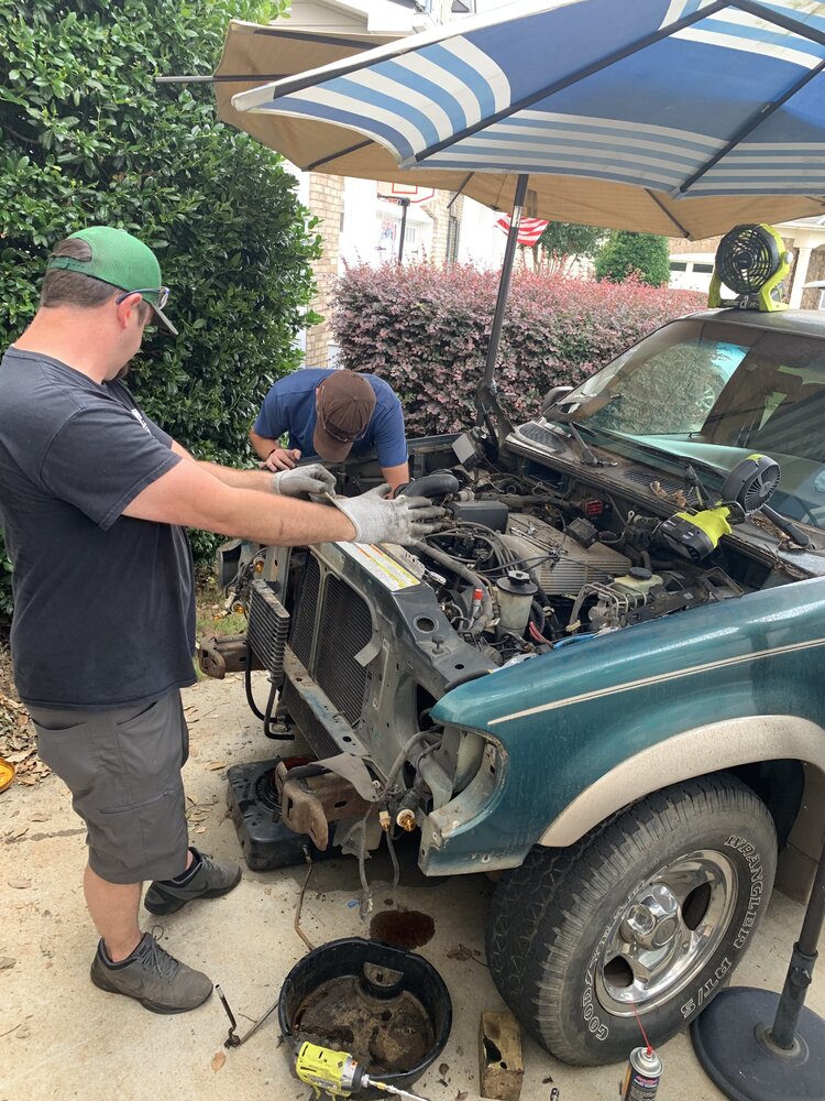

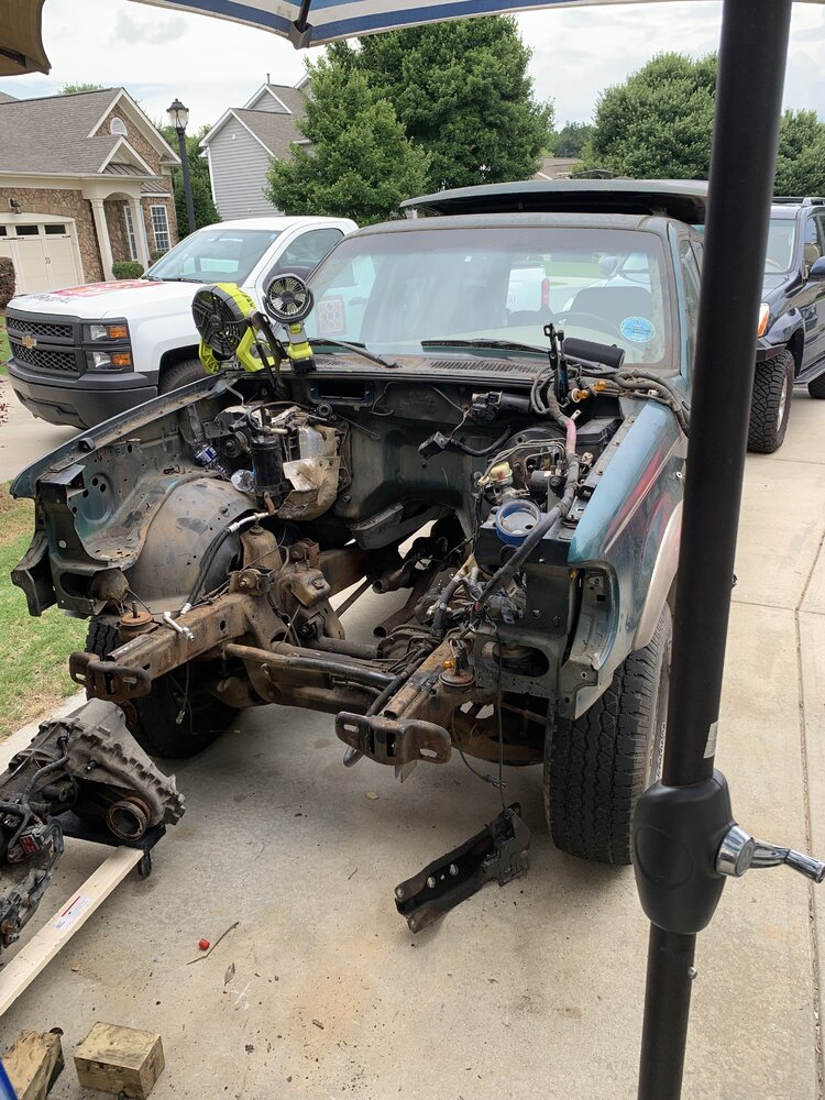

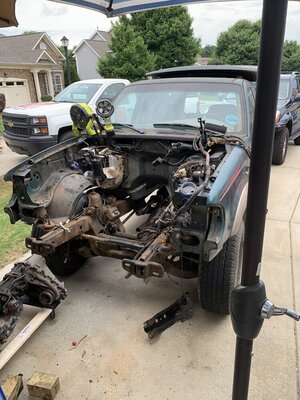

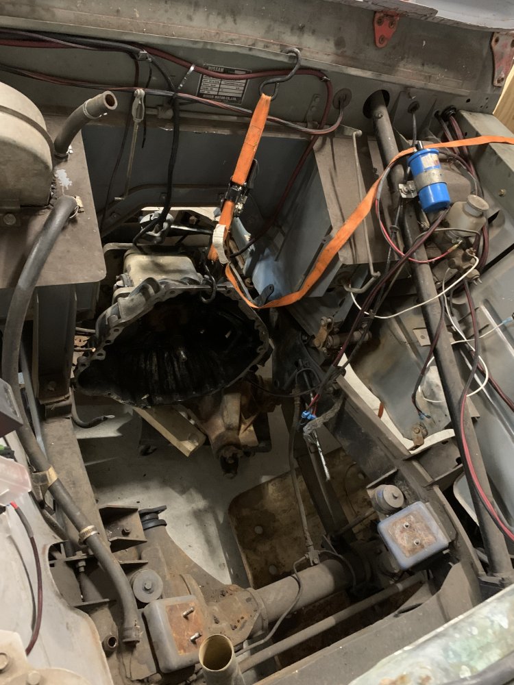

Some a$$hole in a grey RAM 2500 took my motor, transmission, and transfer case (with my help)

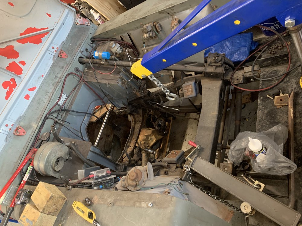

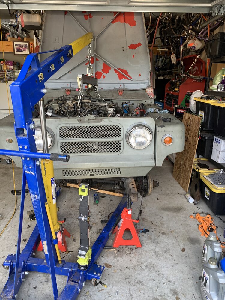

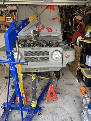

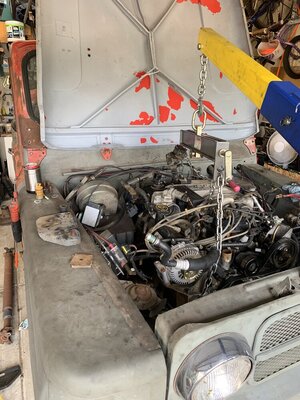

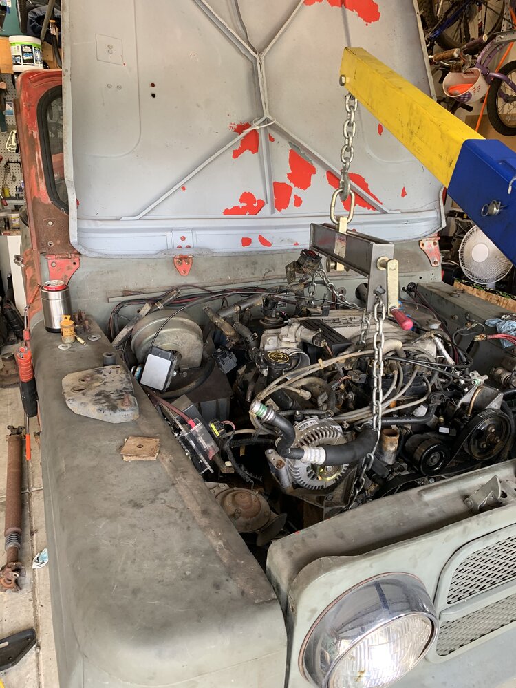

Test fitting the Ranger box with bellhousing. Looks like it will be a nice fit once the 302 is connected to it
Keeping it manual looks like? BTW, is that a Goodyear Racing engine hoist?
Yes, it will be a manual. The Ranger box will be coupled to a Ford wide ratio NP435. With the 4.88 gears and the 2.64 in the T-case, it will have a crawl ratio of 85:1.
Yes that is Dylan's Goodyear Racing hoist. Using the racing hoist adds as much horsepower as 2 Honda stickers!

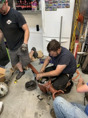

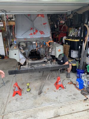

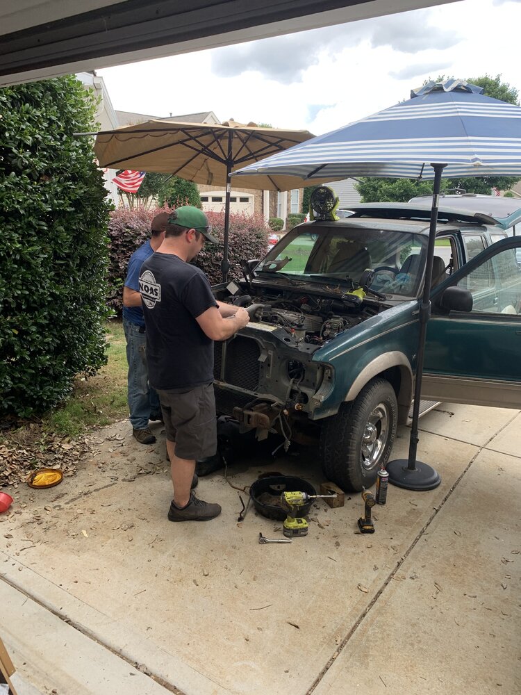

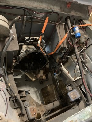

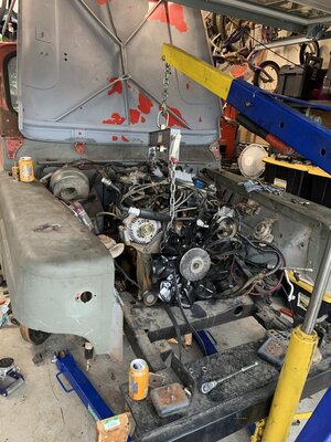

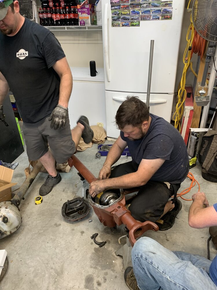

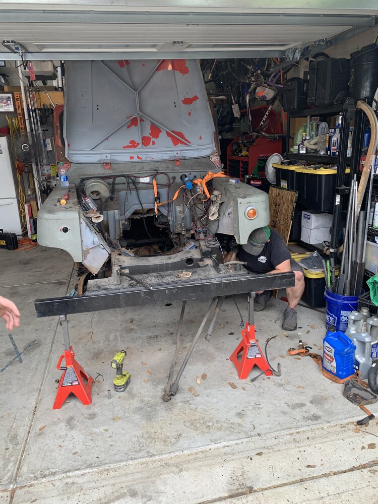

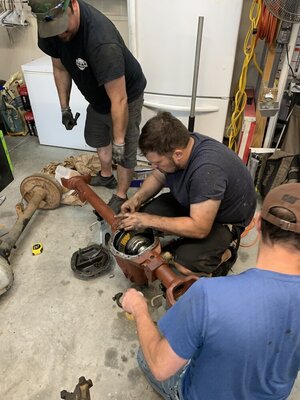

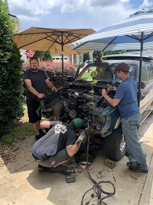

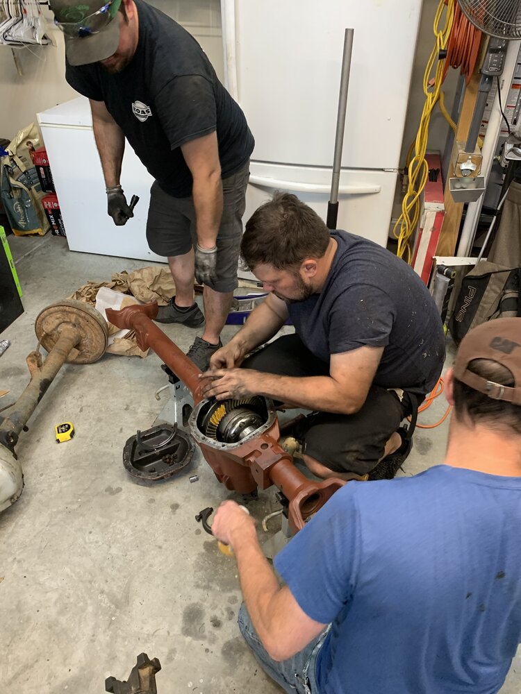

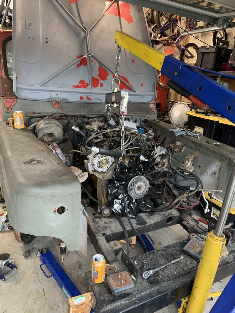

My birthday weekend was a huge success!! The 302 is in.... ish. it for sure fits but might need some minor "clearancing" to run it. I have headers on the way as well as some universal GM tranny mounts to be used for motor mounts. More to come on the mounting but here are some pics from the weekend. Also, while the monsoon passed, we were able to complete Rob's front axle!
