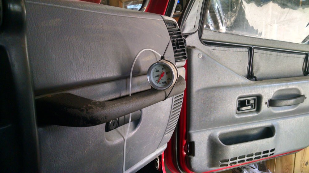

Mechanical gauge, installed. I don't know why @ol'Jeeps and @MarsFab charge so much. Fabrication is easy!
