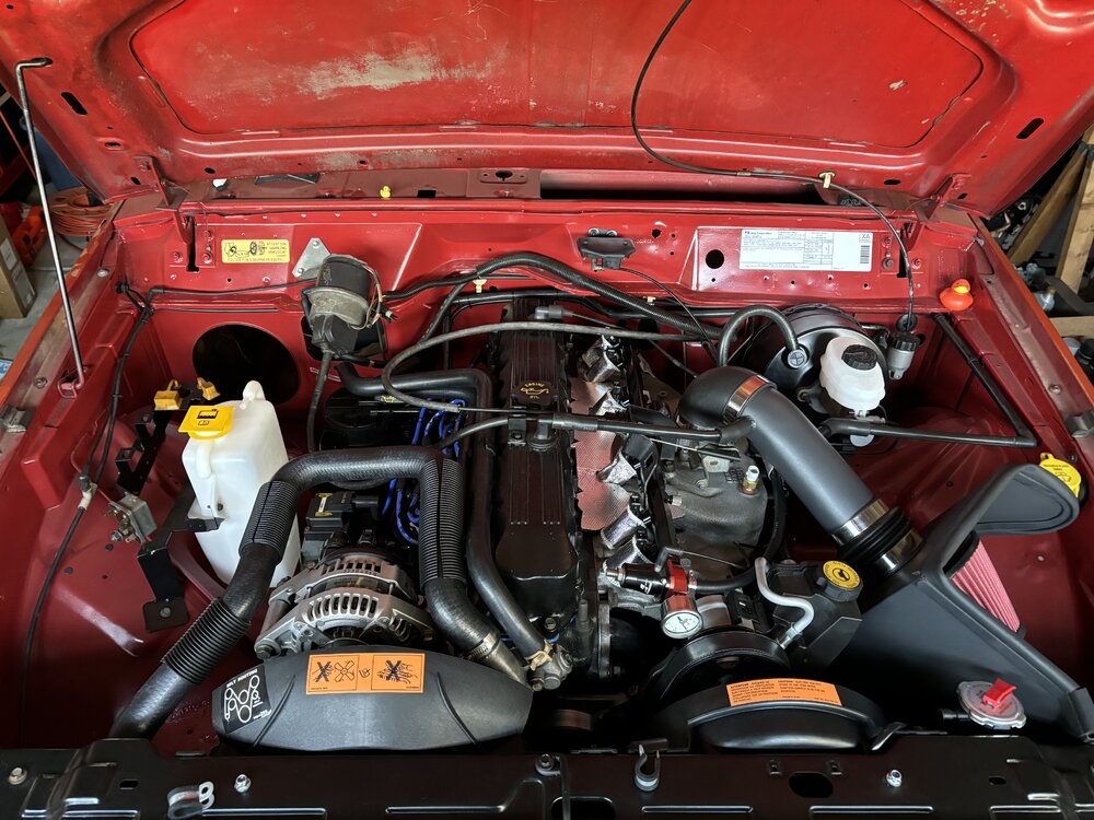

A few more details attended to up top, and a pic of the clutch hose setup. Figured out where I'm going to mount the cruise servo. Attaching to an HO throttle body, unlike the Renix XJ it came out of, where all the cable attachment is way different.

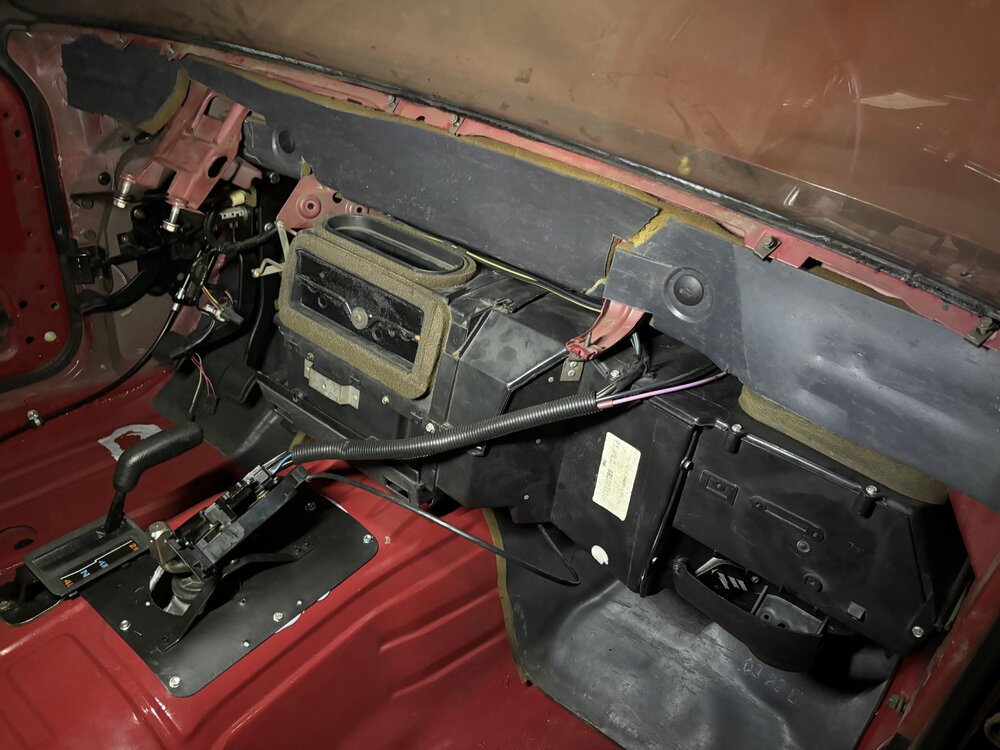

A couple things done on Saturday. Mostly the HVAC (in my case heater only) box. If you've ever taken one out, the studs probably came out of the housing when you backed off the nuts on the engine side. I screwed mine back in with some black RTV in each hole for extra grip. I also put a drop of black RTV at the base of the studs and slipped on a thin rubber washer (5/16" x 3/4") for each of the 5 studs. On the outside I applied the same washers under each nut so they're sealed as well as possible against water intrusion. My OCD in overdrive...
I capped off the pink line to what would have been the heater control valve (long gone) and looped the black line to the check valve off the main vacuum source line (partially hidden behind the cruise vacuum dump hose).

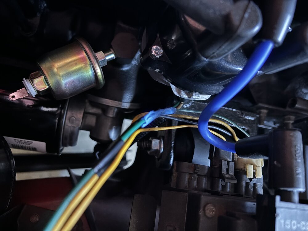

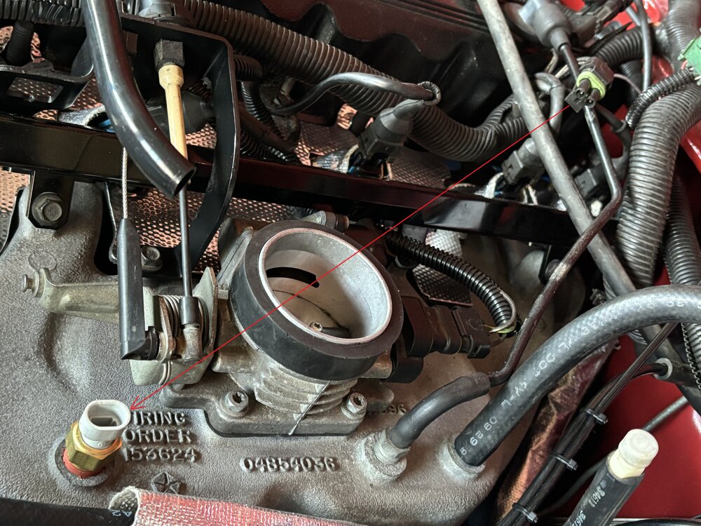

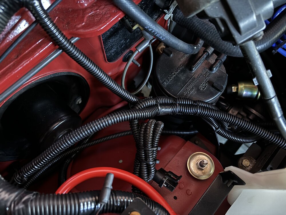

Sunday I started working the Engine Control Harness. Mine is Renix, from 89 or 90, so no C101 to contend with. Some changes are needed to make it work. Injector #3 connector won't reach straight up and down, as Renix didn't have the throttle bracket where it is on my setup. Tilting it works, but the rear arch of the throttle bracket needs significant clearancing to get the connector under it. TPS and IAC wires have to come out of the harness and move back about 4" to reach on an HO throttle body. All HO intake designs have the throttle body base exactly the same position, distance and elevation from the intake ports in the (HO) heads. I also have to make a connector adapter from the Renix IAT sensor connector to the updated GM IAT, relocated far away on the horseshoe intake. It'll run along the valve cover and shoot across between injectors 2 & 3. I haven't cleaned my throttle body and installed the TPS adapter yet.

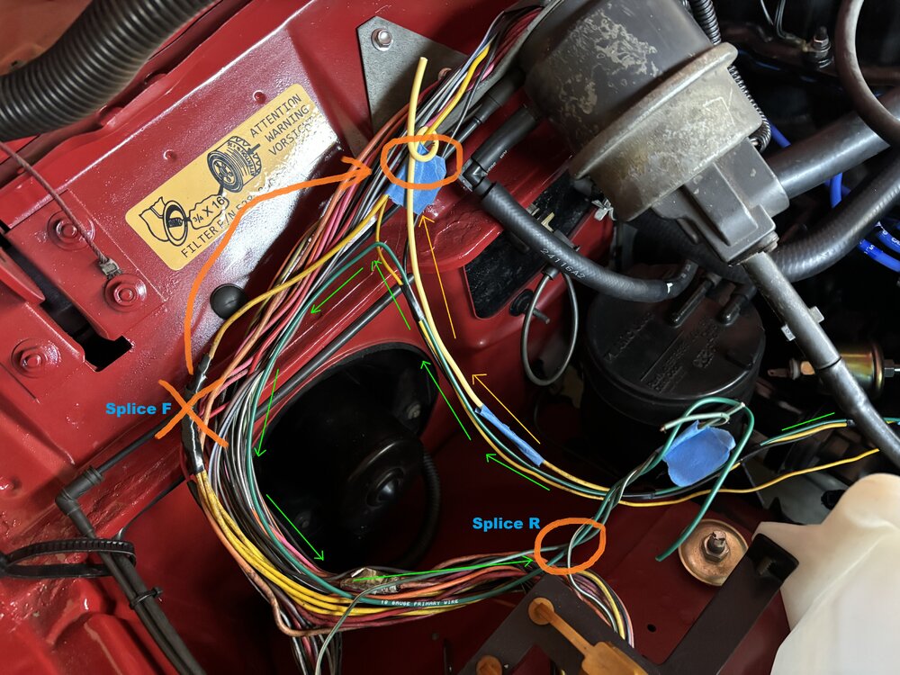

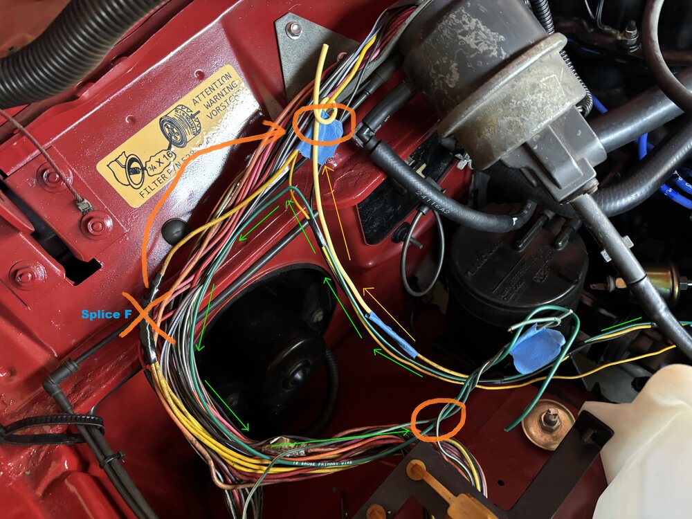

Rewinding back in time to my decision to relocate the coil and module- I wasn't sure if the connectors would reach. They don't. I'd hoped the wires for C213 & C214 would pull cleanly together out of the harness for extra slack to reach if not. They don't. So, what I'm doing is reorganizing it a bit to get C213 and C214 into one piece of loom and join the main part of the ECH between the cruise servo and blower motor. Yes, this is cutting into an intact survivor post-C101 Renix harness, but it would go back onto any other Renix, the only difference being extra length for C213 & C214.
1) Remove C213 pin C (18Ga, Grn w/trace) from splice R - extend green wire from C213 up and route back down and re-create the splice, so C213 & C214 can join the engine control harness at the same point.

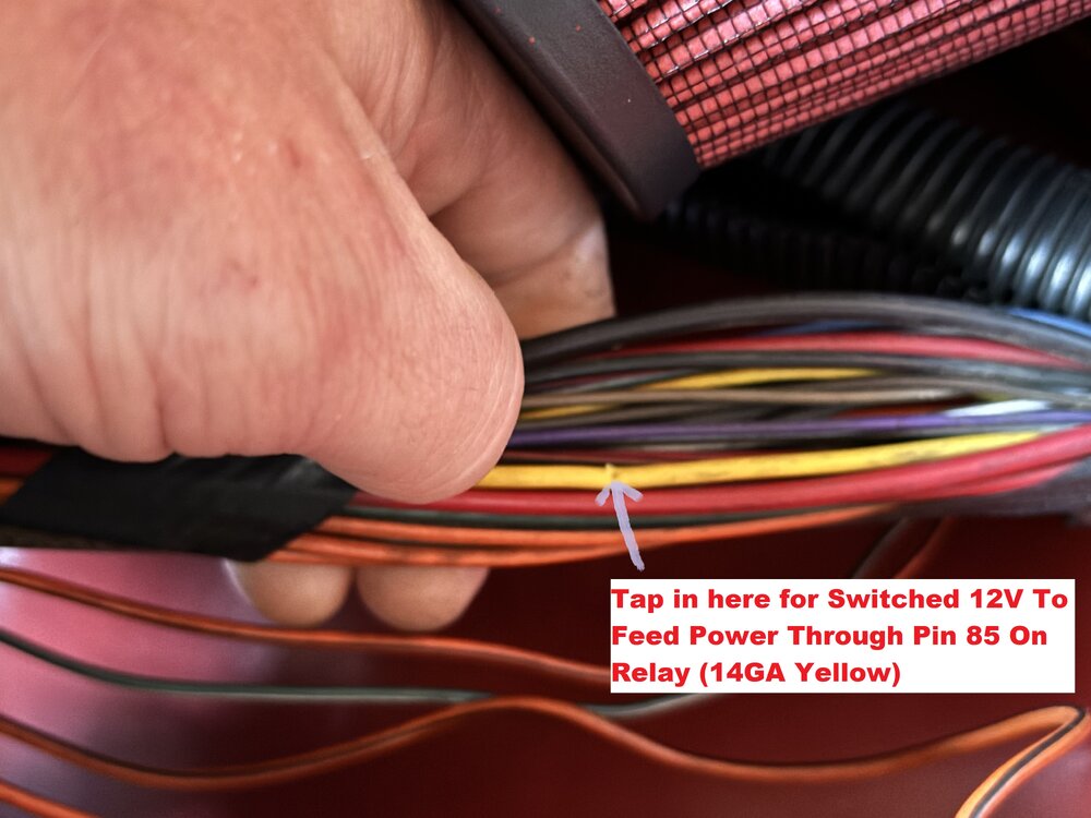

2) Remove C213 pin A (14Ga Yel) from splice F - move further up, again so C213 & C214 can join the engine control harness at the same point.

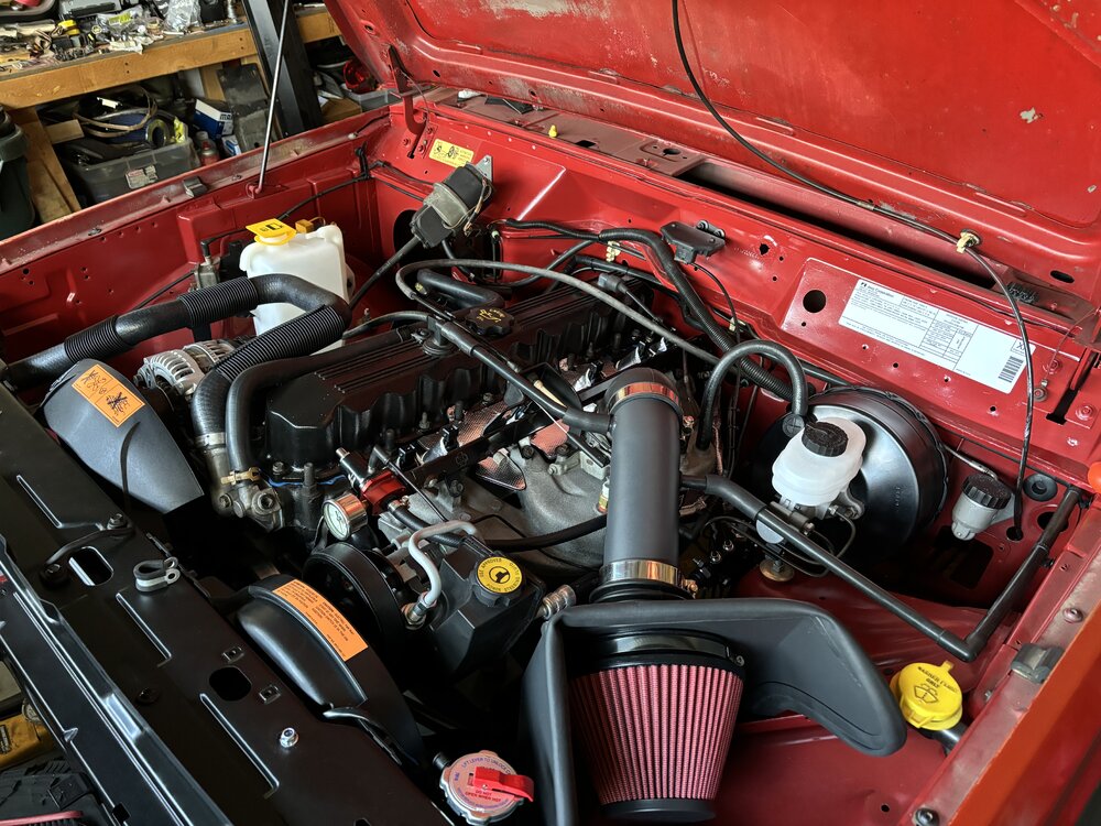

Little bit of work done on lunch break after working in Raleigh the last 2 days. I made the extension for the IAT sensor and got it tucked in the way I want it. Also tidied up the passenger side end of the Engine Control Harness.

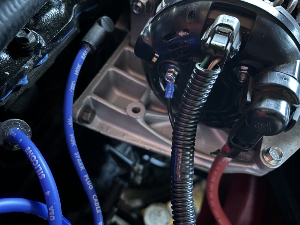

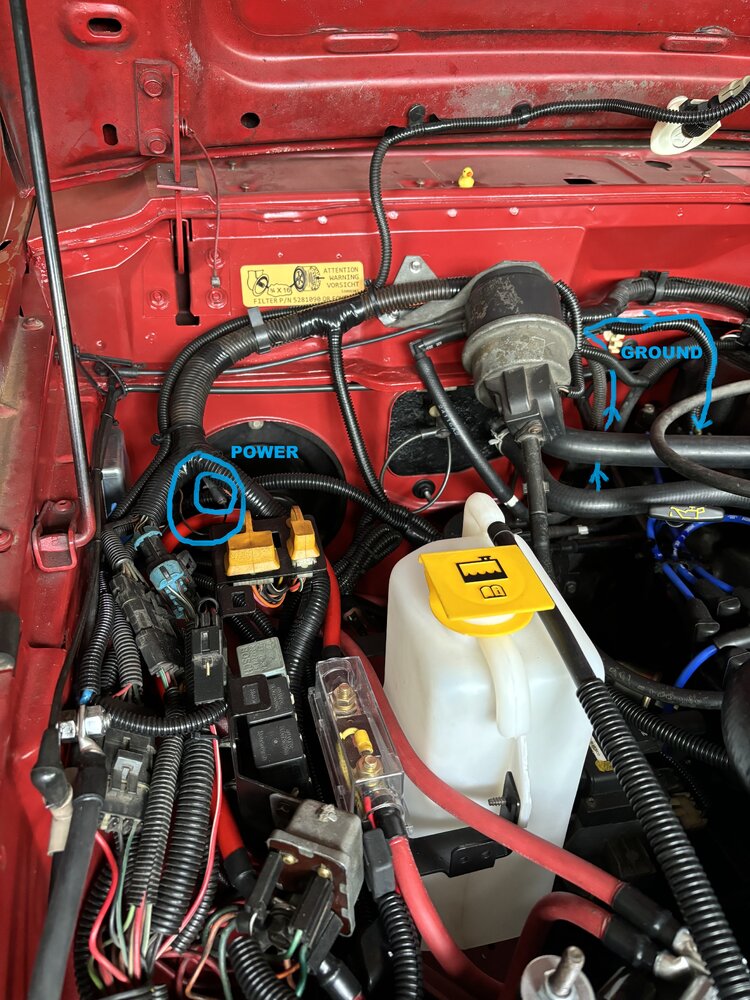

System wiring under the hood nearing completion. Alternator and external regulator wired. Big ground point added in RH fender panel. Tied into original alternator's yellow wire for switched 12V for the regulator, then zip tied and tucked the original alt connector.

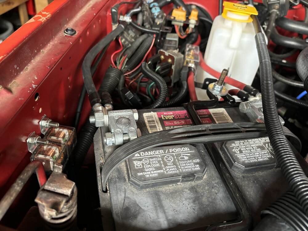

Power distribution about buttoned up. 200A alternator fuse (160A alt). Mockup battery is from 2016 according to the sticker on it lol. Good core for when I'm ready. The starter relay is backwards and upside down for fitment.

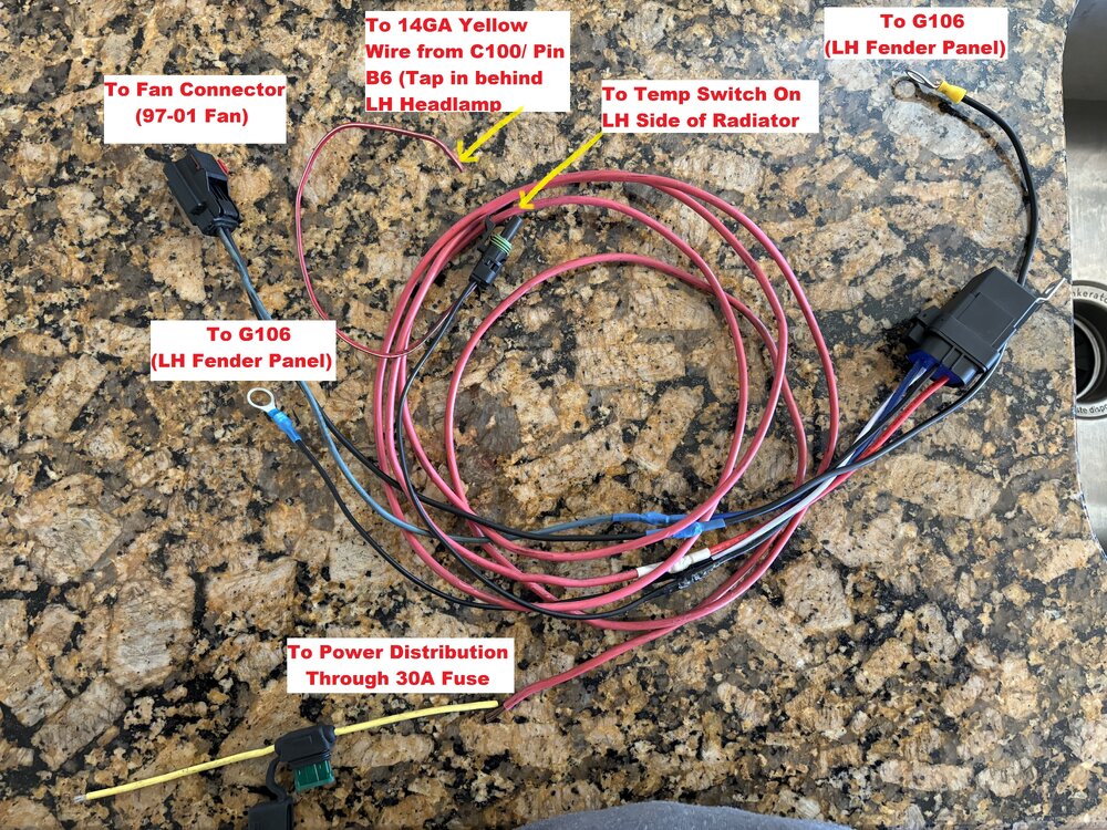

Minor update- I got the fan relay arrangement buttoned up and loomed, ballast resistor hung. I still need to terminate the power connection for the fan motor, I'm out of zip ties long enough to piggyback on the engine harness crossover under the chin.

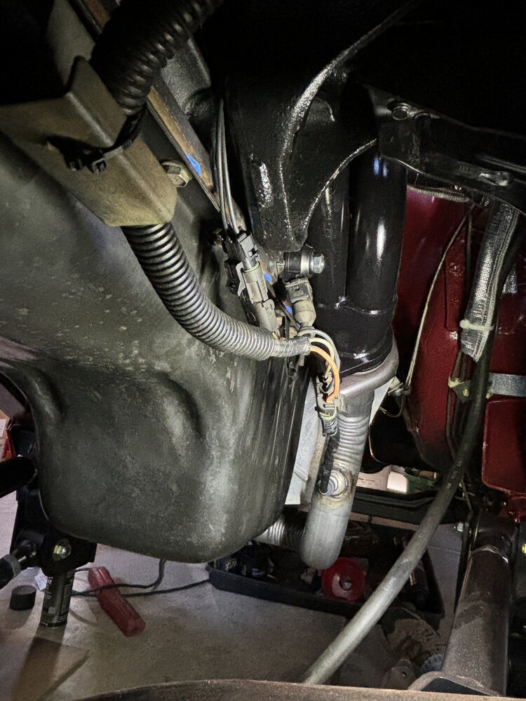

Transfer case yoke swapped, front shaft is in. Part Time light switch wires routed along the driver's side and then crosses over top of the trans and joins the wire pack for the reverse light switch, up to the main body of the engine control harness.

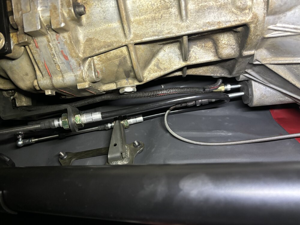

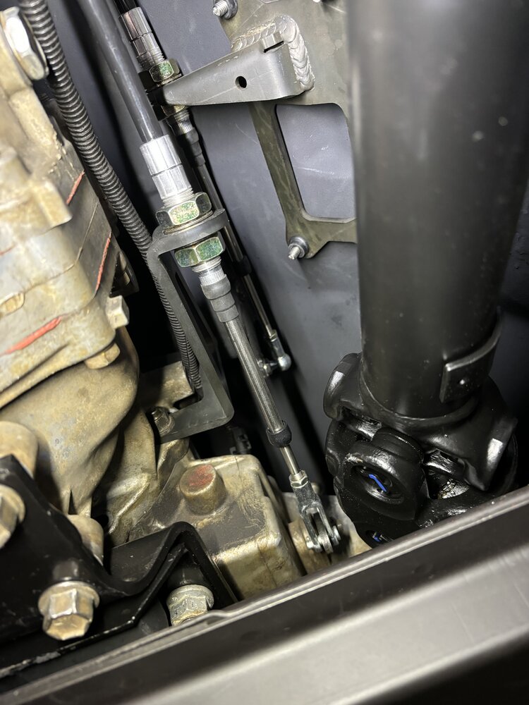

Novak cable shifter is in, works great. I did have to re-shape 2 of the ears on the tunnel side bracket to fit flush:

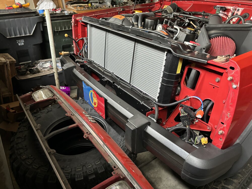

Front bumper is on, fender flares have new backing brackets.
Part Time light wires tucked inside the engine control harness. Ground side I just added to the ECH ground pack at the passenger side of the engine. Power side is from the original C300. I'm using a later 2-pin switch from a spare 98 t-case.

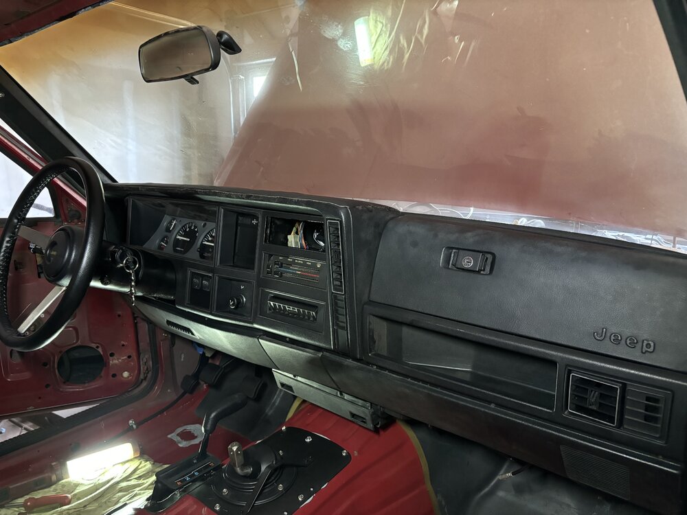

Dash is really roached. I glued up a number of semi-structural cracks. I'll be looking for a replacement as time goes on, pulling one of these is cake compared to most other cars I've done. Meanwhile, the deep and I mean deep cracks in the pad I just flattened, filled with cotton and taped over with HVAC foil tape. Then glued a piece of marine vinyl over it for now. Meh. Bothers me that it's a detail I can't get like I want it right now, but I'm starting to get in a hurry to just get on with it and drive it by Memorial Day.

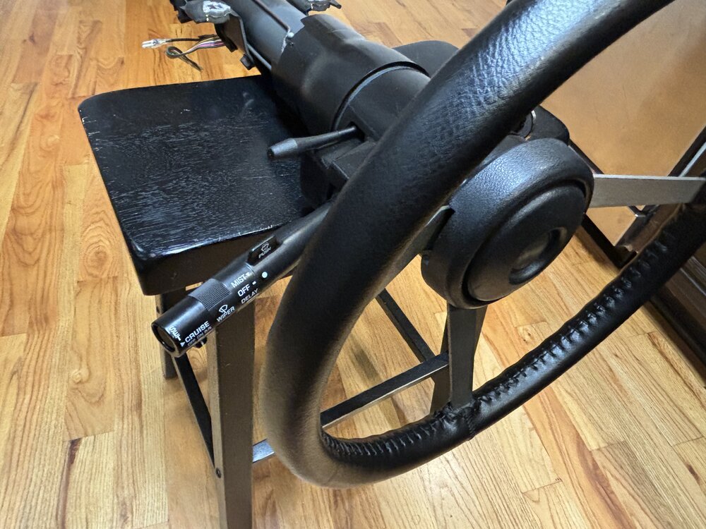

I took apart the column for one more good go-through and painted the bowl assembly plastics black. No more gray. Except that wheel...
I really thought I'd take the wheel to a local interiors and tops shop in Raleigh to have it wrapped. Meantime, I wondered how hard it would be to do with a DIY leatherette kit from Autozone. Video on YouTube of a guy doing a YJ wheel identical to this one convinced me to give it a try for $15 on Amazon. I was surprised that it's actually real leather. Anyone wants to try it, the kit size for the 3-spoke wheels is M2.
Fully dressed column glamour shots lol:
Dash and everything in it/ behind it is situated and secured. All the cruise components are fitted. Headlight sentinel and intermittent wiper module are installed. Also added footwell lamps. Next, I'm working my way back from C118 and C157 at the instrument panel harness, door speaker, dome lamps and cargo light. My truck has zero power options so no crossbody or actual door harnesses to deal with.
