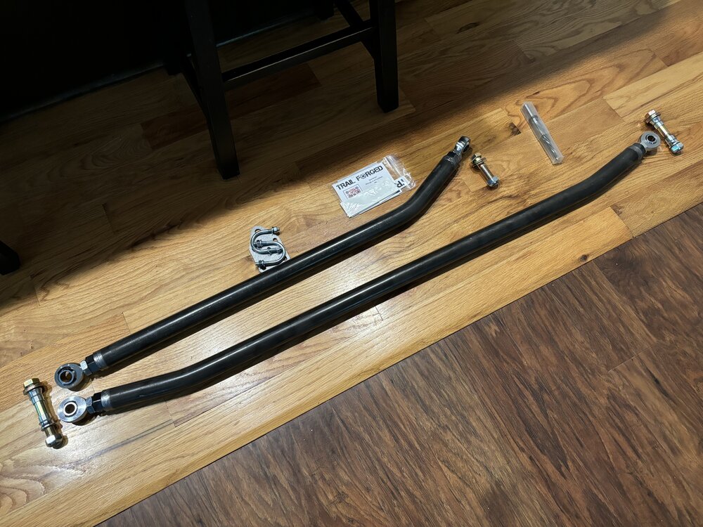

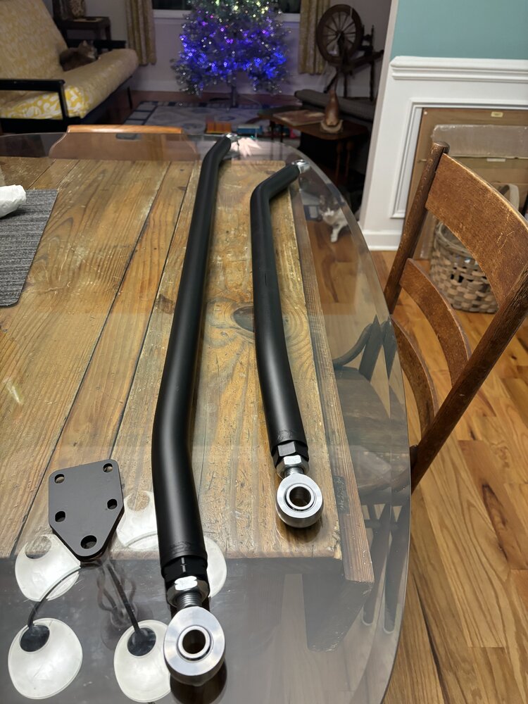

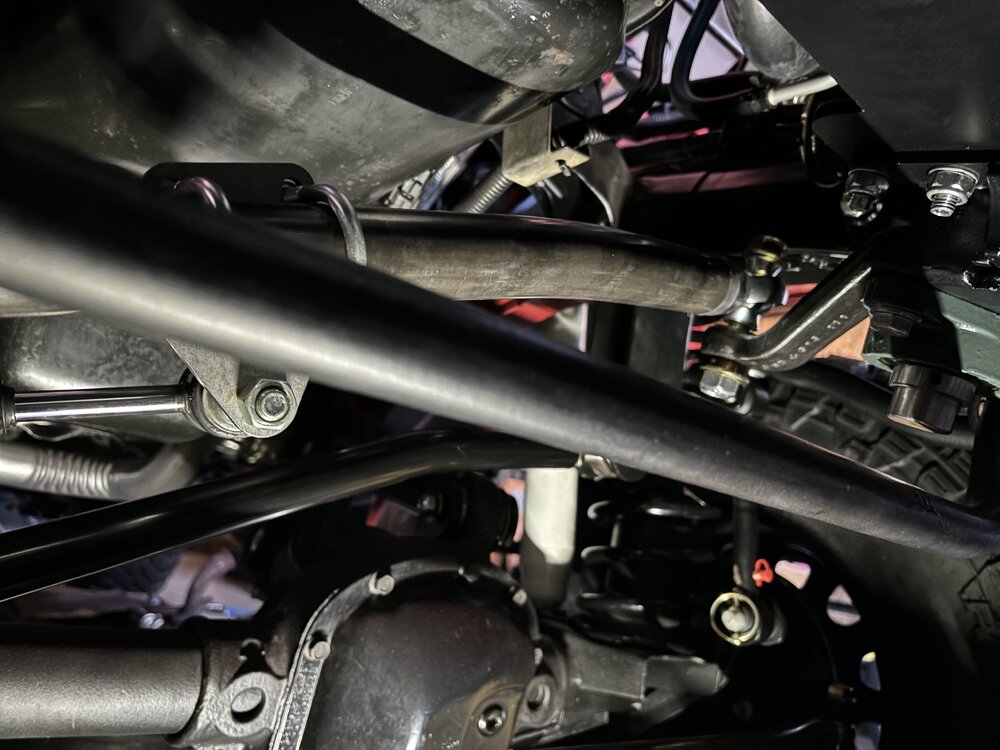

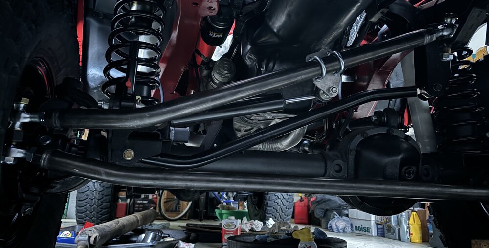

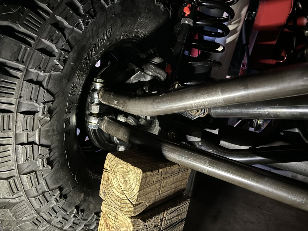

This was worth the wait. I was thinking that massaging the drag link's bends to gain steering clearance on the passenger side would be a solution. That works, but having to replicate that on a wear item on a big lift when a replacement is needed wasn't an attractive option, long term. This build has required a few things one would call a 'big ticket item' but aside from new tail lights from Key Parts (coming early November) and at some point a Dana 489 from ECGS, this is probably the last.
OMG this Trail Forged setup is BEEF. Steering clearance issue is solved. Their instruction setup pics have the steering damper on the tie rod with a factory track bar (?!). My TB interferes so I have it on the drag link instead. Mocked up with lengths set within a degree or two on the toe, nothing tightened up yet. I ordered mine bare steel for DE1634 coat instead of their powder coat (black not availalble). Next is to pull and paint and reinstall and check toe again and adjust as needed to get close enough to drive it to the alignment shop. Did some computer work on a friend of a friend's Hunter alignment machine so I'm invited for an "as much time as you need" alignment. :)
Long time, no update. I'm stuck waiting for a different drag link from Trail Forged (long story, we'll see how it ends - Update 11-14-25: it'll be here probably tomorrow, 11-15-25).

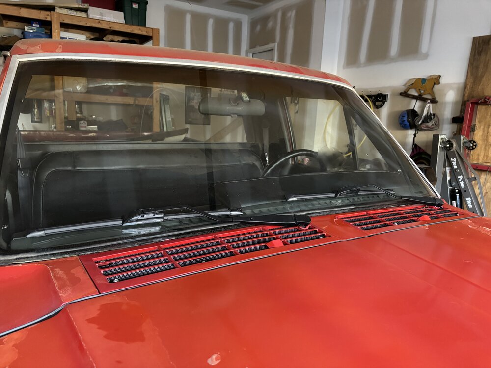

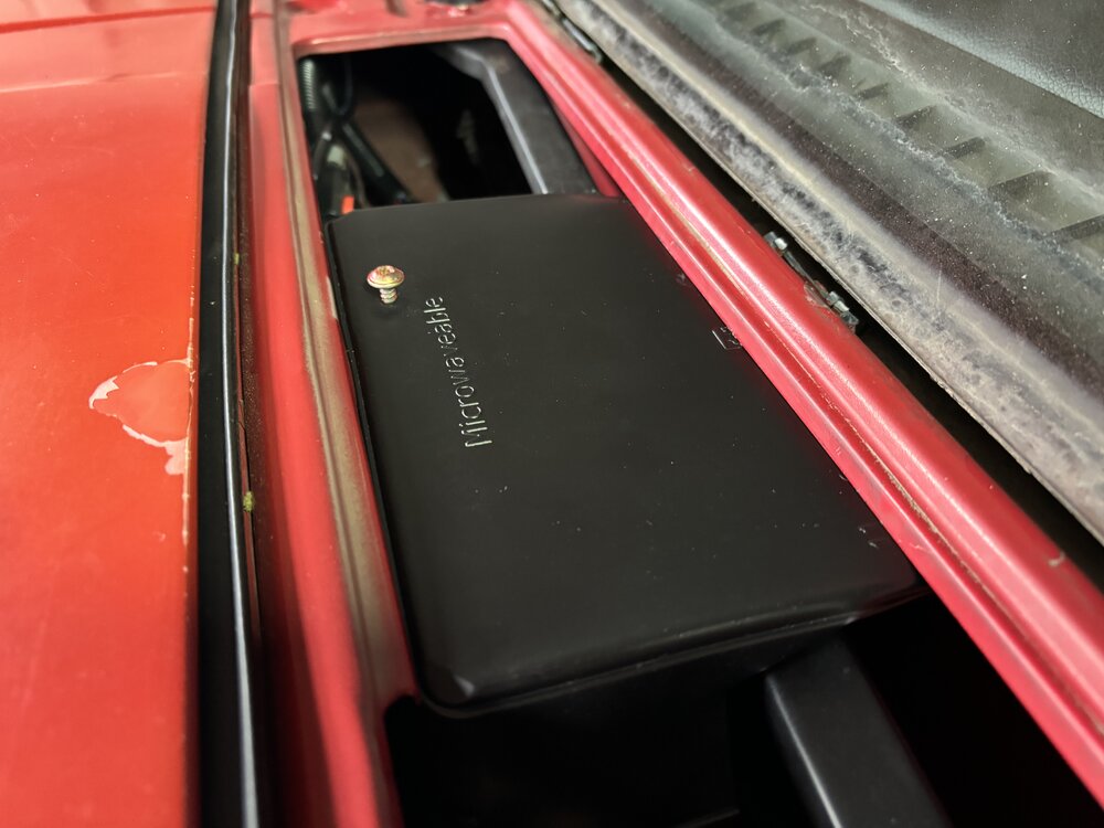

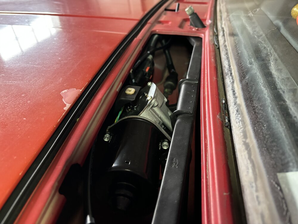

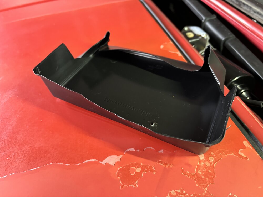

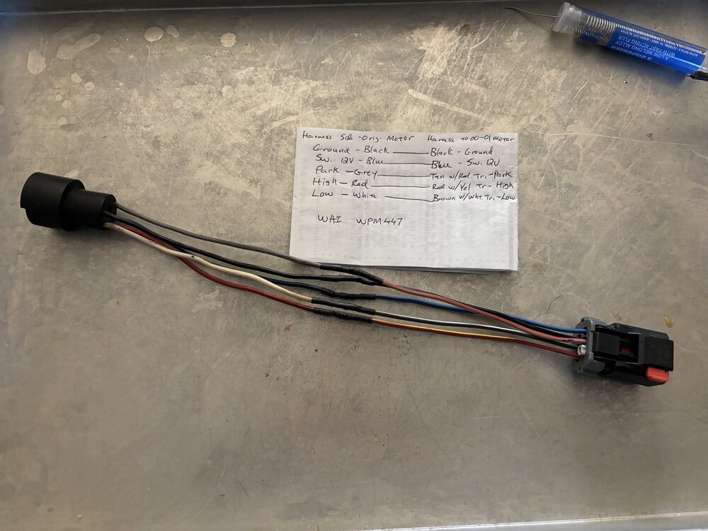

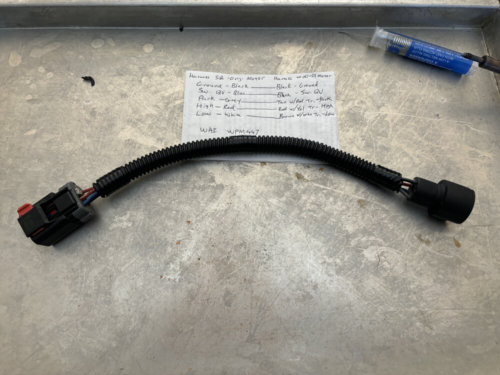

I went to the trouble of cleaning out, re-greasing and sealing the original wiper motor maybe 2 years ago. I jumpered it in high and low positions directly with a battery, and it's slow and noisy. Technically it works, but no sense using it and then replacing it soon out of frustration. I got the harness from a 2002 WJ- the colors are slightly different from some of the XJ examples posted elsewhere here but no big deal. The WAI WPM447 has the connector and is $4 cheaper than the WPM438 with no connector. So I built an adapter to keep the harness side uncut and connect to the newer motor.
It's about a foot long, more than needed, but again, no big deal hiding inside the wiper cowl.
Finished up the wipers on Saturday. The harness adapter works with no issues. I was wondering what I was going to do about not having the rubber jacket around the motor and I had a thought pretty far outside the box. That's a microwaveable meal tray trimmed for flexibility and fitment is more than acceptable lol. I spent parts of 2 days getting all the scale and peeling clear coat off the cowl cover with a .002" feeler gauge and soft brass brush. Then wet sanded the lines between base and old clear. Next, some dish soap and 1200 grit on the areas of base that had been exposed to remove oxidation. I also touched up a few spots with a very small brush - sprayed Rustoleum Colonial Red in the cap and dipped the brush in it. Finally, I cleared the whole thing with Upol/ Raptor diamond coat 1k. I'm impressed with it, dries very hard and very fast and has very decent UV protection. Maybe one day I'll fork out 8-10k for a real paint job but in the meantime I'm just trying to keep it red and protected from peel and rust.
New later arms...

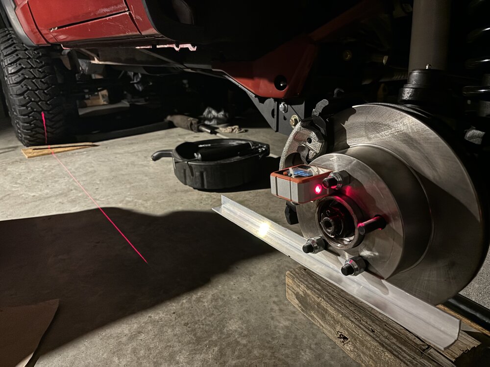

Homebrew toe setup - flip some spare 1/2" - 20 lug nuts around to hold the toe measurement bars with the rotors snug. Angle aluminum tends to be more true than steel angle iron and it's lighter. Frequently check they're level when making adjustments and re-measuring. Shoot for 1/16" less up front for about .5* toe-in. I used a laser angle finder and started with the beam at centerline of the rear tires and moved each side outward equally until I got the measurement I wanted. Then measured center to center on the knuckles and transferred that to the tie rod. Close enough to get it to my buddy's alignment shop.

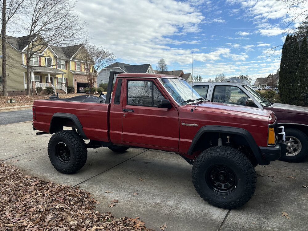

I just drove it for the first time ever, around my neighborhood. Running and driving is silky smooth. It's still a ways away from finished. Bugs to work out - the temp and oil pressure gauges are pegged. Oil pressure gauge sweeps at key on, temp does not, both gauges worked fine some months back when I was tuning and making engine running adjustments. No big. Right fender liner still needs to go in, lots of clear coat correction and repair, little things. No tool exists to measure the width of my smile today...
It's been a while, 2 jobs and life stuff taking most of my time. A couple weeks ago, I tackled the pulsing lights at idle issue with the Durango alternator/ external regulator issue. This past weekend, I got the fire extinguisher mounted under the passenger seat, using existing holes in the front bracket. I'm satisfied with it, easy to remove for vacuuming and reminds you to check the date when you do... Made by Shield, right here in Kings Mountain, NC.

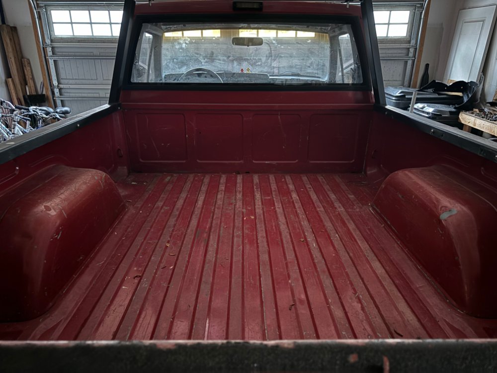

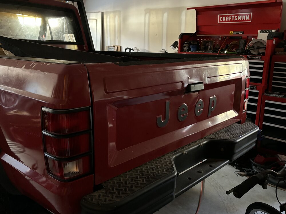

The bed hasn't been empty since I started pulling it apart back in April of 2022. Feels good. There are 3 small dents in the rear wheelhousings I'm going to work out soon. I have a lot of odds and ends for sale locally on CL. I'll post in our classifieds as well. Looking to offload most of it free or cheap(er) than on CL, somebody can use it hopefully.
It now has a temporary tag and is legal to operate on NC roads. I want to iron out the clutch master to 100% confidence vs warm restarts/ difficulty getting into 1st and reverse, and I need to tweak the toe adjustment. I found my custom fasteners for the passenger fender liner right after I ordered more. It hasn't been over 40MPH yet and lots of stuff needs to be tested/ verified at higher speeds:

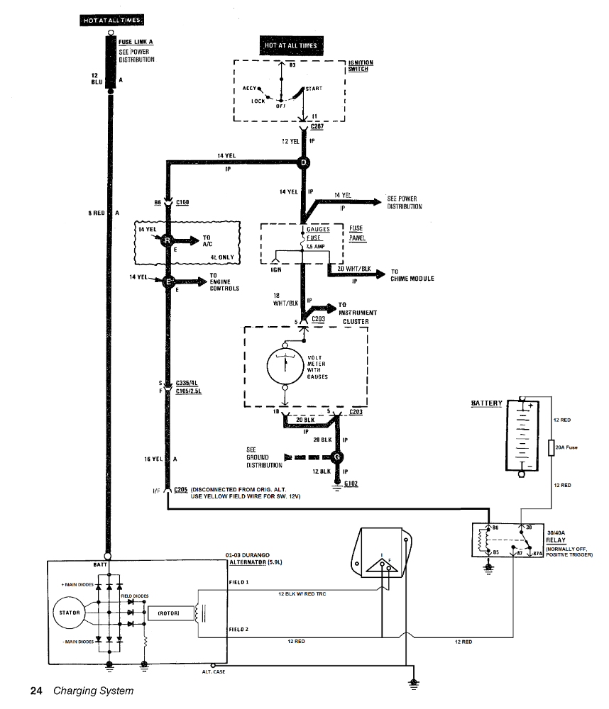

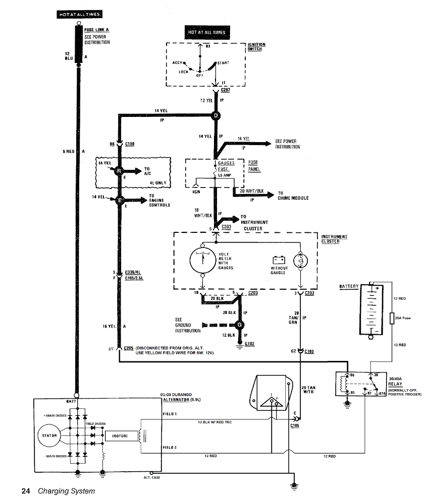

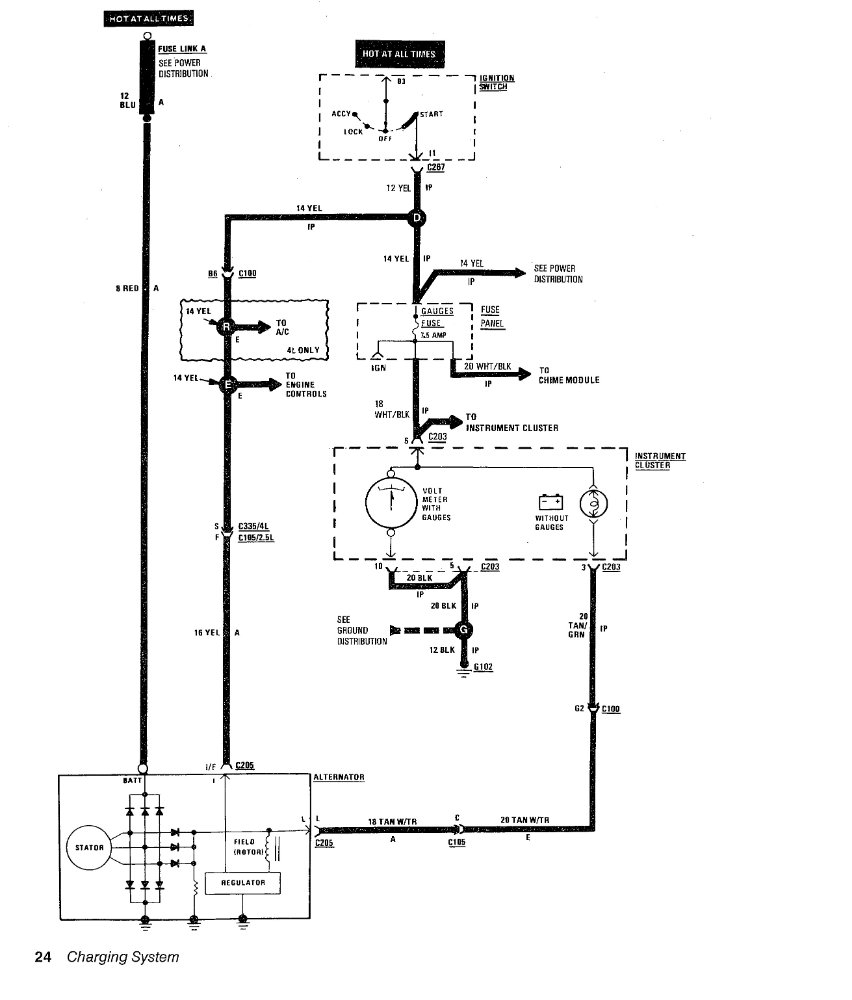

Larger Images of Electrical Diagrams here: ---> Durango Alt Wiring
Electrical:
Going from this (p.24 1988 Comanche Electrical Manual):
To this:

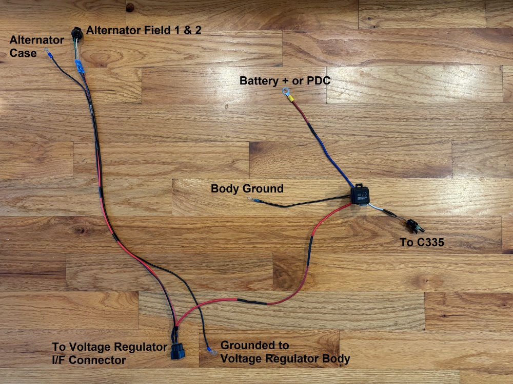

Complete regulator and relay harness:
Harness Explanation:
All lights pulsing at idle - common issue when doing this swap! The yellow field wire on the original Renix alternator connector is usually the indicated switched 12V source. However, it comes all the way from the ignition switch, through Splice D, through bulkhead C100, through Splice R if you have A/C, through Splice E, through connector C335, and finally to C205 at the alternator. This is a run of about 10-11 feet! Plenty of noise and voltage drop opportunities. Nick R (NickInTimeFilms) and a buddy of his did this swap in a YouTube video:
The 89 XJ in the video already has the 91-98 A/C compressor bracket due to a previous HO-era A/C swap, and they're ditching that in the video, but that's not the point. The wiring is (11:24 - 18:12). In the comments someone asked if the lights pulsed at idle, and the owner, tylermus, replied that he'd added a relay next to the battery to eliminate the issue. So that's why I did this, and it worked great.
There also needs to be a ground wire from the regulator body to body ground. I added a large ground on the passenger side to mirror the one on the driver's side fender well (G106), so I tied into that. The 20A fuse between the relay and battery is optional, I did without.
I unplugged C335 and tucked away the side for the alternator harness. Rather than cut anything, I headed to the local boneyard looking for 88-94 Chevy TBI V8 trucks. It's the brown wire connector you unplug when setting the distributor base timing on those trucks. On the firewall under the PDC cover if the truck still has it. I got the Field wire 1&2 connector from a random Jeep/ Chrysler vehicle a while back, don't recall exactly which (easy to find).
External Regulator kit is from Alternator Man / alternatorparts.com, kit ERCK. Setup and explanation video from the Alternator Man himself here:

whats the plan for bed? I have extra plastic bed liner insert if you want to go that direction
Wow, I didn't even know such a thing existed anymore. I had strongly considered having it spray lined. I'm paranoid about putting in anything that hides or traps moisture and dirt, but it's super tempting because it guards against scratches and dents. PM me with what you had in mind on price. A lot to think about now...
FREE
Ok, wow, yeah! That's very generous! I'll have to haul it back here on a Harbor Freight trailer behind my Accord. The MJ hasn't been shaken down properly yet and I'd hate to get myself stuck in Raleigh if something dumb failed...
Reality check - I have a 6' box. Is for a 6' or 7'?
ill verify when home tonight but pretty sure it is the size you need
6' bed

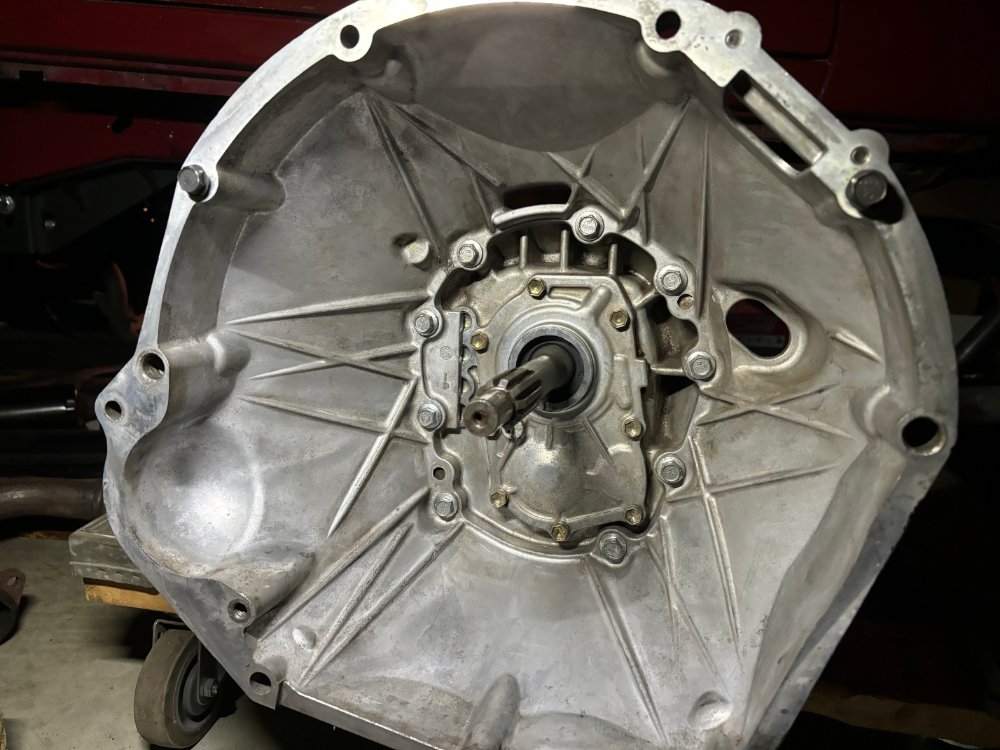

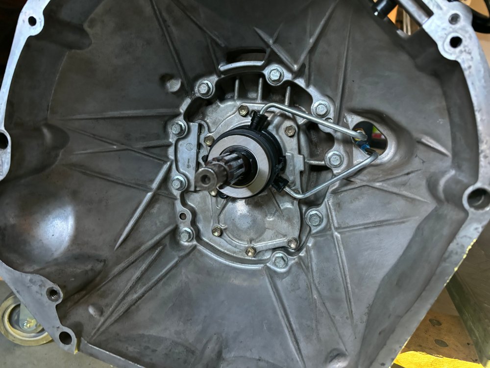

I was just changing out the transfer case front output yoke seal (thought I'd done it but nope) and noticed something just peeking out at the trans inspection cover/ spacer.
If you know what this is, you know how I'm feeling right now. I've had it with internal slave. Advance Adapters conversion kit ordered today.
After swapping the clutch master with a LuK LM206 shifting into 1st and reverse when warm was a lot better, briefly. Slightly cockeyed slave engagement took that away. At least I know what happened...

Yep, good call. It'll be 110% less worry with external. I did a complete clutch & hydraulics replacement on a 2000 Dakota 4.7/NV3500 for an injured neighbor about a month ago, just like you said. Easy peasy. Almost the exact same job, really.

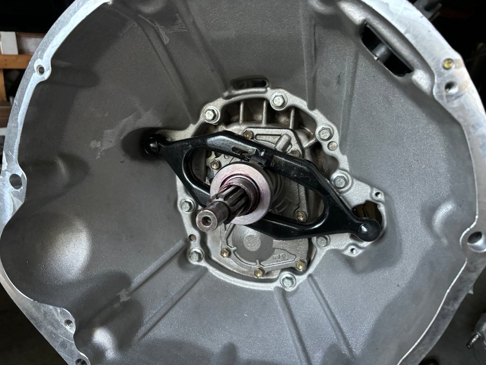

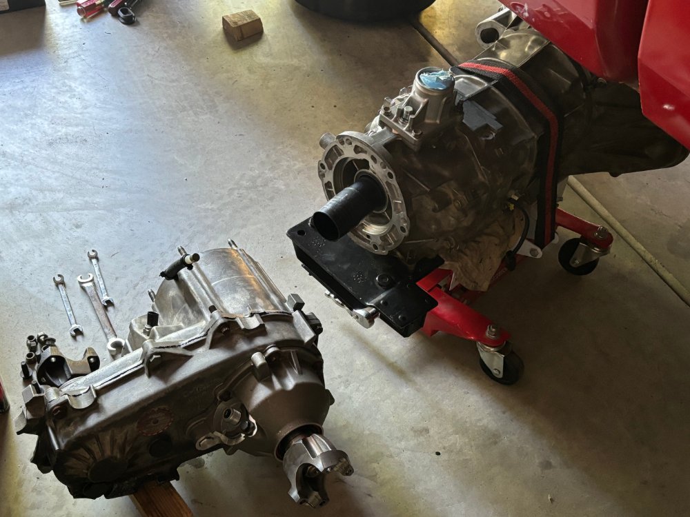

External slave parts showed up Thursday, got a late start yesterday. I ran out of time to reinstall the shafts and bleed it but trans and TC are back in. With a 6" lift, I can roll the trans right out from under on a trans jack. I borrowed this one from a neighbor. He got it at Harbor Freight (Pittsburgh brand scissor style with a strap).
Old:
New:
Important detail for anyone doing this swap - the input shaft cover bolts do need a thread sealer. I've used Permatex 59235 for years on head bolts in water jackets and for stuff like this. Remember to knead the tube really well each time before use! Most parts house stores are only going to have the small tubes (.3 oz) and you'll have to order the big one.
