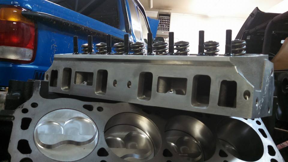

IF you build the 5.0 Id pass on the estreet heads and looks at a set of TF TWs

Like this? :D
Is that headed to the Ranger?
All jokes aside them are some flowing beotches for an off the shelf head.
