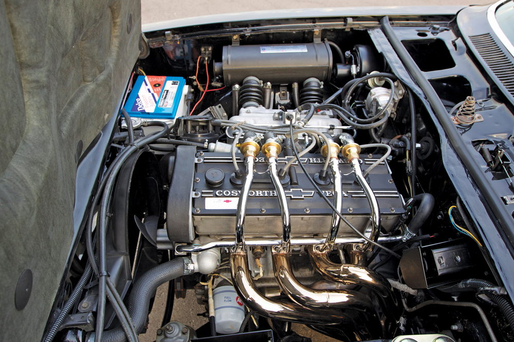

Cosworth Vega motor...uber cool and somewhat vintage...
