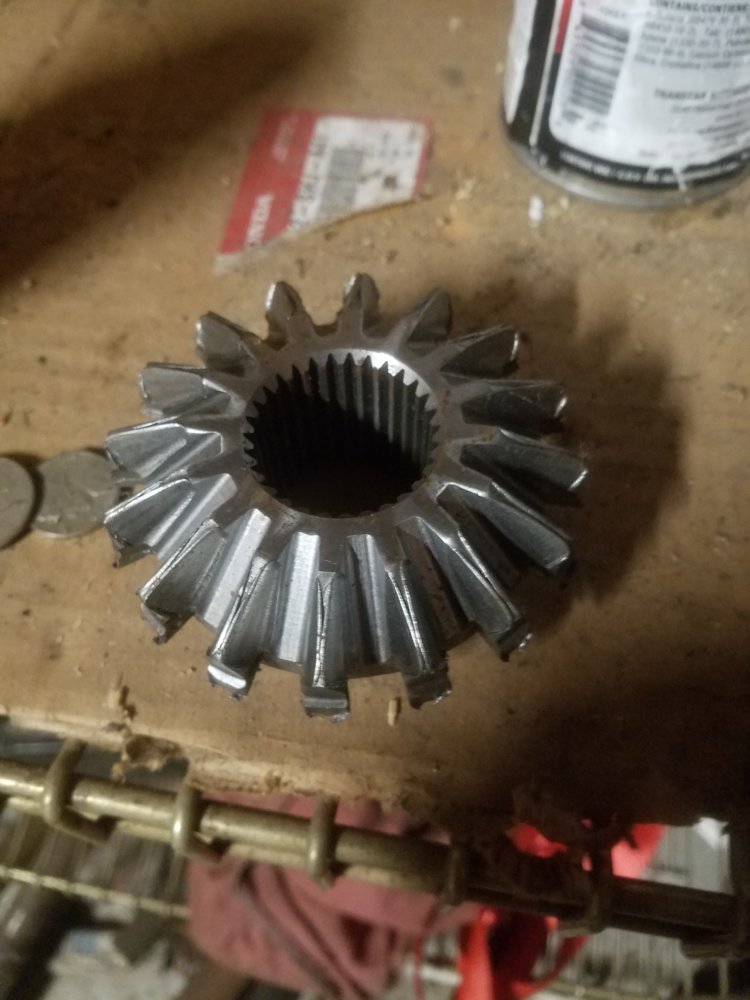

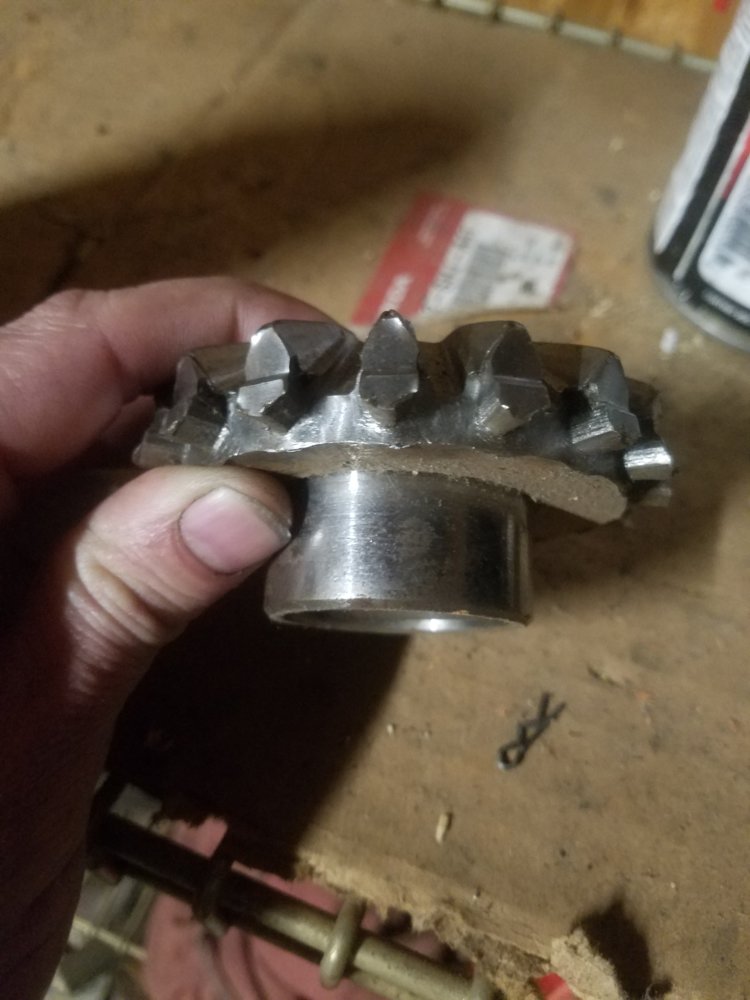

I used to have a cable version on a d44 frt. I was always having problems. Could have just been me. I finally destroyed the locking side gear at callante back in like 09-10 (yes, I used to actually wheel). Thats when I ditched the 8 lug 44 and went 60. Another thing to consider is the actuator will be a tight fit on a dsd axle and a rock target on anything.
I think I still have the side gear. Ill snap some pics tonight
