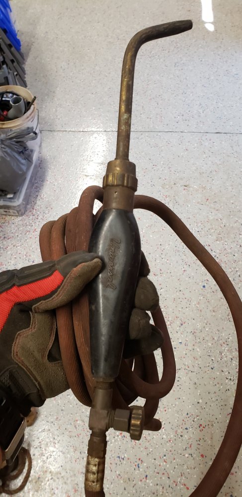

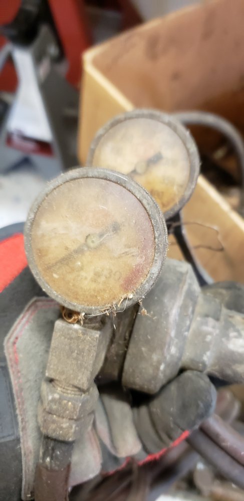

I do have my Grandads(?) ancient Victor 100(?) torch handle (looks like a toy). Unfortunately, the cutting head is gone (only a very sickly brazing tip), the hose is cracked, and regulators covered in grinder dust (the way I received them). Would be happy to use it, but would be leery without getting it (regulators) professionally checked out/rebuilt... not sure it's worth the hassle?? Whether I'd rent or purchase bottles is up in the air too...

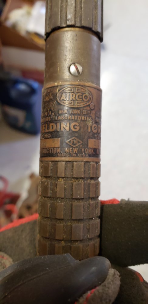

Well FFS! While its been a LONG time since I put eyes on it, turns out it isn't a Victor, but an even older (lighter duty) Airco 700 handle...
I guess we'll mark it down to old age/worsening eyes? :flipoff2:
Put your feelers out on eBay to see what that one you got is worth to collectors. Or better yet, use it. If it's worth an insane amount of money to a collector, sell it and buy brand new stuff.
Cut my teeth welding on Airco stuff. I dig Airco anything "if" it works. Torches are kinda cool to hang up,on your into that stuff. If you still have the regulators I get they are stiff and brittle. I wouldn't trust them.
Regulators are "crusty" at best... and while it appears rebuild parts are available, would likely run more $$ than new and be questionable?

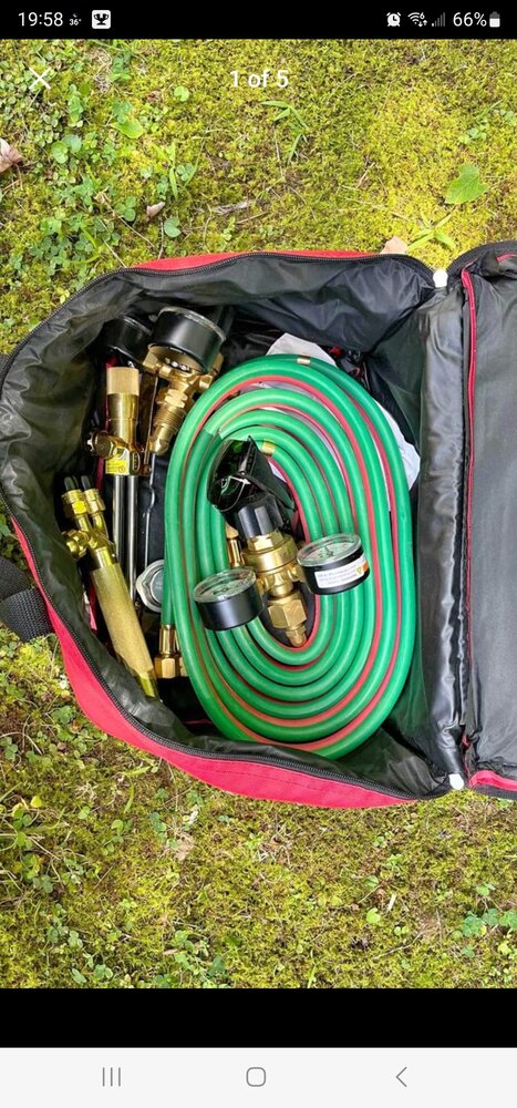

Well, after only 2.5 years :flipoff2:scored a BNIB Harris med. duty set in a Lincoln bag for 1/2 what they sell for now... guessing it was just after they were acquired?
Anyways, will ring up the Harris tech line next week for oxy-propane cutting tip & rosebud recommendations... then lease an O2 bottle locally, and built a cart. Can finally make some headway on sharpening/repairs on my "antique" bushhog!
