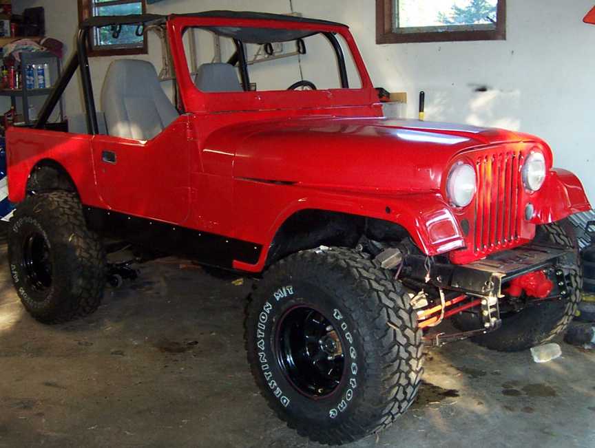

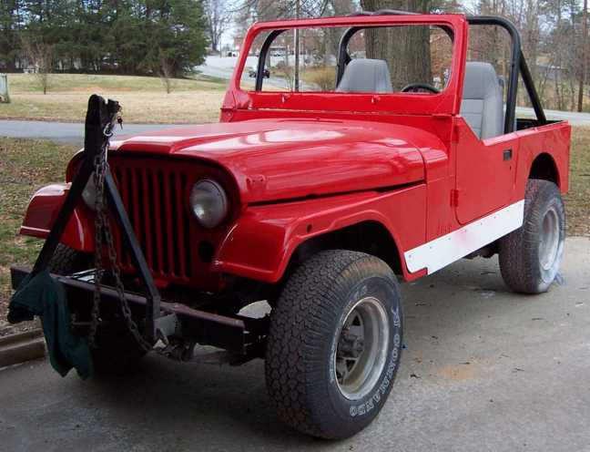

Anything you don't strip entirely down to metal will bubble and flake. That latex screwed your whole world up as far as another finish. Prep is everything. See that first pic of my CJ? That was after I towed it back from the sandblaster. Yep..to the steel!

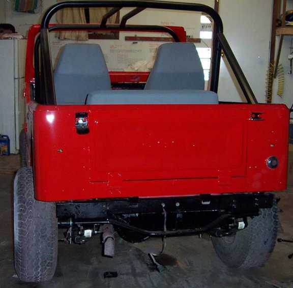

I've painted quite a bit. I'm no painter!!! But I have a buddy who is one of the best motorcycle and custom painters I've ever seen. He's rubbed off on me enough to know that prep and sanding are everything. Hell with the CJ I sanded, prepped and taped for 3 weeks (evenings and weekends) before I shot the paint. It took me all of about 3 hours to shoot the paint......but the prep :rolleyes:

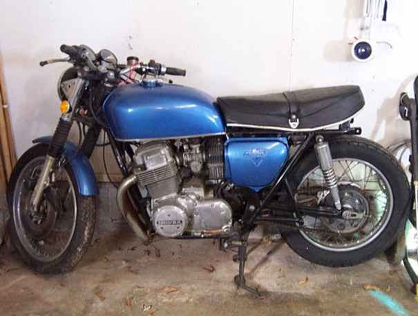

Here's my old CB750FOUR I brought back to life
