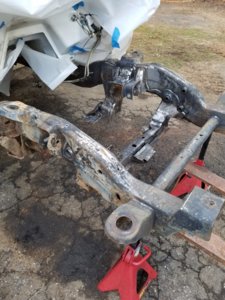

Well, a mini restoration turned into a full blown frame off this weekend so I'm now looking into having the entire frame painted proffesional. Still not done with blasting.....:kaioken:
20170307_223208-jpg.243223

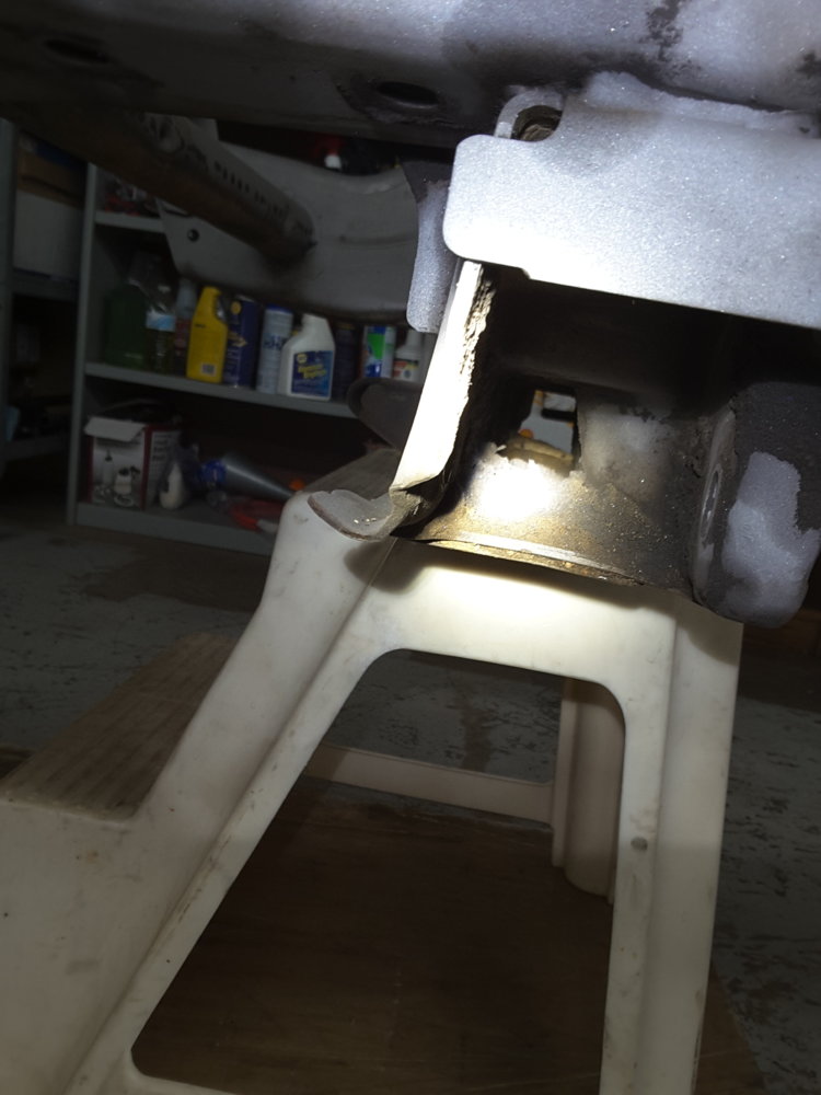

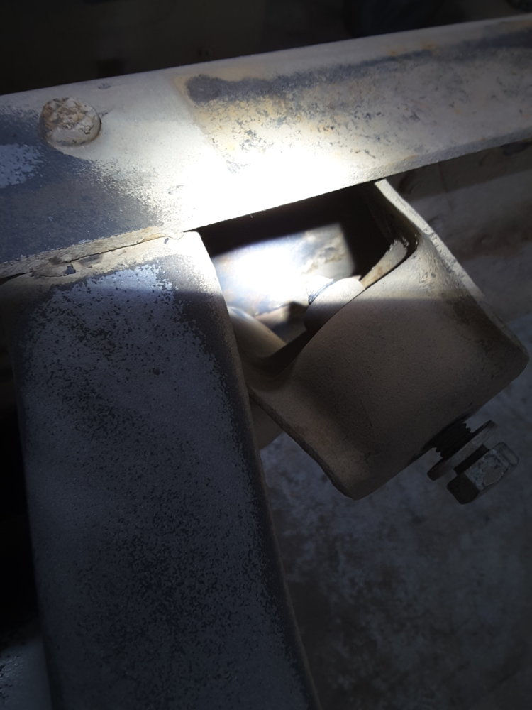

I don't have the space to paint all of it correctly and the weather won't cooperate for at least a month or 2. Does anyone have a shop recommendation? Google came up with Holbert Trailers
Paint & Body Repair – Charlotte NC Truck Repair, TrailerRepair, Truck Sales, Trailer Sales

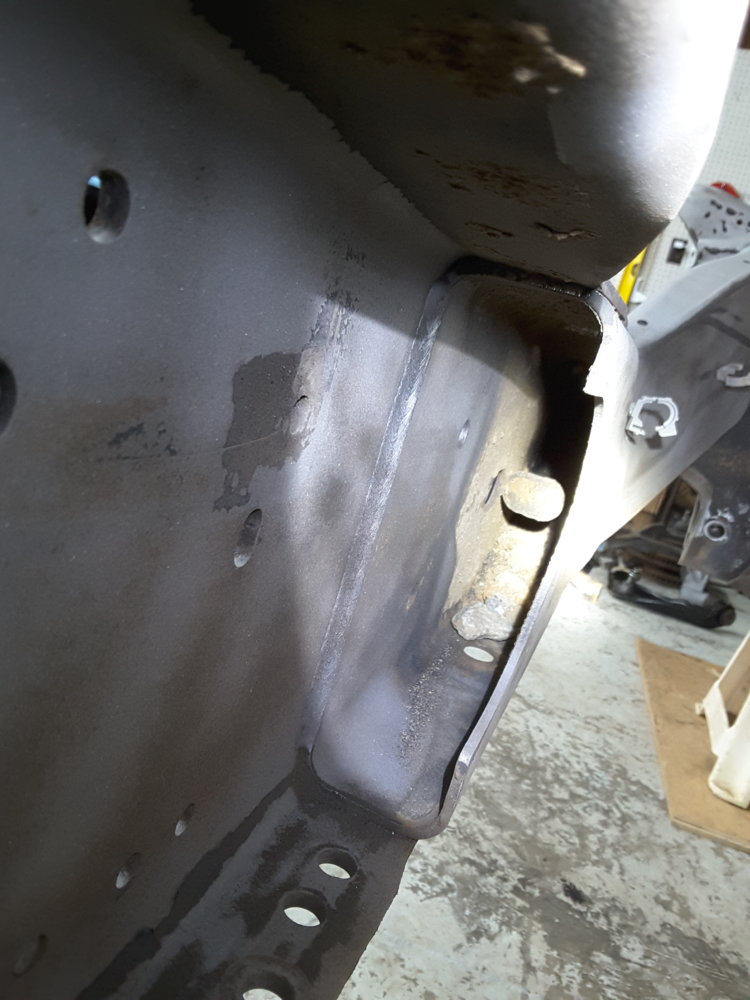

Also any ideas on how to get in the nooks and crannies and inside the front frame horns better?
20170307_223252-jpg.243225
20170307_223321-jpg.243226
20170307_223333-jpg.243227

I say clean the metal really well, weather thats blasting or acid. Make sure there are no residue left. Epoxy/etching primer. Epoxy paint. Make sure the paint & primer are compatible.
I've seen way to many solvent pops in paint from cheap/incompatible primer
The more I research the more I'm shying away from acid. I think the best bet for the frame is sand blast and epoxy primer then rustoleum pro spray can as mentioned.

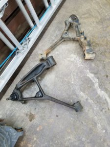

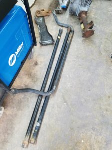

Any insight on suspension parts? Powder coating vs just painting it like the frame..

How does powder coating hold up compared to painting?
Very well, much better than paint in fact. The problem is that if/when the frame gets chipped or otherwise damaged, it's a lot harder to touchup or recoat powdercoat than paint. It's also very difficult to remove for welding, etc. If neither of those things are functionally a problem, then I would powdercoat for durability. Would I do it on anything that goes offroad? No. Street vehicles? Yes.
Powdercoat is great for suspension parts, because they're a lot easier to remove and handle than a full frame, so the damage or repair/welding issues are much more manageable. You can remove the powdercoat, or swap in another suspension part if needed.

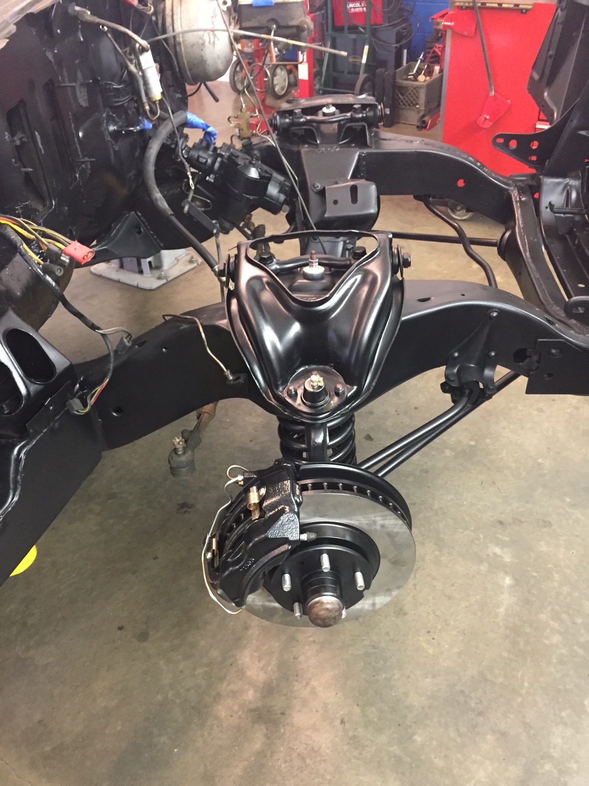

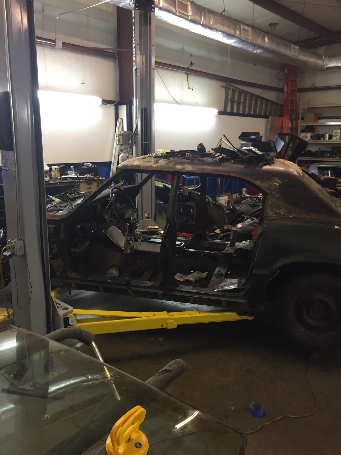

PPG shopline jp series epoxy. It's a two part you mix then shoot. You can get it in black or grey. It all depends on how crazy you wanna go with the budget. I restored a fiat 124 coupe last year for a customer (show car) we ceramic coated all the suspension parts. Stripped all the undercoating and POR 15ed and epoxy coated everything that wasn't ceramic coated. He's done well showing it. Did a cj5 last year and shot the Eastwood chassis paint with ceramic. It turned out well too. It was a 2k also. The Eastwood has a slight texture, it looks good but dirt will stick to it better.
So why did you ceramic coat the suspension parts? I understand making them shiny metallic or whatever, but using a high temp ceramic paint on suspension bits isn't doing much else...
Ceracoat same finish used on guns. Bet we had nearly 10k in labor on that thing. I sure was glad to see that project go. Seems like was looking at the bottom of that car for months.
Getting going on a 67 t bird 4 door now. Have the 428 back from the machine shop tomorrow hopefully I'll have it stripped down next week and ready to put the body on a cart.
Customer like what we did with the front suspension and frame, and said to go ahead and pull the body and do it all.
Lots of good info thanks guys, especially josh m. This is a 3500hd flatbed work truck I'm working on. It'll see a fair amount of time off road and in the mud. Think I got a game plan in mind, powder coat the small parts and do the rustoleum pro in a can. Probably gonna need half a case..
Customer wanted it. He wanted the best thing out there. Hell we even ceramic coated the axle.

Ah, that explains it. Cerakote should be pretty durable, yeah. An epoxy coating with ceramic particles in it (cerakote) should be just as durable as powdercoat, depending on prep and application thickness. Some of the best powdercoat chemistries are epoxy-based as well.
I was thinking you were using actual ceramic coatings for exhausts instead of a ceramic-filled polymer/epoxy.
We used the cerakote baked on ceramic coating, Carolina ceramic coating stuff. Its used on exhaust primarily. It's tough stuff. The Eastwood stuff is a 2k air cure with ceramic epoxy nano blah blah.
