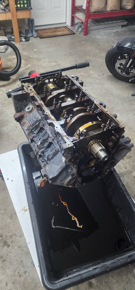

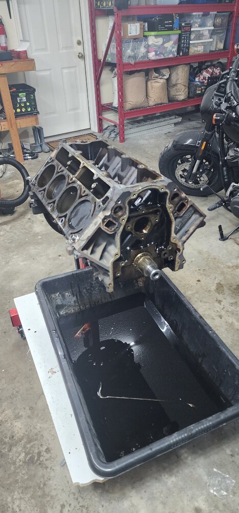

A productive evening with some beer and music. Pistons are pulled and rigged af lol. Crank is loose and ready to be pulled out on transport day to the machinist. Stock rings gapped. Have not decided if going to buy sterner rods or not.
Embrace the Sloppy Mechanics and run the stock stuff
Nah. This engine got hot. Wrist pins are seized. Oil ring is melded to the 2nd ring. I'm definitely not reusing the wrist pins, and the gen3 pistons are a roll of the dice. Tensile strength on the gen3 rods is so low that if I'm putting money into a new dish, f it, just do the bottom end right.

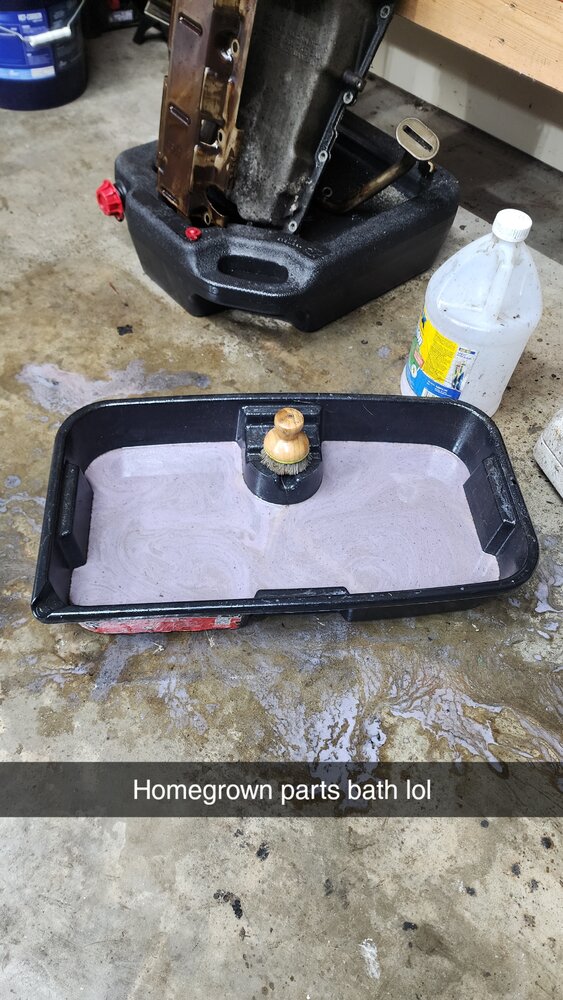

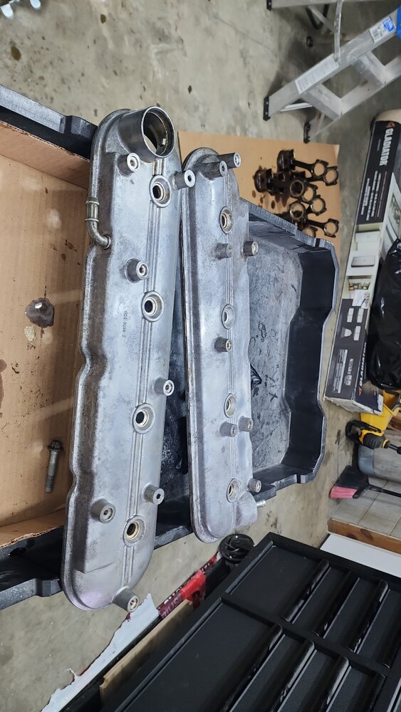

Put on some tunes. Cracked a brewsky. Lit up a spliff. And cleaned the valve covers, cam/crank covers, and windage tray.

If you've gotta replace them...I'd upgrade. Or just find another, good 4.8 and roll with that instead.
just gunna slap in OE gen 4 rods. probably slap some wiesco or cp carillo pistons on
zero aftermarket support for 4.8 rods. Zero. Every place says you have to upgrade the block to a 5.3 crank. Gayyyyyy
Every machine shop in the tri county area is booked out 6 months etc. So gotta start calling into TN and GA and hunt a Miller Lite Mater who will deck, hone, and toss in the bearings/crank/rods
