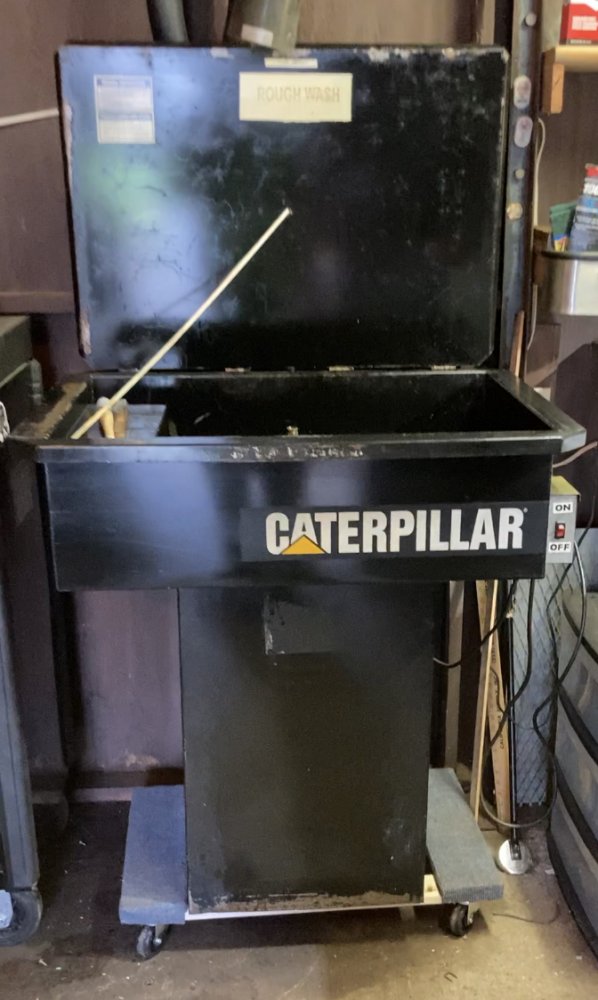

I bought this Build All std 32 gallon unit at auction this year. It uses a bag strainer before dirty fluid reenters the reservoir, big caterpillar fuel filter after the pump, sand filter ( removed ) and about 10 gallons of water at the bottom of the reservoir to sort the sludge to the bottom out of the level of the diesel fuel. When I bought it, there was milkshake clogging everything. It’s way overkill for what I fool with, but I’ve always wanted something better than carb cleaner and an air hose. If diesel has a higher flash point than kerosene, and the stank is about the same, why go with k1?
Never tried k1 in it. Bought my parts washer used with some old, nasty, stinking fluid in it. After I cleaned it out I tried the PSC-1000 after reading good reviews about it.
Seems Expensive! Is it that much better than K1?
I’ve never had the need to use anything else. It’s been some really good stuff and I know several that use it.
Edit: This is like comparing different types of anything, some people like this, some like that. It’s more about what you like and fits your budget. Only way to find out what you like is try it out.
