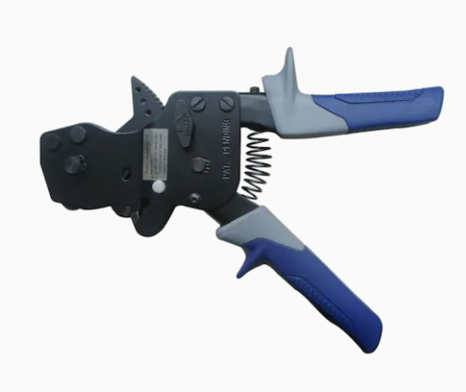

Watch this video -
I've plumbed two houses using the cinch clamp, most plumbers give me funny looks when they see it, but I haven't had a connection fail yet (knock on wood).
I have this tool and love it, because it has a light that comes on when you've got it right.
