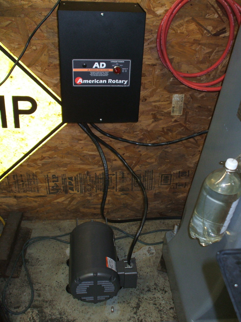

Ordering the American brand. Turns out it was already in my researched name brands. Hugely informative web sight easy to navigate. They have models they specifically recommend for load types and variances. A few CNC specific.

But since I don't I got this in and hooked up.
Could not be happier with this product. Web sight, salesman, shipping, packaging and product all top notch. Even the instructions were idiot proof and printed on some heavy duty shop proof stock.
And the reason why I'm currently happier than a pig in poo!

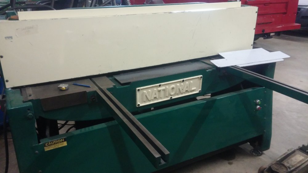

Found one I could afford, not too small, not too big. She weighs 6k and can slice 1/4 inch steel 6 feet long. I'm a happy camper.
Awesome! I've always wanted a shear, but everytime I start looking for a 4ft by 1/4", my aspirations creep up, and in my mind I somehow end up at needing 1/2" capacity, 12ft long, so it's too expensive and I drop the idea, haha.
Yea, I wanted 8 but the good Lord provided 6.

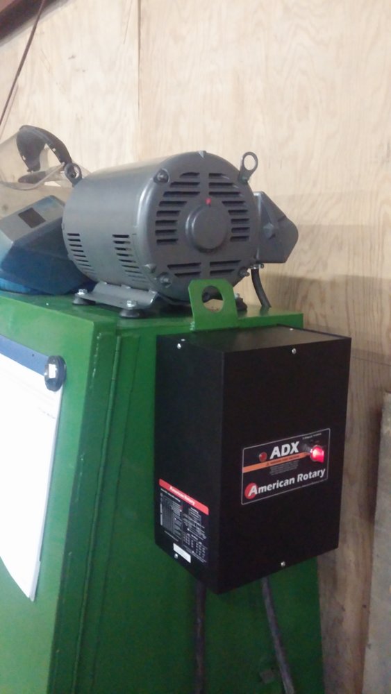

I'd be interested to see what your input amps are in comparison to the motor fla. Truly just curious. That is a clean looking install. I've installed I bunch on new services to give customers 3 phase but have never done a phase converter. Mainly bc we were looking at feeding 100amp equipment and the customer had money to burn.
Don't own a clamp on meter, but your more than welcome to check it out. The web sight has a bunch of good info and brags about very balanced output. The little black box is loaded, so to speak. It has all the capacitors, circuit board, and my breaker to protect the 3 phase load side.
