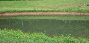

Upper/Road side of pond looking towards dam

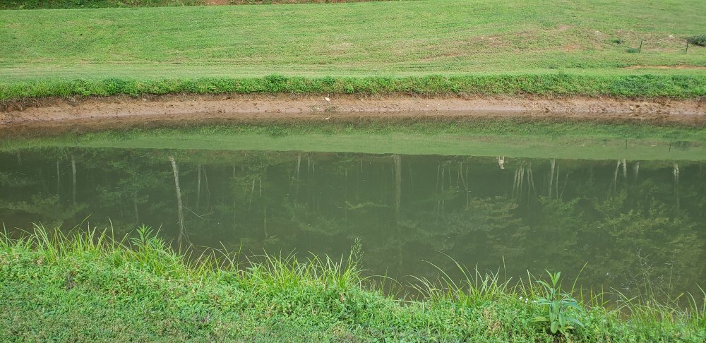

Lower/dam side from looking up to road

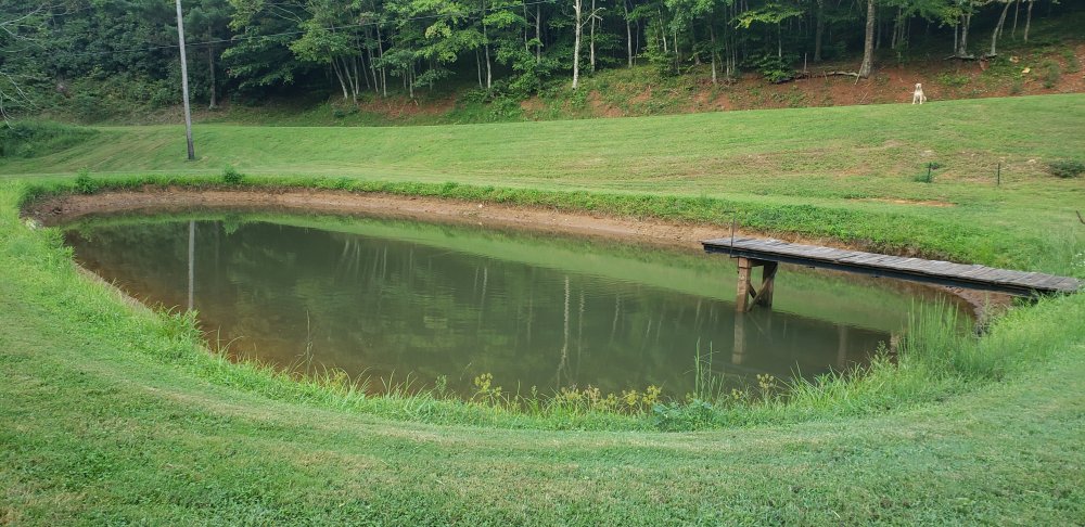

Dam side (from overflow) looking across to "hole" (under visible rock just down from high mark)

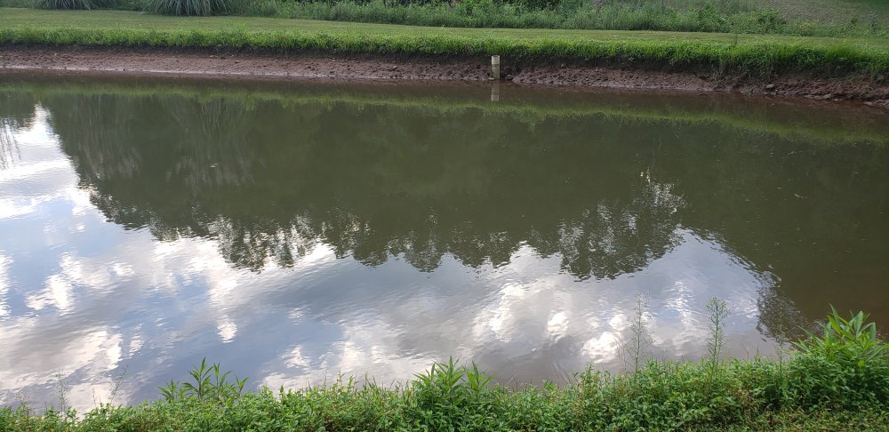

Road/hole side looking straight across to overflow
