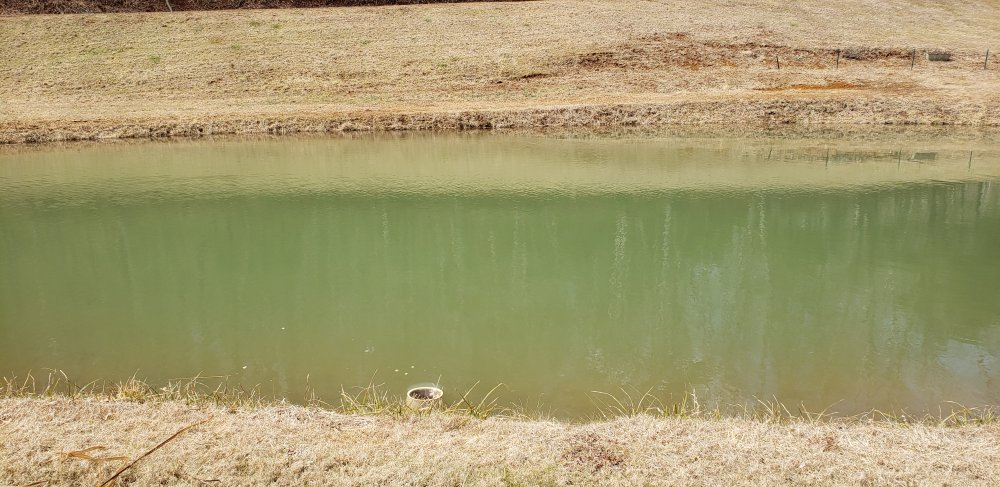

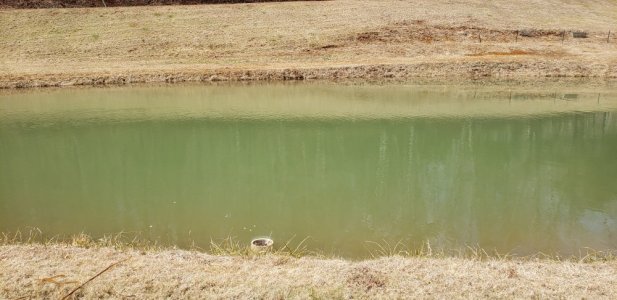

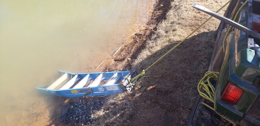

Despite thinking I should wait for warmer weather... armed with 50# of TR30 pelletized bentonite and some tools, decided yesterday was the day. Used the bar to clear the vertical passage at bottom (trending to horizontal), poured in the pellets, tamped it a bit, and began layers of red clay and crush&run. Fingers crossed it holds longer this time!

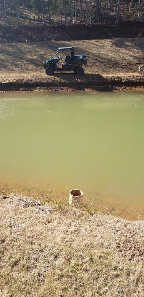

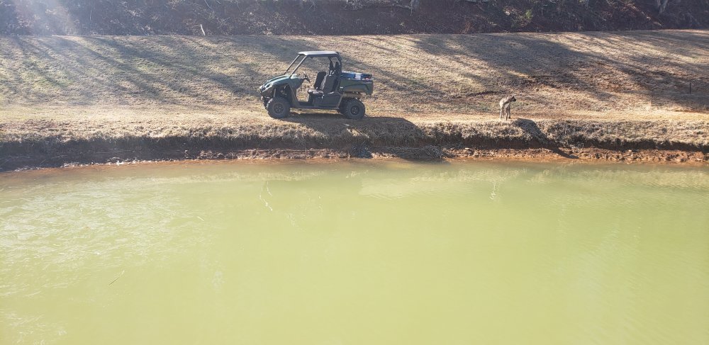

And after less than 24 hours, we're at "full pond" again! Appears overflow output is once again matching input supply. Will monitor it for a few days to keep the standpipe clear from all the loose stuff (leaves, sticks, grass) that blew in, now beginning to float and circulate that way...
