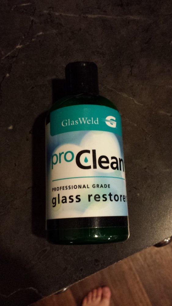

I finally broke down and got a bottle of this stuff. I saw it on YouTube and I gotta admit, it works pretty damn good! I first tried it with a non-scratch brillo pad, but wound up having to hit it with four ought steel wool. Of course, thaf will leave little swirl marks, but I believe they can be polished out. I'm just glad the glass is reflectie again and I can see through it!
Not sure what's in that shit besides amonia...there's definitely amonia in it!
