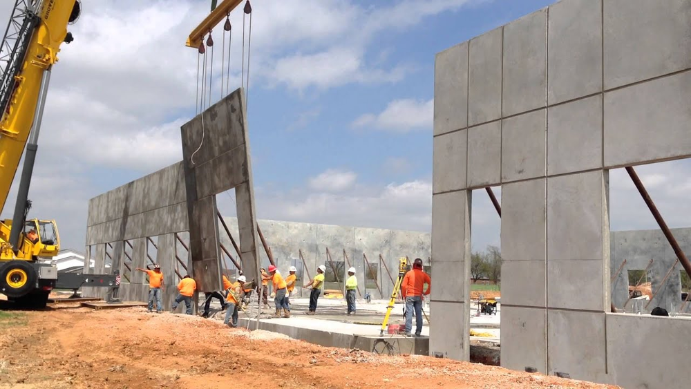

Tilt-up FTMFW but not residential

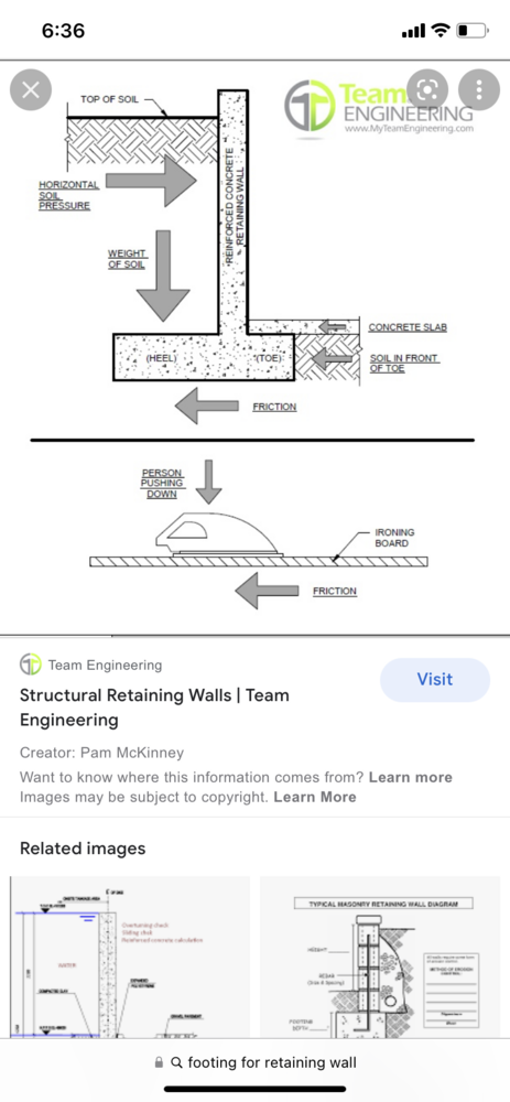

What I’m hearing is the wall will be structural and holding back 7-8ft of dirt. If it was my shop I’d do footing and wall then slab. This is the style of footing I would pour.

But, I don’t see anyone pouring foundation walls on top of a monolithic slab (unless you are doing tilt up panels, and at that, the panels are installed on a footer, not the slab).
