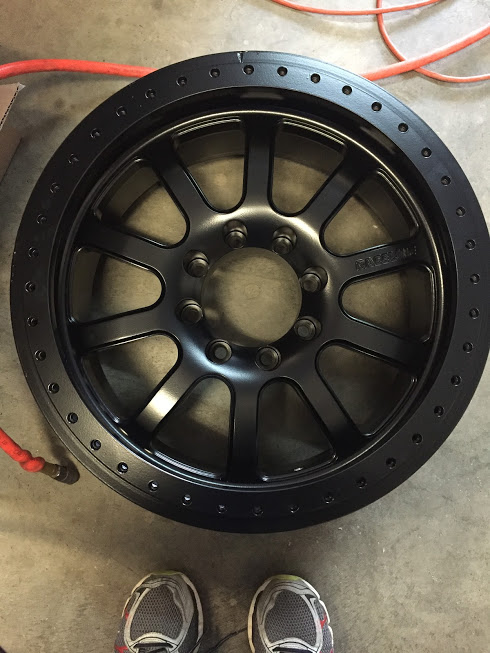

They did a good job. I'm happy with them but only time will tell.
