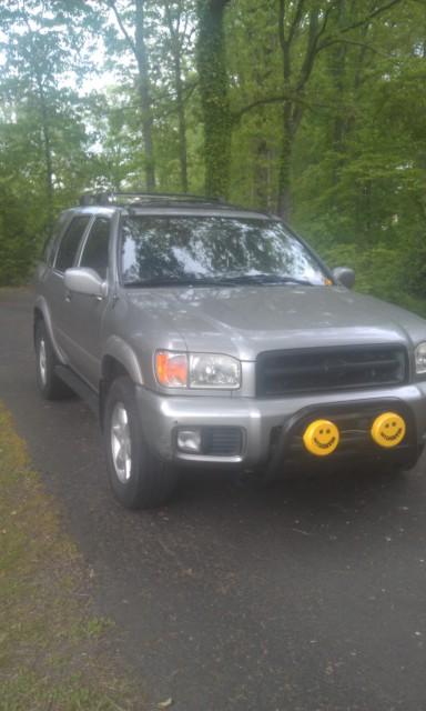

Phase 1: Pre build appearance (November 2013)
Roof rack for the spare
Bull bar
KC hilights (130W)

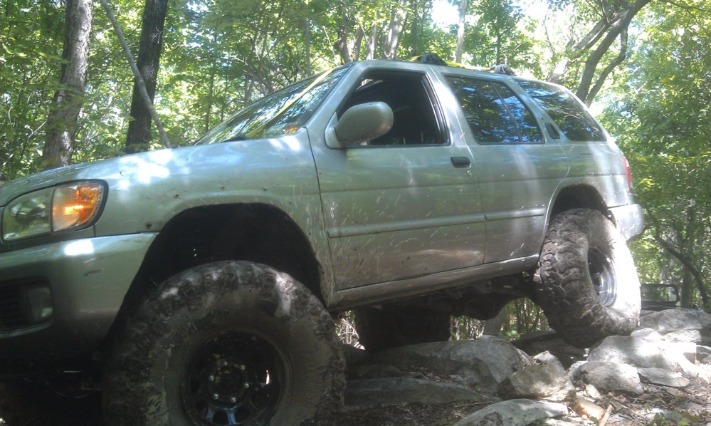

Rode: Uwaharrie trail system ($1,100 frame damage from dutch john)

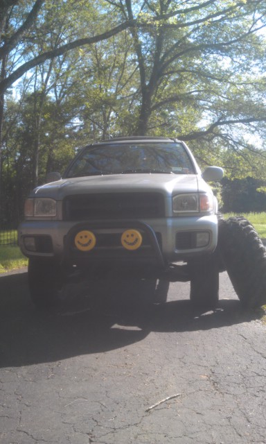

Custom built 4 inch front body lift
2 inch automotive custom front coil lift

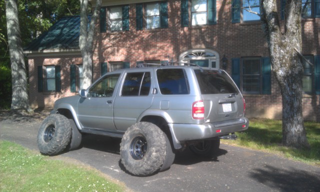

6 inch rear suspension lift (4" jeep WJ coils) (2002 ford f250 superduty shocks)
36" Irok super swampers
A lot of fender trimming
Rode: Big bear creek trail system (some bumper scratches)

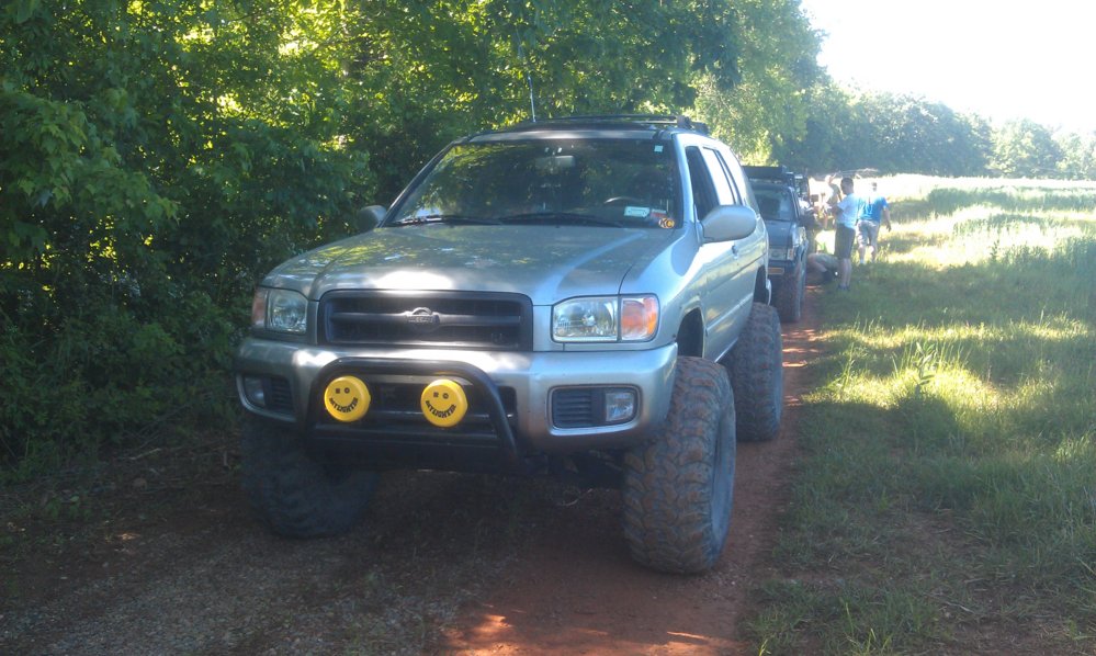

Current picture:
Coming soon:
Fender flares
Hood vents

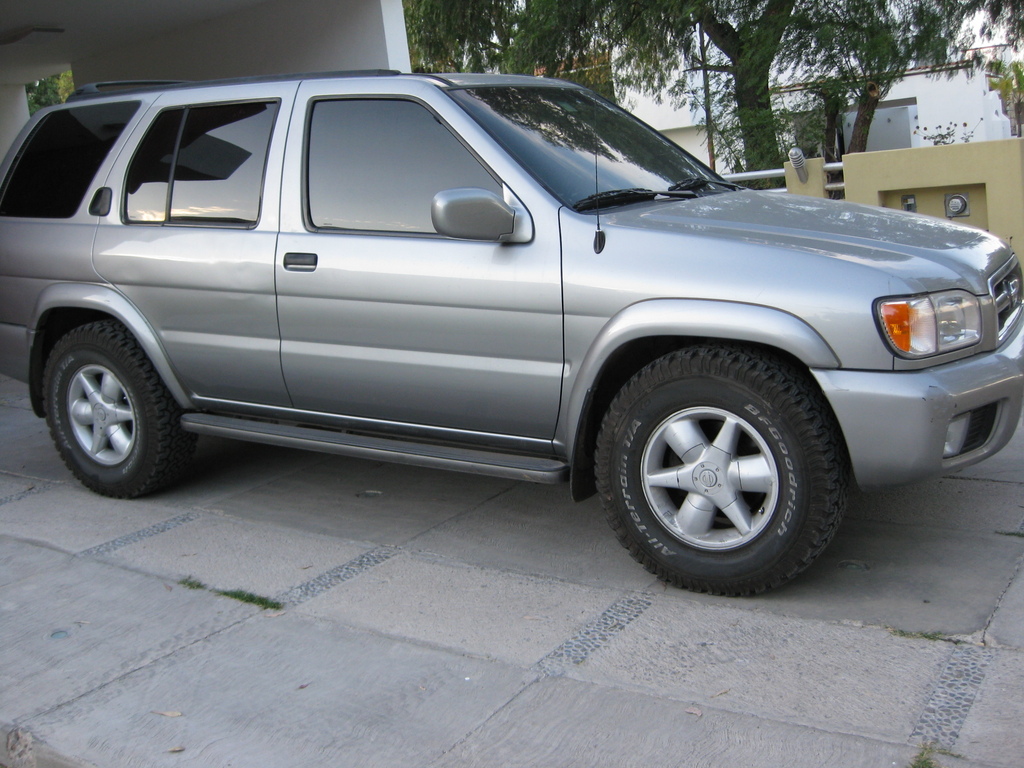

35" BFG Krawlers
Get a winch on there somehow

Update: Subframe drop on the way soon, gonna move up to 35" All terrains (total 7" taller than stock). After my first trip to URE, My first priority is ground clearance. Bottomed out on almost every single mound. Other than a small dent in the subframe from dutch john, No damage. Second priority is traction. My highway tires stopped me from getting traction on dutch john twice and I had to be towed up both times. The lift will consist of a 6" suspension lift on the back axle and a 4" subframe drop in the front with another 2" suspension lift in the front. Halfway there!
