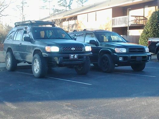

i do just fine biggest thing to worry about is tie rods
Nice Truck Krawler. Where you from?
Im in greenville. My truck is sittin on 32.1 bfg mt's with 2" wheel spacers. Ive got roughly 2.5" of lift all custom by me. After reading this i can see sombody has def done their research on npora but i dont think with the 35's your rpm estimate is correct ive got the big gears in mine factory 4.86 and after 75mph it wont go into overdrive so it usually sits around 3500rpm. I was gonna do a subframe drop on mine and had everything done steering extension lift blocks and skids but the guy from kfabs wouldnt sell me just the strut spacers so i took it all back off. When i lift again it will be dana 44's front and rear and hopefully a cummins 4bt one day but will def keep up with this thread and see where it goes.
