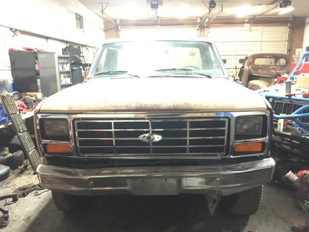

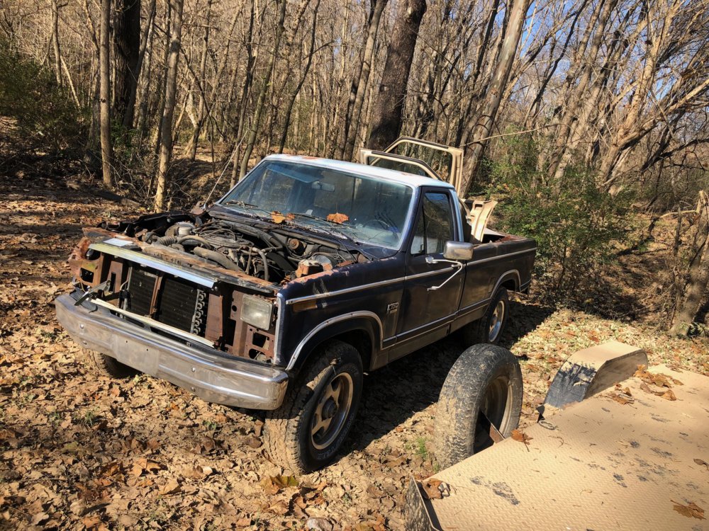

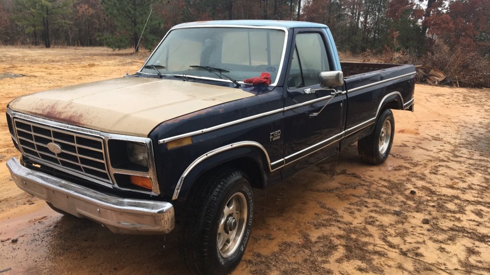

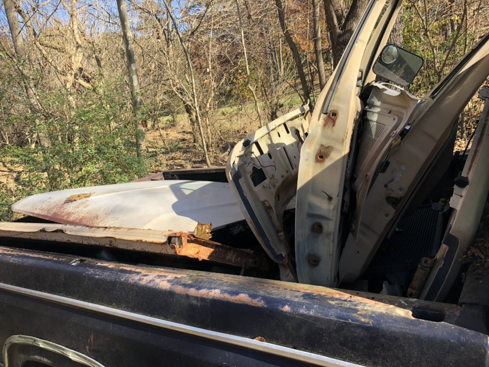

So the last thing I need is another project but when a friends post something up you think could be perfect you have to check it out. My son and I have been looking for a 4x4 to put at my parents house in Aiken, SC. They have about 50 acres there and I have a few aunts and uncles with 5 or 10 ponds to fish. So today we went and looked at and picked up this 84 F150. 300 straight 6 with a 4 speed. It currently has 265/70/17 tires and Pacer rims. It’s supposed to have all the parts needed to fix the damage. I should have the title in the next week or so. Plans are a 31” or 32” mud tire. Fix the damage and strip anything under the hood that is absolutely not necessary for it to run.

Wow! That looked so much like 1 I sold about 3-4 years back! But mine had the light blue color & 302 engine. So much rust, & who knows when 4 wh dr had been used. The shifter would barley move & wouldn't catch 4 low. It was the rust, in the shifter, plus I had to buy a new bushing for it. Luckily, Ford still carries the bushing.

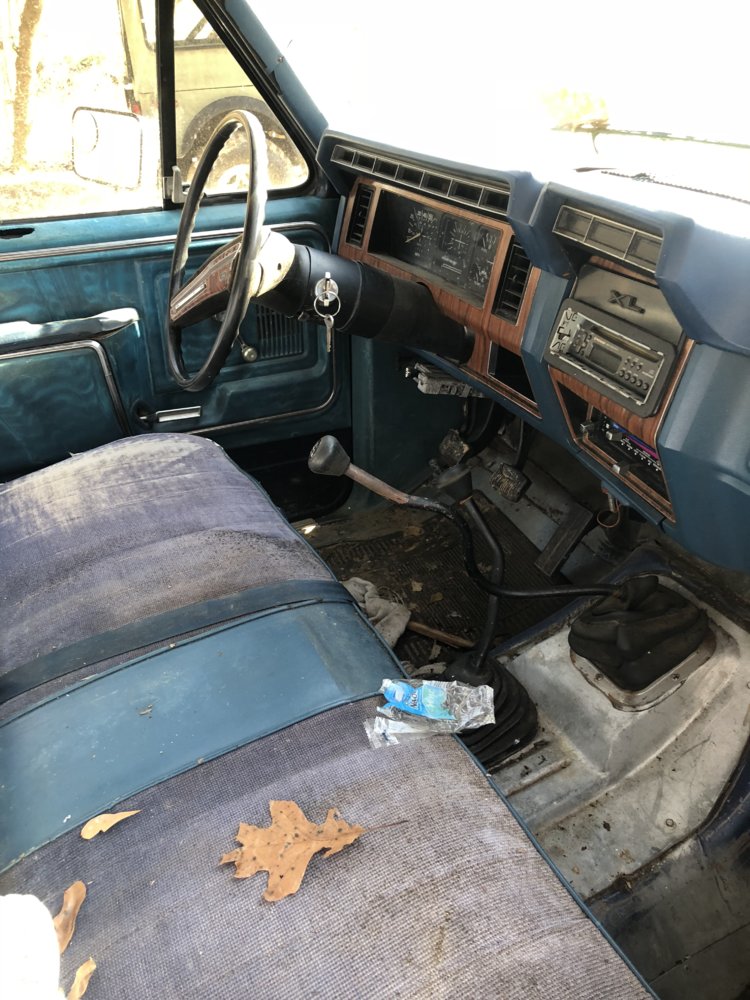

That trans shifter looks very T-19 ish.
I've got a few 435/205 combos laying around if you get the itch to do a swap. There would be little to no benefit other than getting rid of the 208.

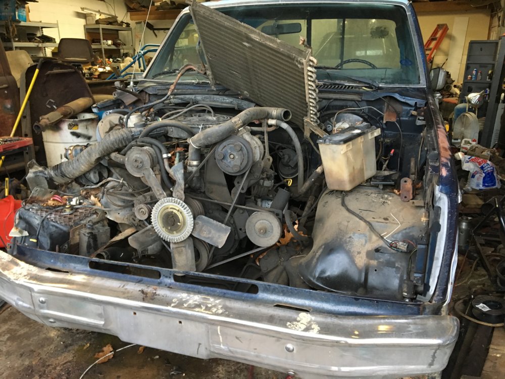

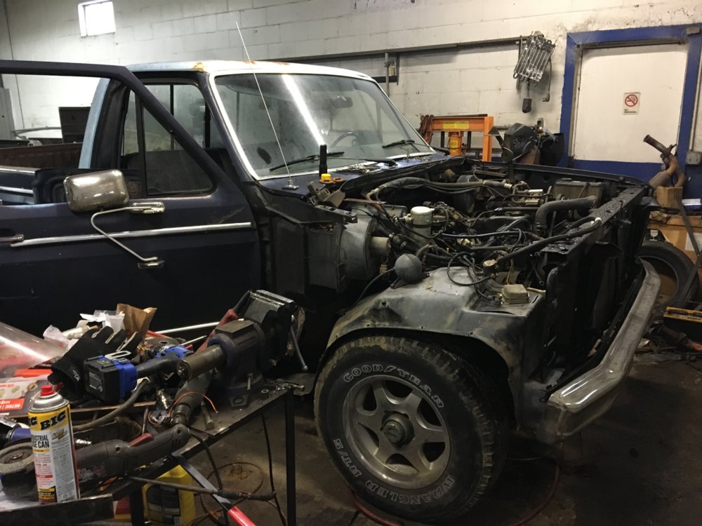

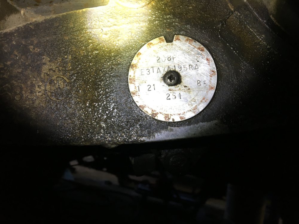

My son pulled the dented fender last night. Today we pulled the radiator support. Found the fan bent. So far everything but that was in the bed. He wants it driving in the next week. We shall see. My goal is Christmas. Oh yea he choose a name. “The Blue Horse!” Supposedly the truck hit a horse. So what can I strip from this motor/under the hood? I crawled under her today and confirmed a 208. What manual came in these trucks? I saw a PTO plate on the driver side.

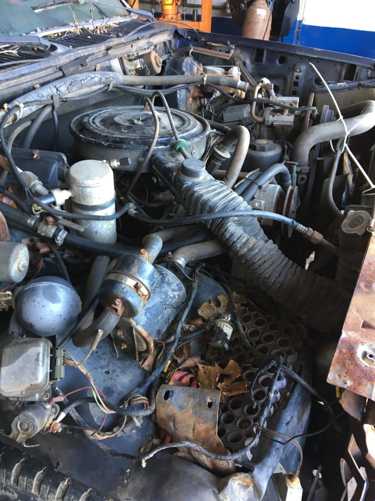

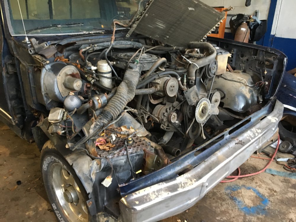

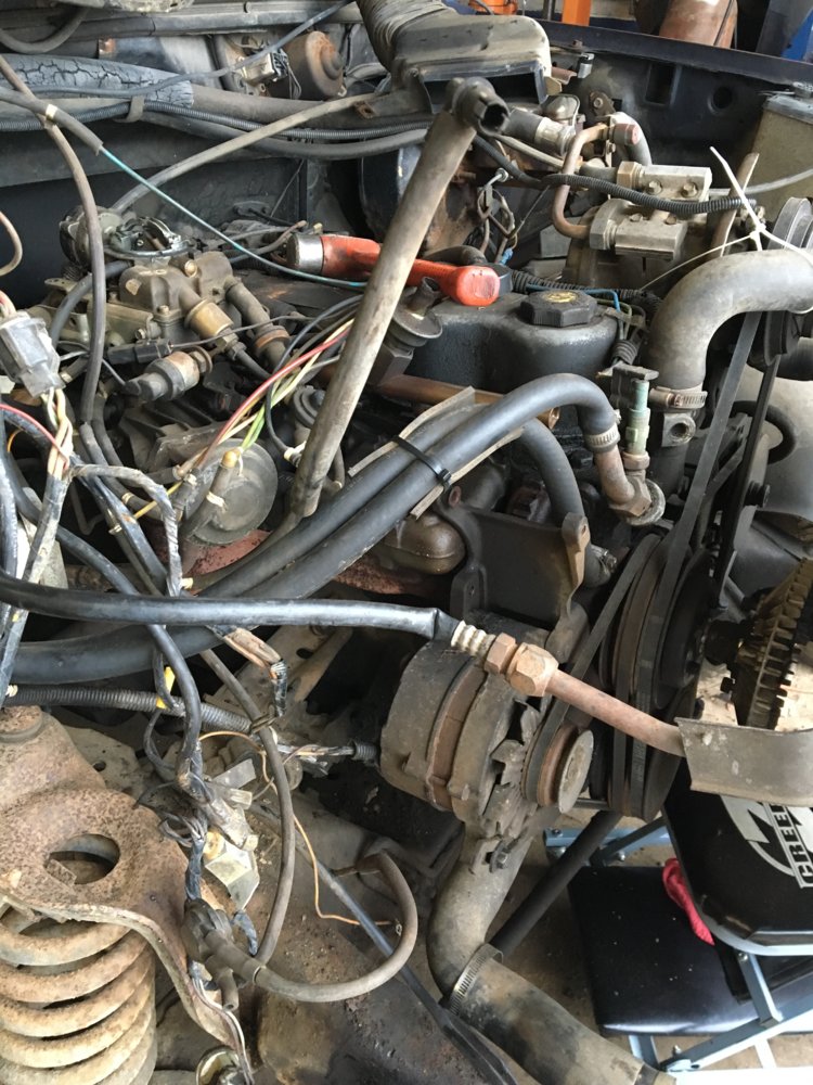

Make the “smog” pump disappear!
I assume that is the pump on the top left of the motor.
You can pull the heated air intake hose/actuator flap & associated hoses. Makes pulling air cleaner easier.
Not sure what that is but I'll look it up.
What are the metal tubes across the top of the head that go into the head?
skyhighZJ
Thanks for your taxes
May 31, 2012
Aberdeen, NC.
Correct. It recirculates exhaust gasses to the intake. They are real good at locking up and smoking belts. They are also real good a drawing HP off the belt line and unless you have a different 300 than I had they aren’t exactly “flush” in the pony Dept.

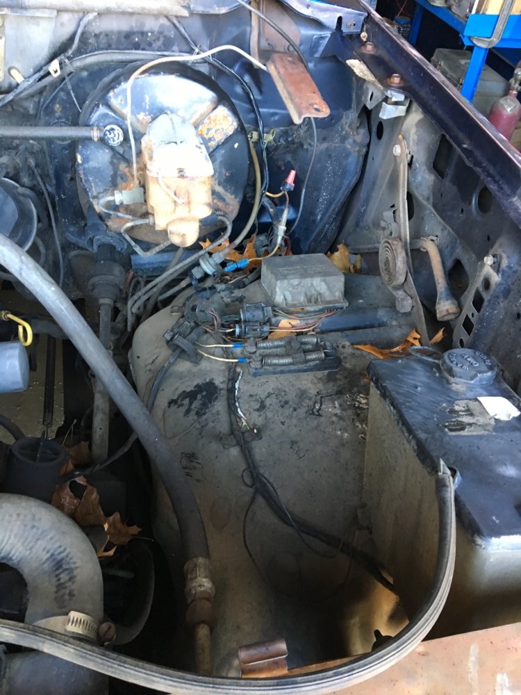

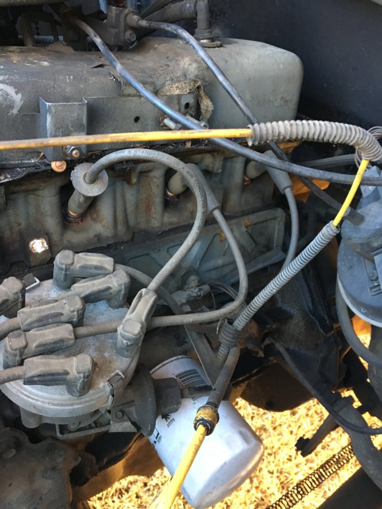

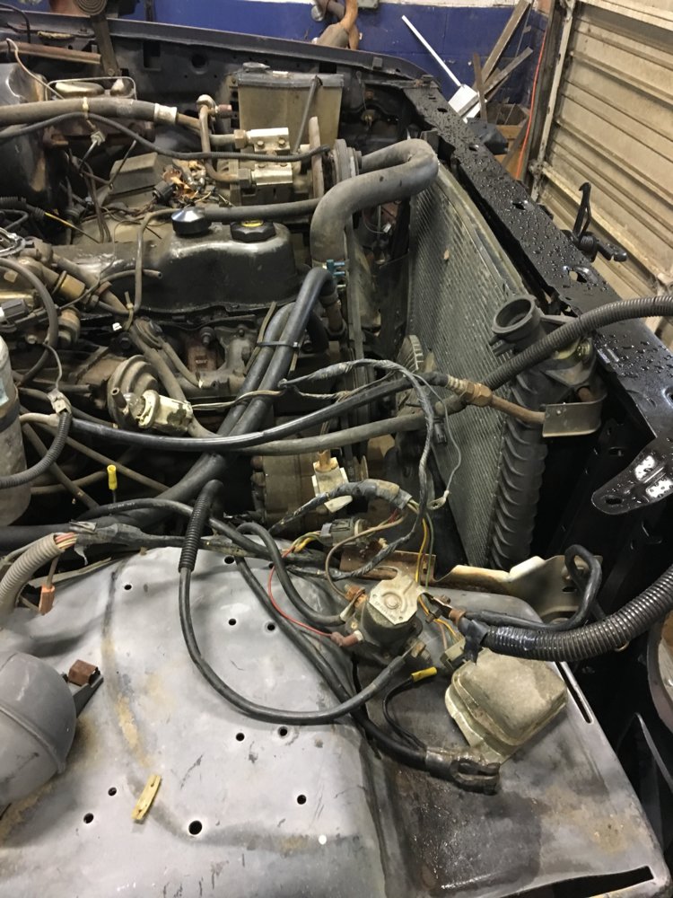

After work I pulled the smog pump. Son will clean up the radiator support donor and paint it this weekend we hope. WTH do I do with that rats nest of vacuum lines? Can I cap them at the card etc and remove them?
ghost
May 25, 2006
Hartsville/Camden,SC

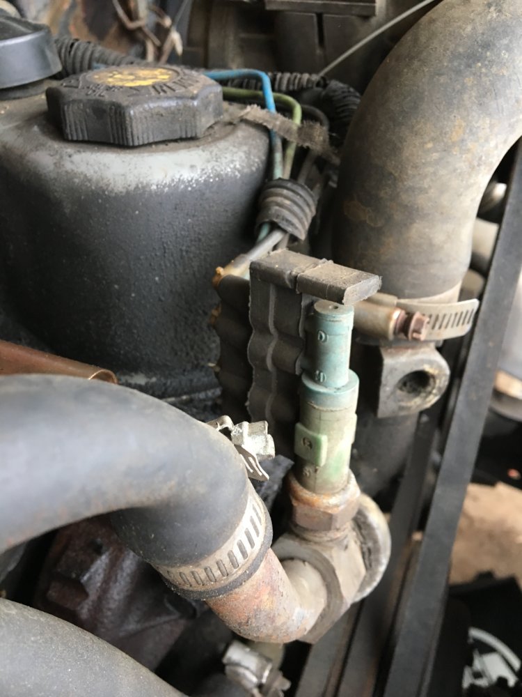

This looks like vacuum lines coming off the thermostat housing where it goes to the heater hose.

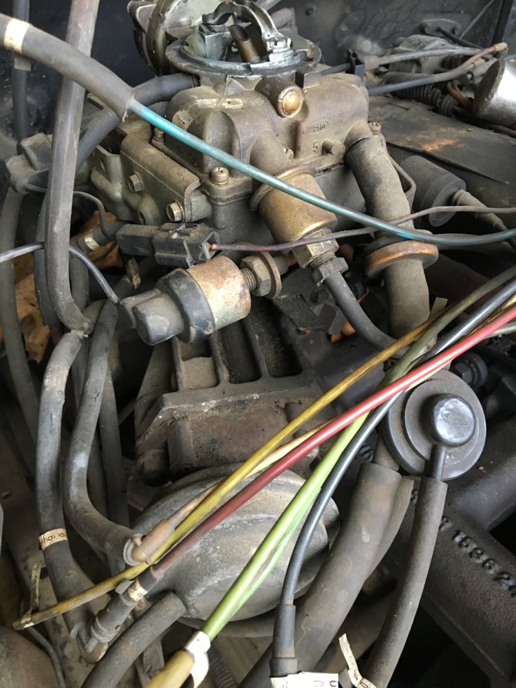

All these look to be vacuum lines going into the carb. Can they go away? What is the big round thing below the carb here?

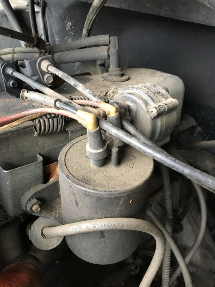

What is this on the driver side of the motor? Can it be removed and discarded?

The egr valve is below the carb, the other pic shows a vacuum canister touching the plug wire with the vacuum lines going in the top, just behind it looks like the egr vacuum amplifier. That's how emissions were crudely controlled before computers.
Edit: I'm talking about your last two pics.
If you have no emissions test you can get rid of it all, but it may require rejetting the carb and playing with the distributor curve.

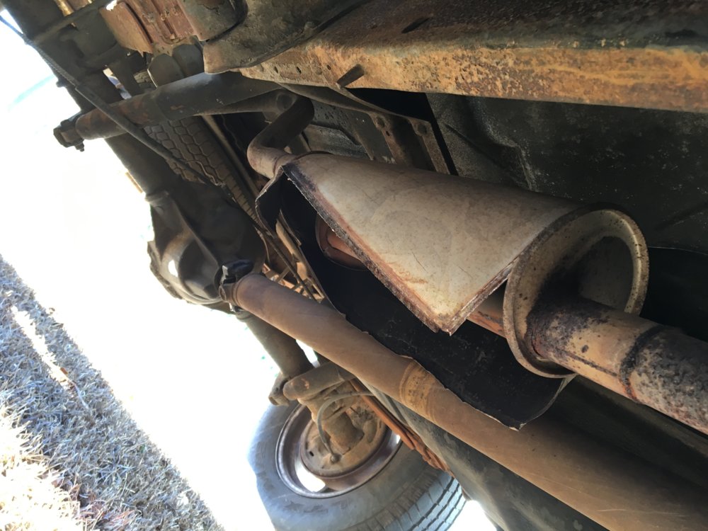

Headlights and fuel sender will have to wait. She started running rough and not starting. Exploded the muffler. There is a vacuum line coming off the distributor. Should it be hooked to something on the card? Smells like varnish at times. I’m thinking when we filled it up we knocked some old fuel loose. We tried a new coil and new plugs. I’m thinking clean the carb and pot fuel stabilizer in the tank. Thoughts?
skyhighZJ
May 31, 2012
Aberdeen, NC.
Not sure of the input but yes the line going into the carb needs to have vacuum applied as it advances the dist. for spark advance as the motor revs. Very nice work on the muffler by the way I’m laughing cause I did the same thing on an old 2wd Scottsdale I used to bomb around in back in HS. It was a 6 cyl 3 on the tree. If you revved it up and cut the key off it would usually let out a bang. Last day of junior year I was leaving the HS parking lot and gave it a REAL good send off and blew the shit out of the can. Cops were not impressed and I got a stearn talking too and a phone call to my folks for my behavior on school grounds. My dad just laughed and gave me a high five then told me to go fix the POS cause it sounded horrendous.
