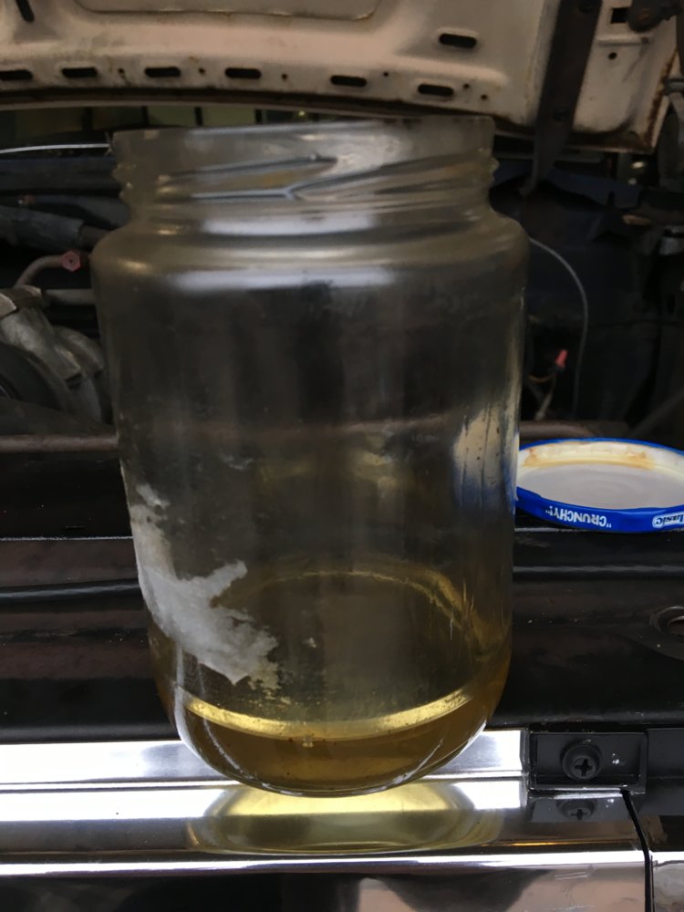

How old is the gas?
I'm not entirely sure. When we got it it appeared to be empty. We put some 5 gallon cans in until it was full once ready to be driven. I'm wondering if there was old gas in the tank that has mixed with the new and made it less potent.
Straight out of the pump. Poured it on the ground and it lit slow. I think this is my problem.

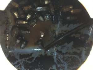

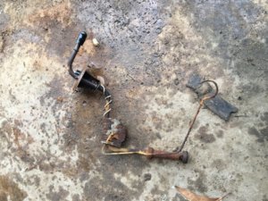

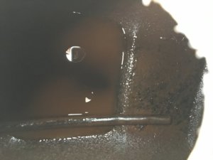

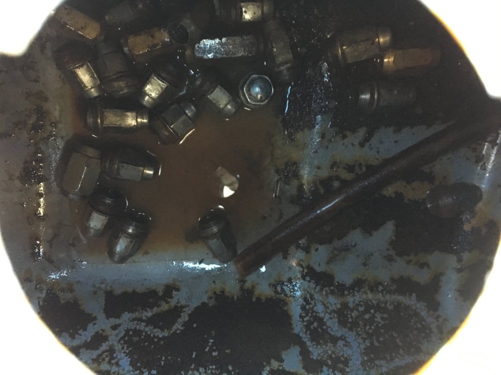

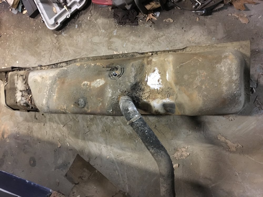

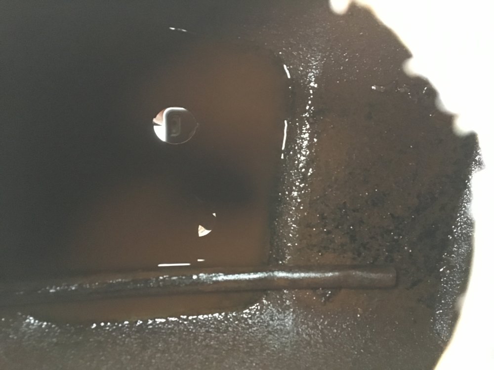

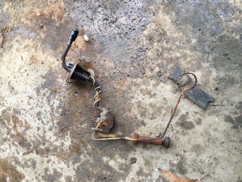

So I pulled the tank this after noon and its nasty.... I think something is missing on the fuel level sending unit......

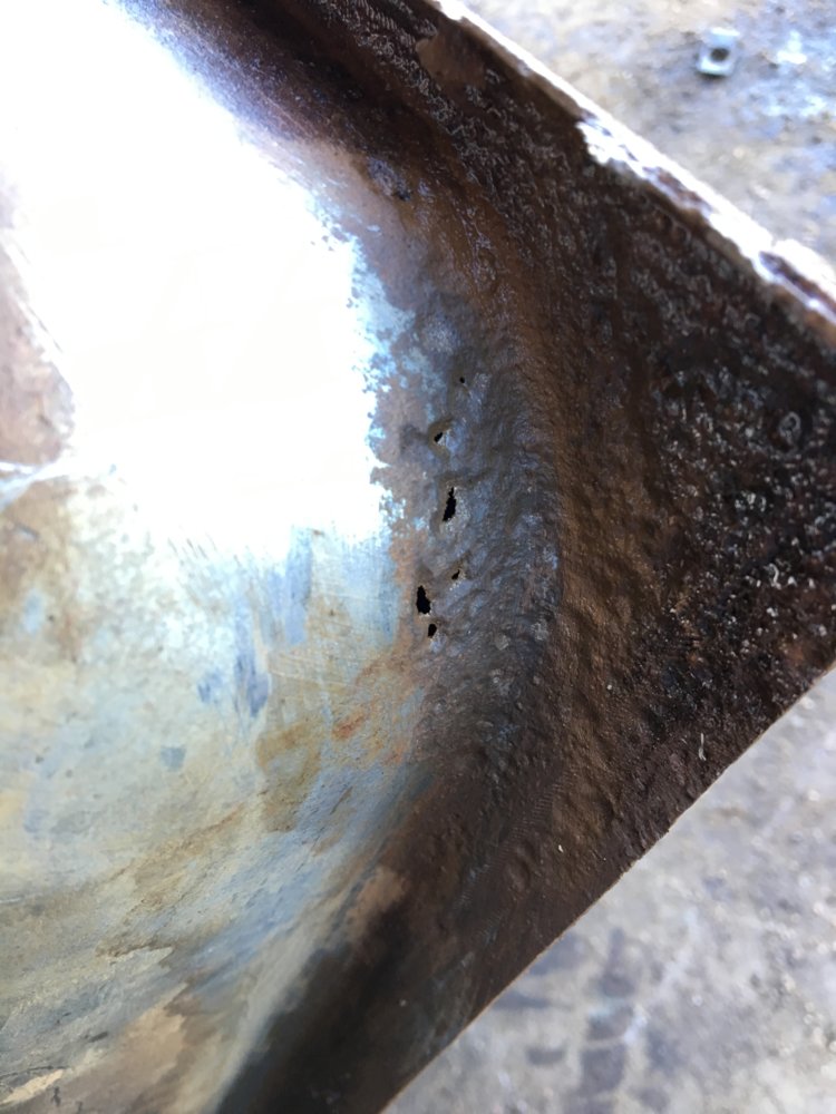

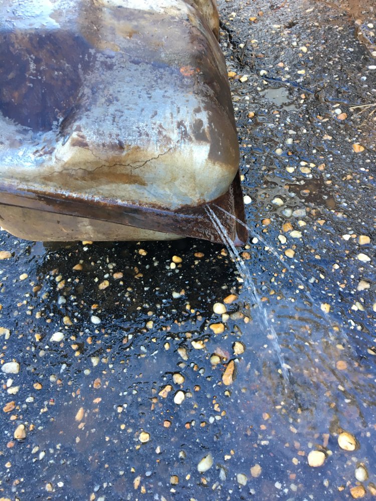

Did some cleaning on the tank today and that pressure washer I recently bought did a great job. However there are some small holes in a corner. Are these tanks steel and can they be patched by welding? Are there any other options om repair?
I had a piece of gravel get between my tank and skid plate and worn a small hole in the bottom, been holding with JB weld for bout 12 years now. Like drkelly said if it’s real bad just get a new one
The thing about trying to weld is that all the surrounding metal is thin, so you'll have a frustrating time. Eastwood makes a tank sealer that works well, but a new tank is probably your best bet.

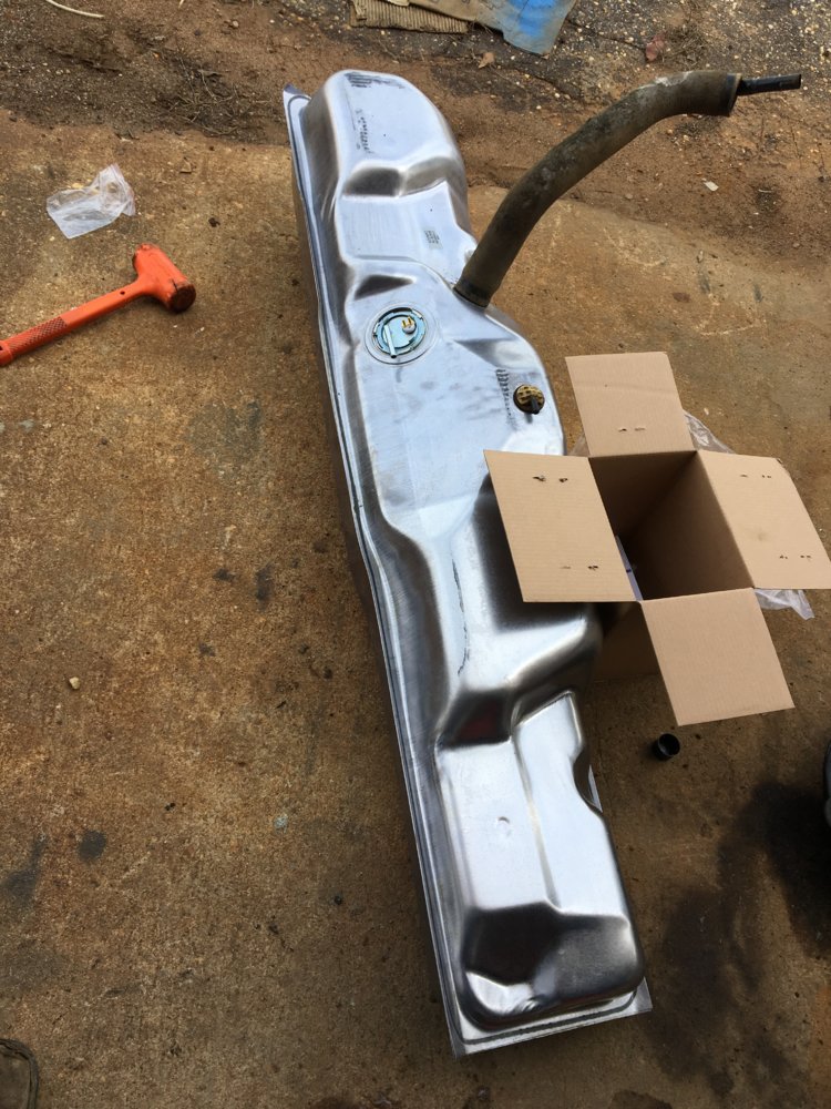

So new tank and new sending unit and the fuel level gauge works now.....

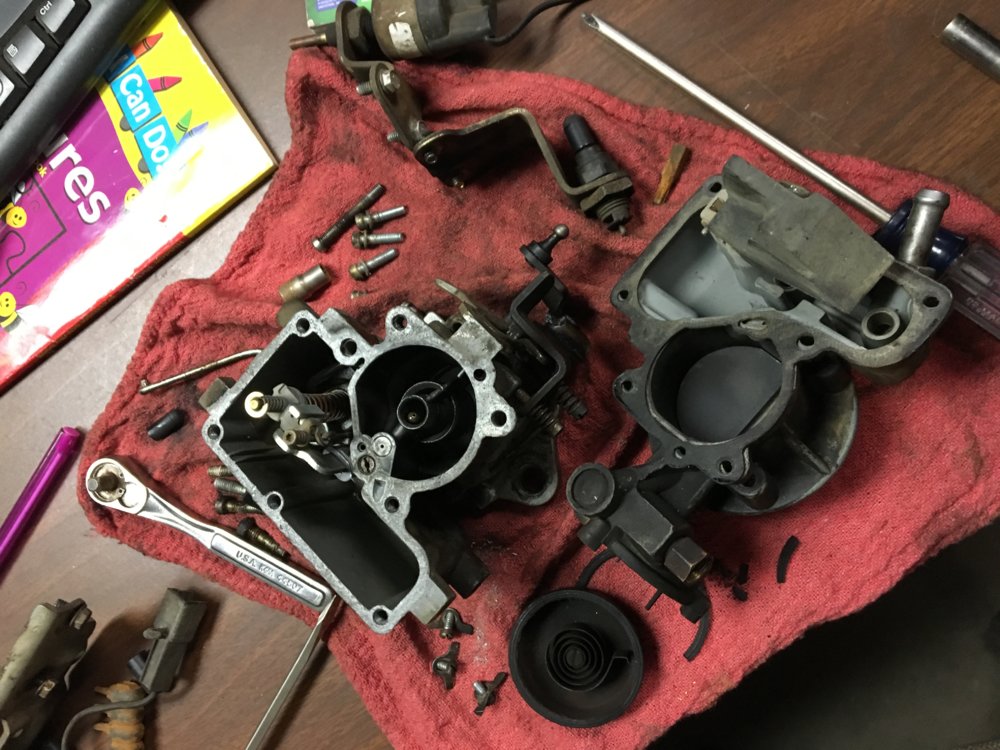

Rebuilt the carb....
Never done that before. Not 100% sure I did it right either. Put fresh fuel in and she still will not stay running. Will fire right up with starting fluid then die. So for $25 I can put a new fuel pump on it. I know it pumps but I'm thinking maybe it's not pumping enough. One thing making me think this is that the truck runs good once it starts but will not idle. The higher rpm's pump more fuel so therefore it's not pumping enough at idle. This had been very educational but I'm ready to have a truck that will drive......

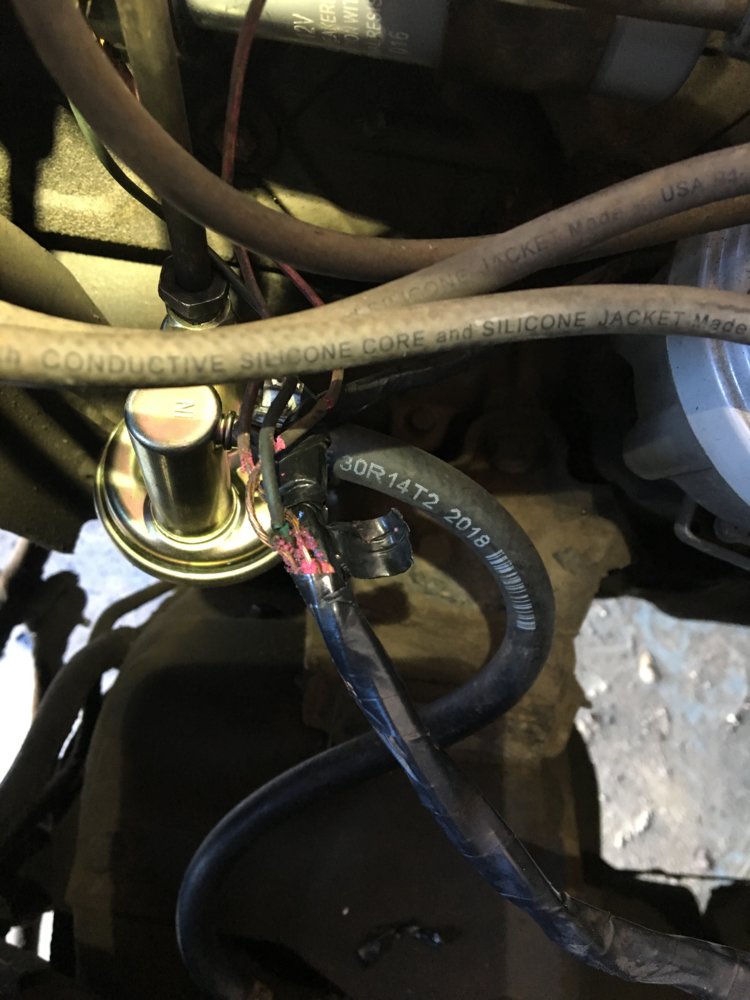

And she keeps fighting me! Found some wires with the shielding gone. Wrapped the bare spots with tape to test it. Nada! Will not start with the new pump. I think it’s time to call my mechanic busy Lenny.
So Friday with truck on trailer I went to see my old friend Lenny. After seeing its nto getting fuel he had me pull the carb and we tore it down on his bench. Apparently a little ball got lost at some point and I missed reinstalling it... so carb works now. So I reinstalled it and still would not run. After scratching his head and doing a few test I would have never realized to do. he determined it was loosing spark after cranking. Survey says ignition box on the fender. He jumped 2 wires and boom she's running. he adjusted the carb and said go get a box. Took him about 2 hours. I asked what I owe you he said $30. Money well spent and now we have a running truck. Now on to the headlights and fix my muffler. Now I just need to get the MJ running right.....
