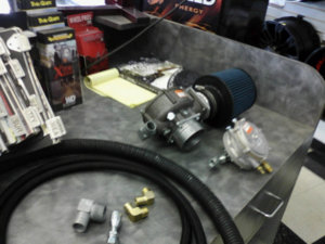

OK update. I gotta turbo, some better(+HP) propane parts, and whatnot...comp not posting pics..
Doing a draw-thru turbo propane 22R very similar to Carey @GotPropane. I am using a CT26 from a 90 Supra because I got it cheap, and it has been a proven easy uprgade from the CT20 that comes on the factory turbo 22Rs. I am going to leave the turbo stock wastegated at 6.8 lbs for now. But i do already have a manual boost controller purchased, but I was thinking walk before I run..lol.
Dibs on that turbo :flipoff2: My ct20 will be pushing 10lbs til it blows ...I'm just not sure how long it will last
With the draw thru, do you need to have a boost reference on the regulator like you do with a blow thru?
I'm looking to do a similar setup using a t3, but have been thinking about doing blow thru incase i wanted to do intercooled later. I plan to keep it under 10lbs.
