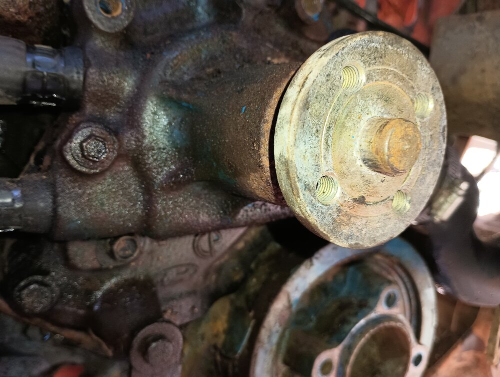

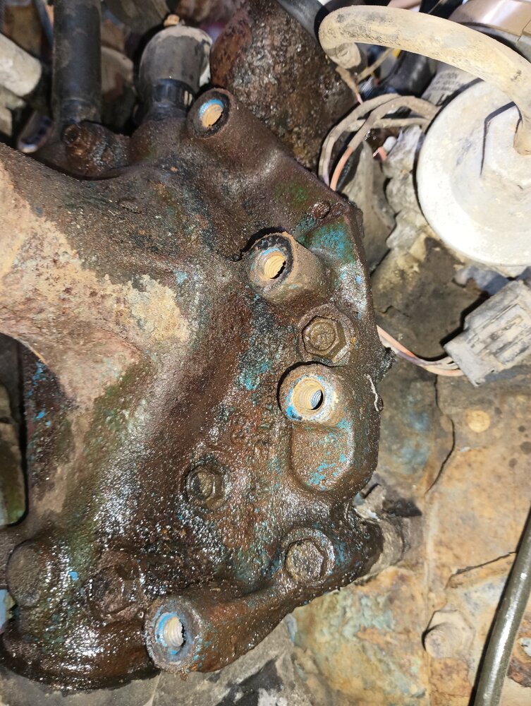

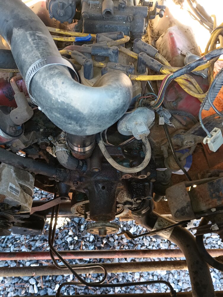

When I was underneath I noticed a bit of antifreeze. It's from the water pumps weep hole. After watching a few videos it seems like I might get to break some bolts off in the block while removing it.

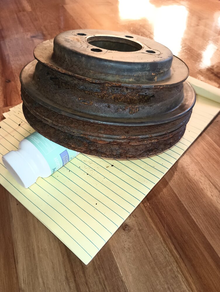

After removing the belts I noticed the crankshaft pulley is ruined with rust. Thankfully you can't just buy a new pulley. You have to go on eBay and find an overpriced rusty one.
I can't figure out the rusted pulley. Maybe the frt end sat in a creek for a while.

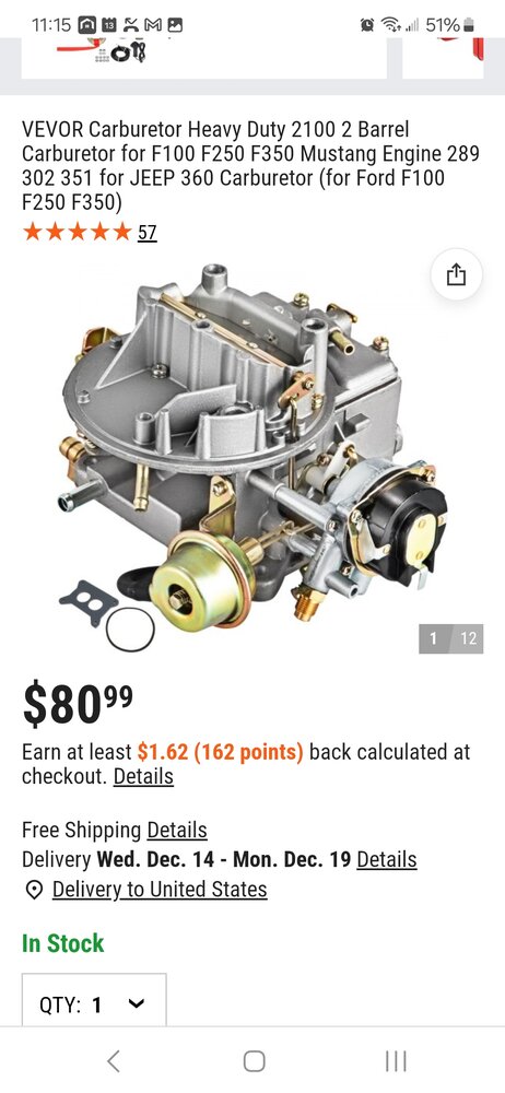

As far as the carb....I'll probably get everything ready as far as a tuneup etc and see how it goes. Maybe it'll run great? If not I'll probably go the eBay route for carb. Just too many variables with rebuilding one and all the things that can go wrong.
I used to run MC 2 barrell carbs exclusively back in the day. When they're dialed in, they run very well. I'd suggest rebuilding yours vs buying one. I say this as the rebuilt ones will likely have a wallowed out throttle shaft bore in the main body. You can test yourself by hitting that spot with carb clean when running. If the idle smoothes out, you have a leak. Most do, some are just enough to live with.
My brother in Christ, that appears to be a 4 barrel Holley but I agree with you, hard to beat a 2100 motorcraft. Thankfully it's not 2002 and now we have vevor...

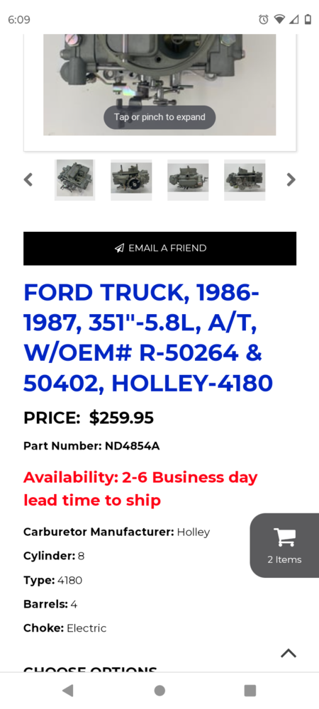

Thanks guys and yes it's a Holley 4180 maybe 4180C ? It has elec. choke.
From what I'm reading...the fix for it is a
Edelbrock 1406.lol
It seems from Google searches many people have troubles with this Holley after rebuilds ranging from tuning , tiny vacuum leaks,warped surfaces between gaskets, flooding and even no one makes the original power valves.

Amazon product ASIN B07YZVR6DMI have never had any luck with an Edelbrock carb on a ford. I have a friend that is great with Holley carbs. Want me to see if he would rebuild it if you buy a kit?
I’ve been dailying one of those Amazon special MC2100s for almost a year now.
Only thing I would say is also buy a genuine Holley power valve and jets to swap in before even running it
Thanks for the info. I've read that Holley doesn't make the original power valves any longer. I've read threads where people have had trouble trying to find a suitable PV. After some googlefu, it seems a fella on eBay has them for around $20. I think I'll get one to go with the Holley kit since their kit comes with no PV at all from reading some reviews. It's a two stage PV on trucks and a single stage on passenger cars with the 4180 or so it seems.

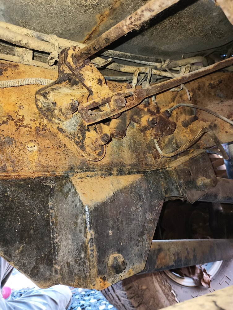

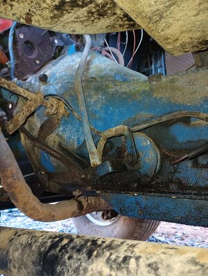

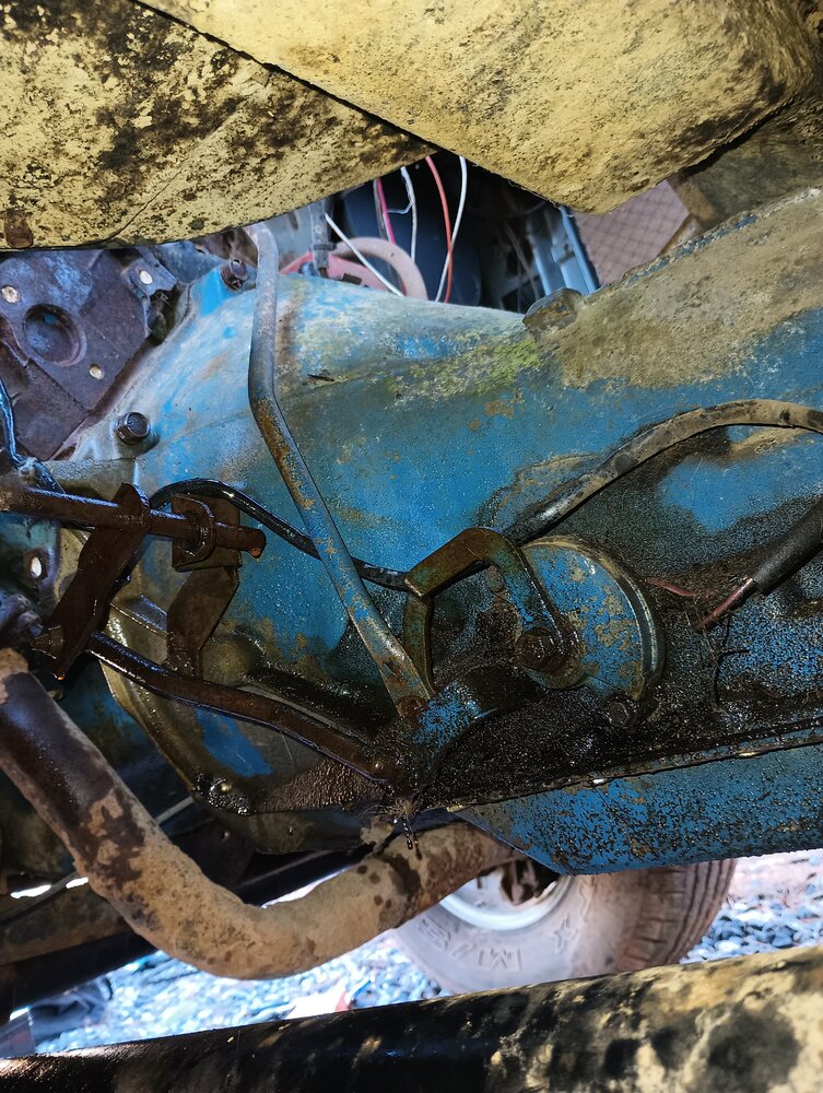

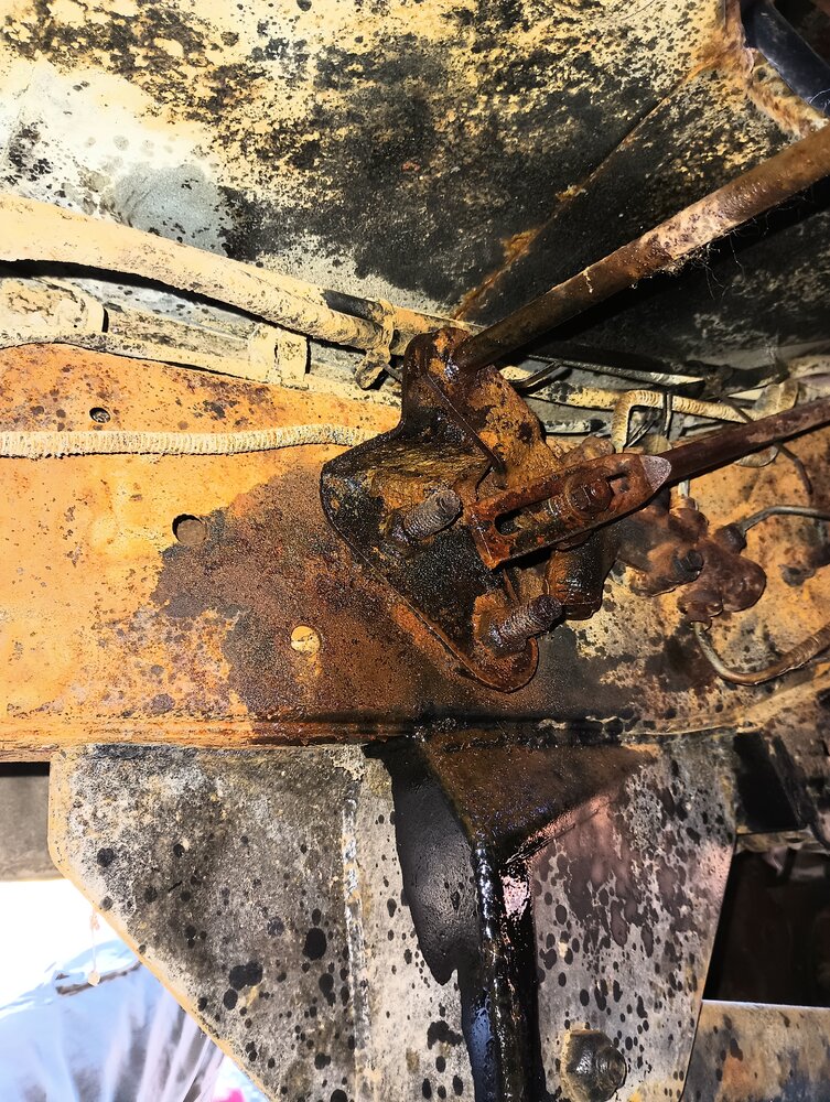

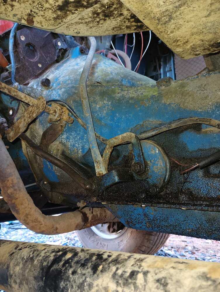

I couldn't get it to shift out of park and thought it was just needing the key or maybe brake depressed. Well I depressed the brake pedal and it's just mush. Then I looked at shift linkage next to the trans and wtf is that shi!!z?
The rod comes from the column down to a freaking rusted out birdcage looking contraption. I don't even know what to call it.
***Any guesses to what all those rods,levers and thingamajigs are "called" would be helpful in Google searches
I've been buying all my carb parts here:
Email Holley tell them you have a stock 351w in a van and want drive it down the highway, then spent $400 on a new one, this is the only way you are going to get it driving worth a shit I promise you.
Chock the wheels then get under the van, one of the arms on the side of the trans goes to your throttle linkage on the carb hopefully still and is the kickdown, the other is your gear selector. Pull the linkage off the selector arm and move it out of park manually. It's possible the pawl is rusted to the parking gear after sitting so long. You're going to need to pull the trans pan anyway now would be a good time

I was at my local mechanics yesterday and mentioned my carb issue. Two guys at once said take it to Cornwells which is a local older fella that builds carbs daily. Then today I asked a good guy behind counter at O'Reilly's about a holley rebuild and he said Cornwells immediately.
***You think it's a waste of time? ***The carb does have the kickdown bar to trans. It's also the cleanest looking thing on the van.lol

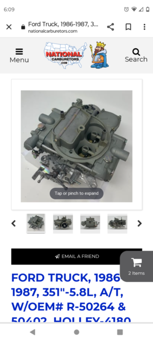

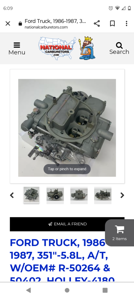

I also found a company that has 4180's ready to go. They have good reviews and are $200 less than a new one. I dunno?
Here are some pics of shift linkage which I soaked in PB blaster.

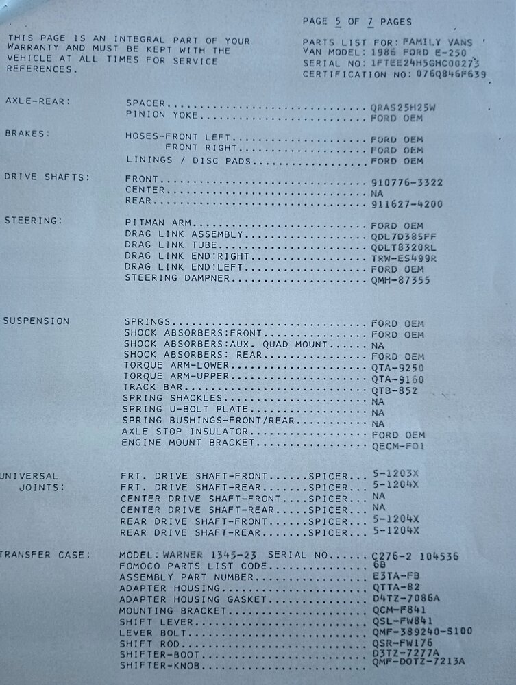

Quigley sent me some info on the van. I don't understand a lot of the stuff I'm looking at but there it is. Also looks like Quigley is against me installing 33's.lol
