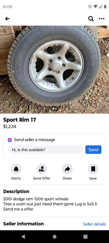

Those are Eagle wheels
I think you nailed it...series 121.
Can't believe you found that. I think mine might be a satin version. Thanks
Edit; Actually as some mentioned I think they are dodge sport wheels from circa 2000.
Anyway, enough of that....

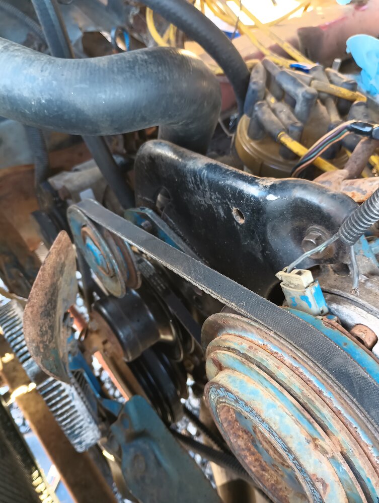

Just finished re-installing the AC,PS pump, crankshaft pulley and belts.

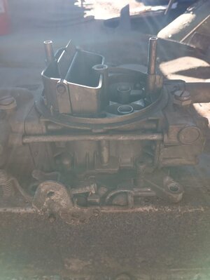

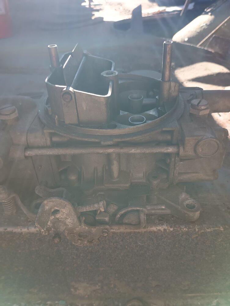

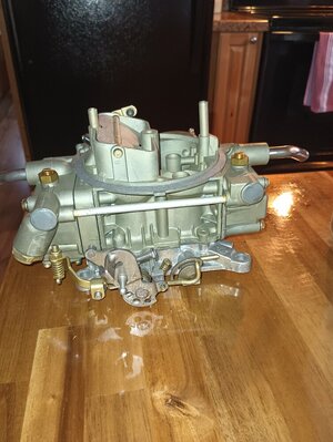

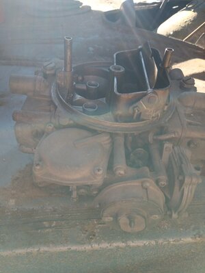

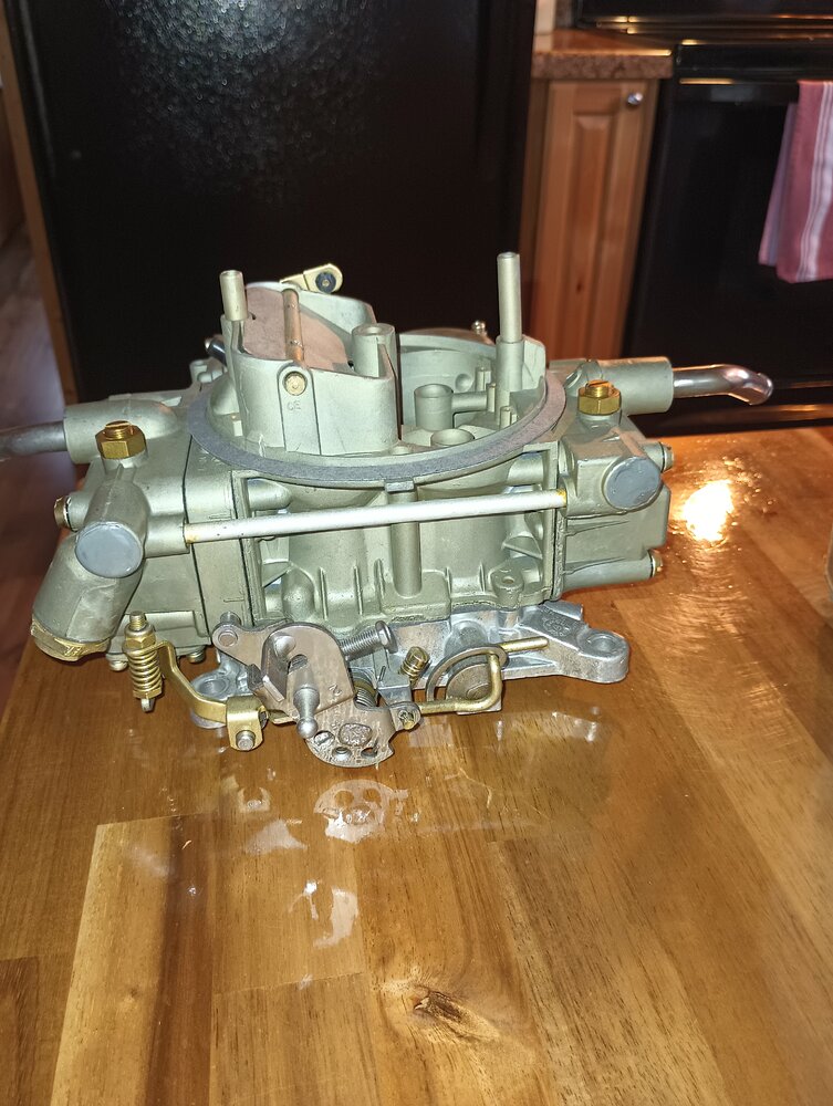

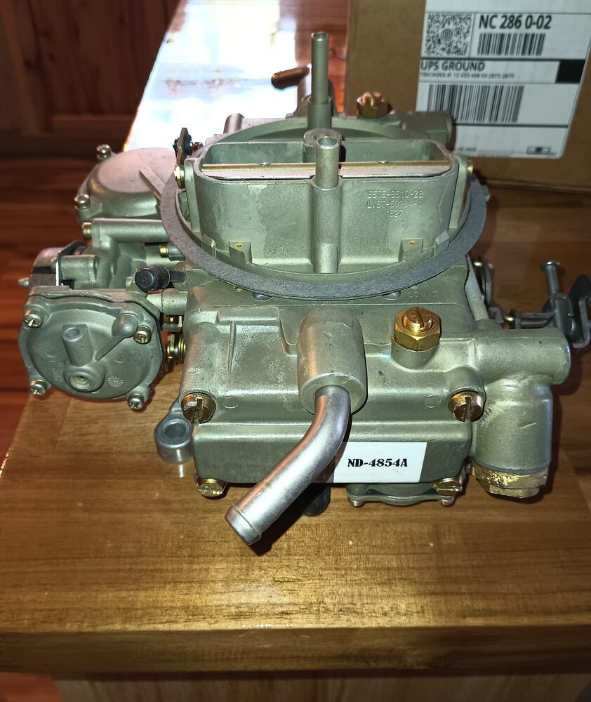

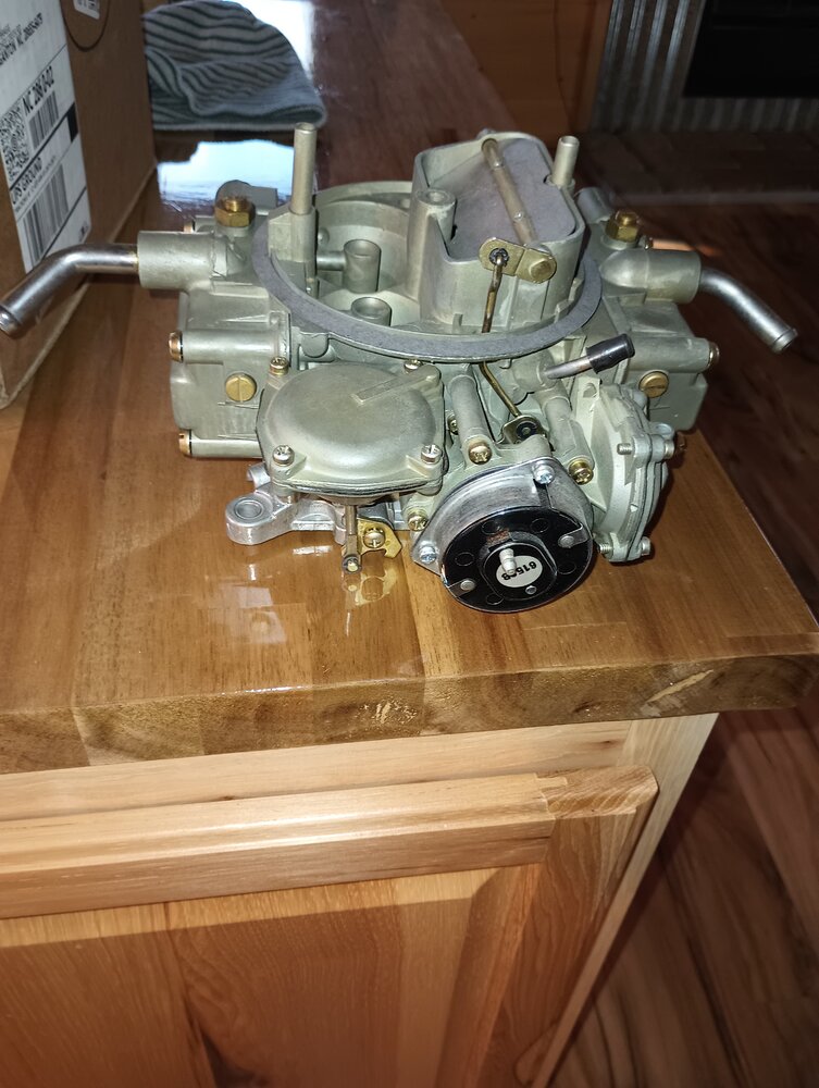

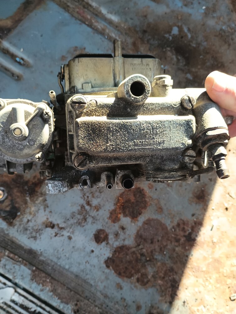

The new carb from National arrived and here it is. I have a couple questions if anyone knows.
1) After installing carb should I use a small funnel and ad a few ounces of fuel to the bowl? There are two bowls so do I ad fuel to both? I've seen some people do the above so mechanical pump has time to get fuel from tank...

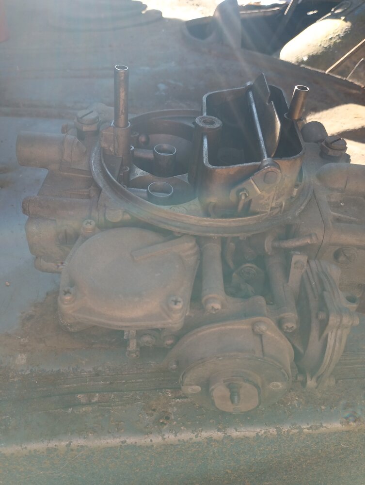

2) this carb is nearly identical to mine. Only difference's I see are the bottom plate of carb has access to adjust 4 screws on corners. Mine had been covered by factory but someone broke the 2 on front side of carb open for adjusting.
Also, this carb has 2 tubes. 1 to top of each bowl. My question is what are these for? Mine has two plugged holes but no pipe/tube.
I'm thinking the carb by National looks pretty good.
Thanks. From what I can tell they went to a canister when it had all the emissions etc.
Hopefully after mounting carb and tank this thing will come alive.

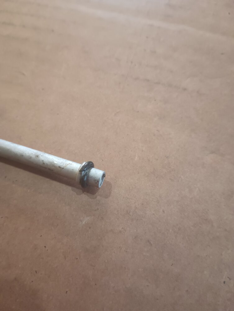

After looking closely where transfer tube goes into front bowl I could see some o ring hanging out. Lol
I took the tube loose to inspect and found it is split. I went to AZ and advance with no luck. I guess I'll get carb company to send me a couple...
They should carry o ring assortment kits
