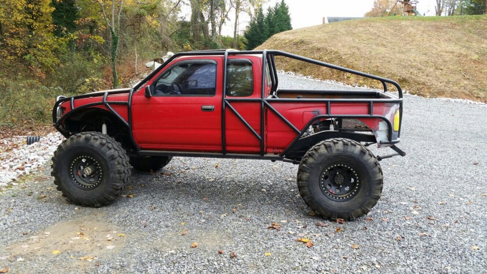

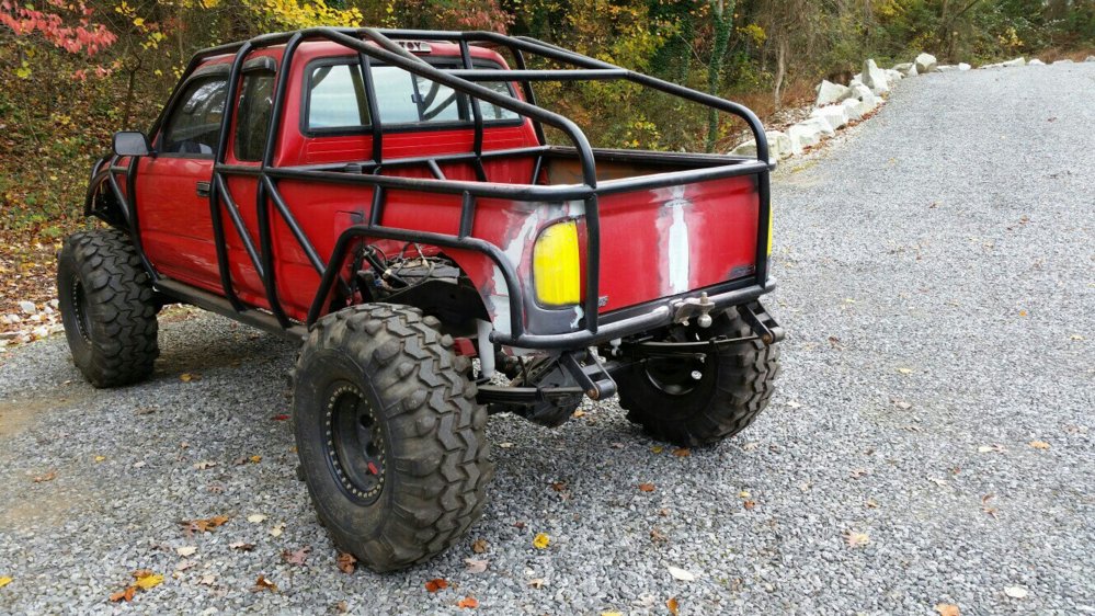

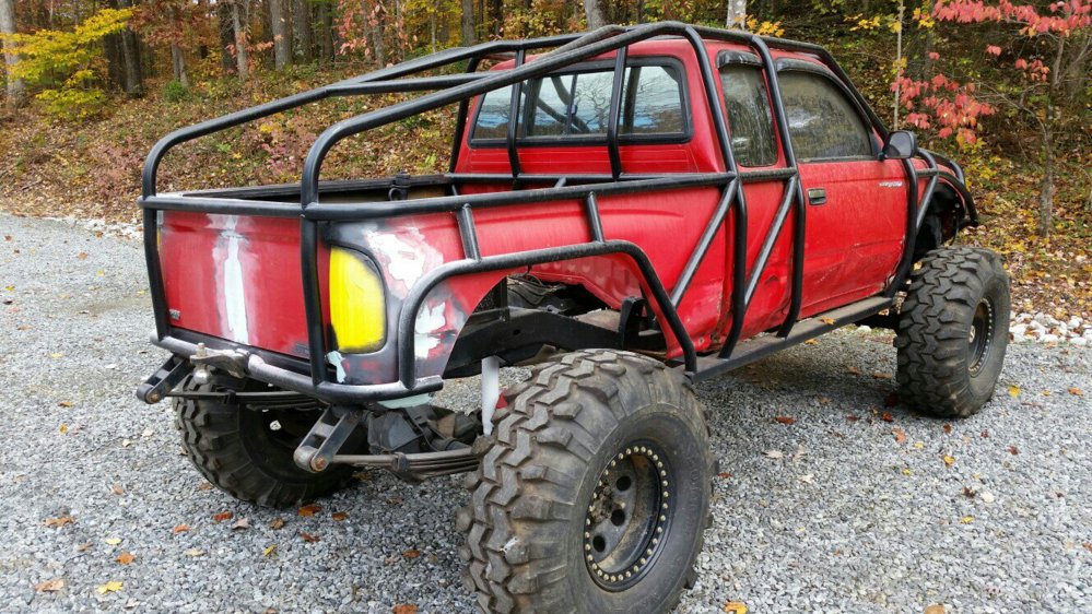

Bringing this back from the dead. Been a shelved protect that i have been promising to finish and life had just gotten in the way. Making some progress now. Doesn't need much;
Finish body work, front drive shafts, and figure out a gremlin with the hydraulic assist. Maybe some of you Toyota guys can offer some advice.
Box has been drilled for assist, psc ram, factory pump with 4"taller resi. Problem is that it bleeds out fine, off the ground, but as soon as it's down and put a load on it, starts losing fluid through the cap. we have replaced pumps, moved lines, checked box, etc. Seems as if there isn't enough capacity in resi to allow all the fluid to return to tank when turned to the piston side of the ram. Any suggestions?
Couple progress pics
