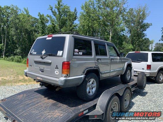

Well I was cruising CracksList yesterday and came across a very nice looking 2000 XJ Sport with the 4.0L engine. It is rust free and with some minor body dings here and there. I got it from the second owner and is still very original. The engine has a rod knocking so a new engine will be in order. I think I will just buy a crate engine and swap it out and will probably go for a trans rebuild/replace while it is out. Also thinking about a 3 maybe 4 inch lift and go for about a 31” to 33” tire. I am new to these things so not sure what’s available but I know it’s a ton. Feel free to share words of wisdom or suggestions. The best part is I picked it up for $700.00. :cool::D
Now for some pictures:

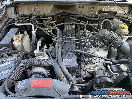

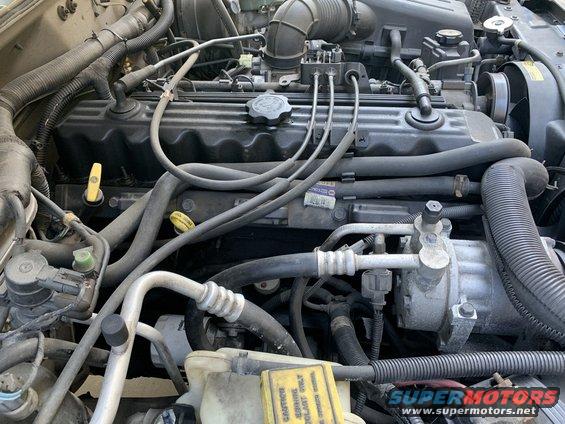

The rod knock may be a cracked flex plate unless there is obvious sign of a true rod issue (lose of oil pressure etc.). Automatic cherokees are notorious for cracking the flex plate around the bolt holes to the crank shaft and sound very similar to a rod knock.
this may be the case as the engine revs very smooth. Other than the knocking sound the engine runs great. The owner never said it ran hot or anything like that.
It’s easier to drop the trans and check than pull the engine so maybe smart to just drop the trans/t-case and scope it out before going off the deep end. The 4.0/AW4 is a stout combo. I wouldn’t throw the wallet at it if you don’t have to. Last XJ I had was at 445,xxx and still wheeling strong with some simple maintenance items to keep it happy. If you want to do a “soft” rebuild (gaskets, timing set, oil pump) that might be an option though to ensure more years of service. About the biggest issue with the AW4 I ever had was over heating. I replaced the pump and seals added a remote cooler and never hand another problem.

I talked with the owner again when we met to notarized the title. He says his son was told by a mechanic that there was coolant in the oil. Not sure how they determined that but will drain the oil and see what I see before i make any decisions.

Well I verified the engine is definitely toast. Will probably go with a crate motor. S&J Motors has one with a 7 year 100k mile warranty for about $2200.00 after all the dust settles.
