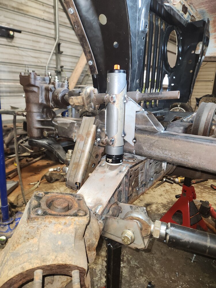

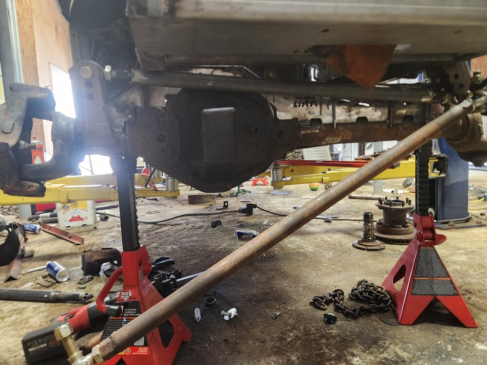

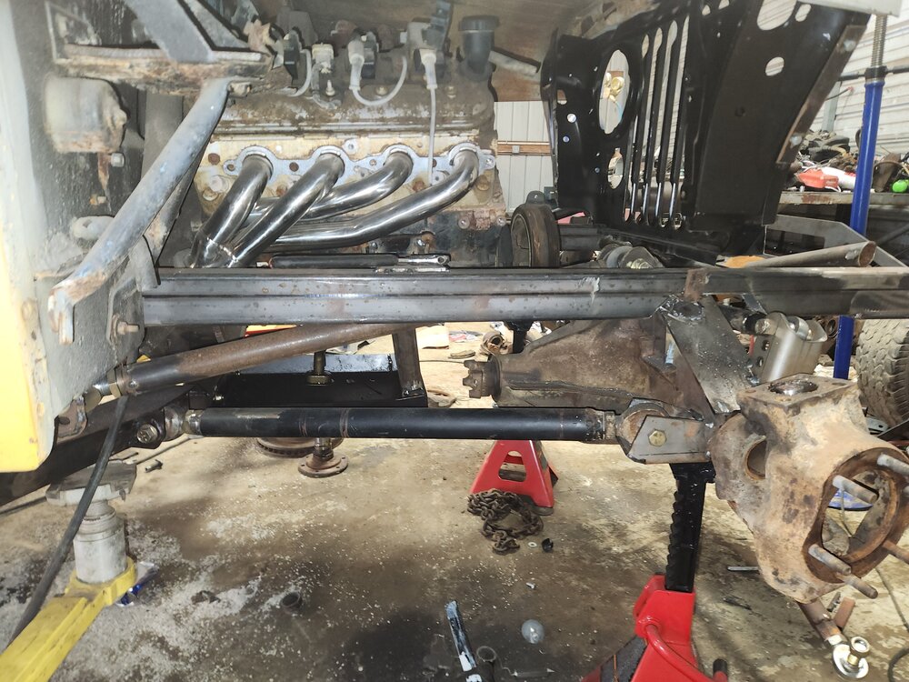

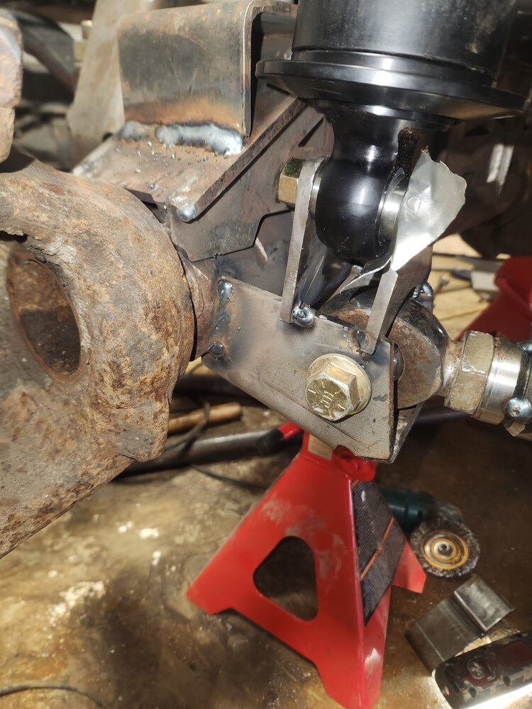

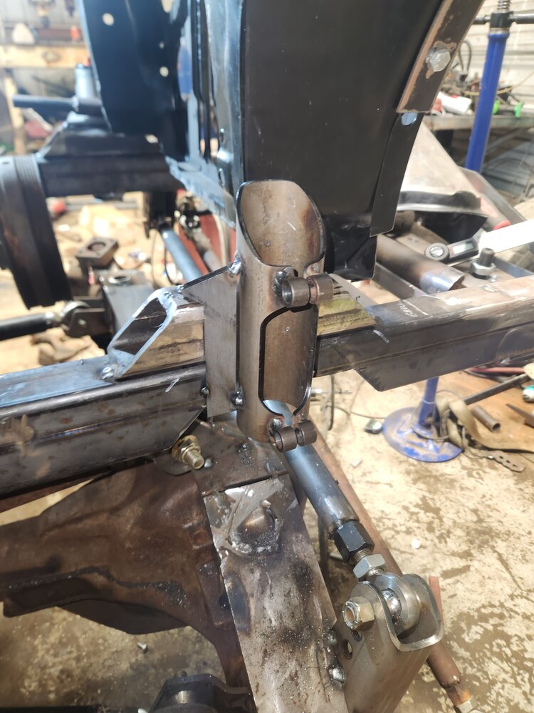

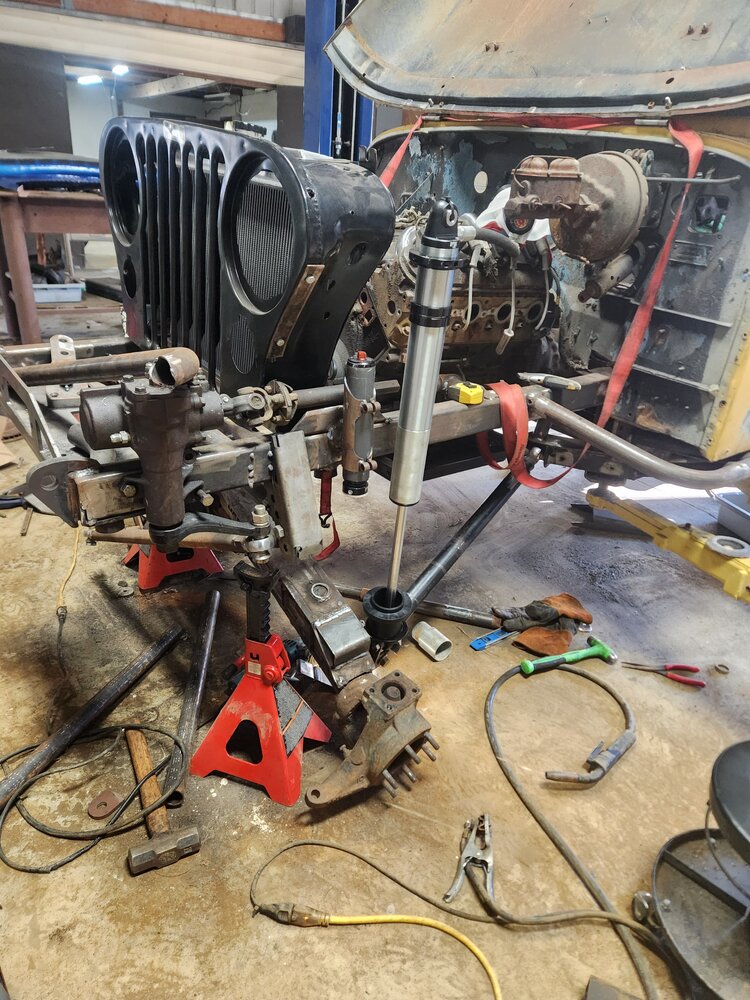

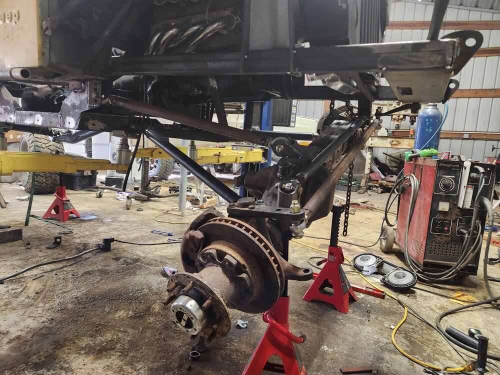

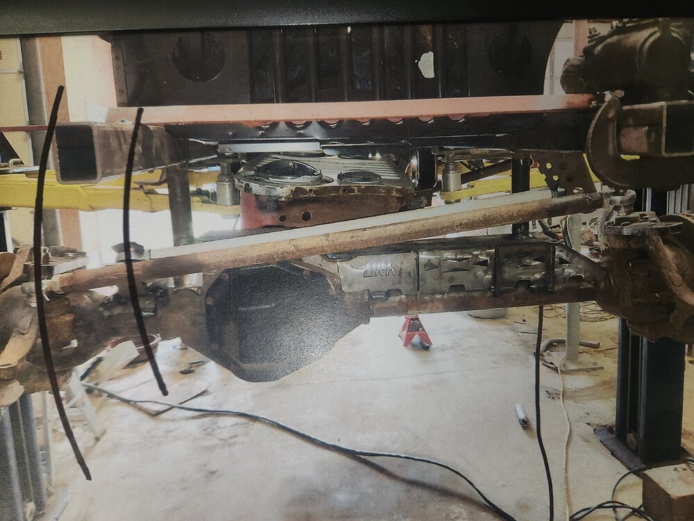

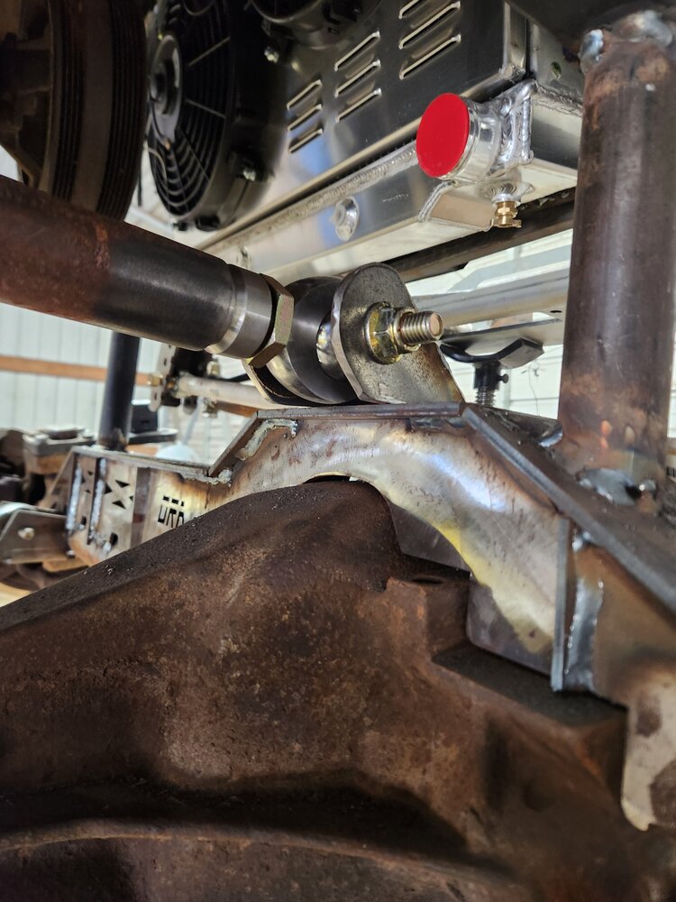

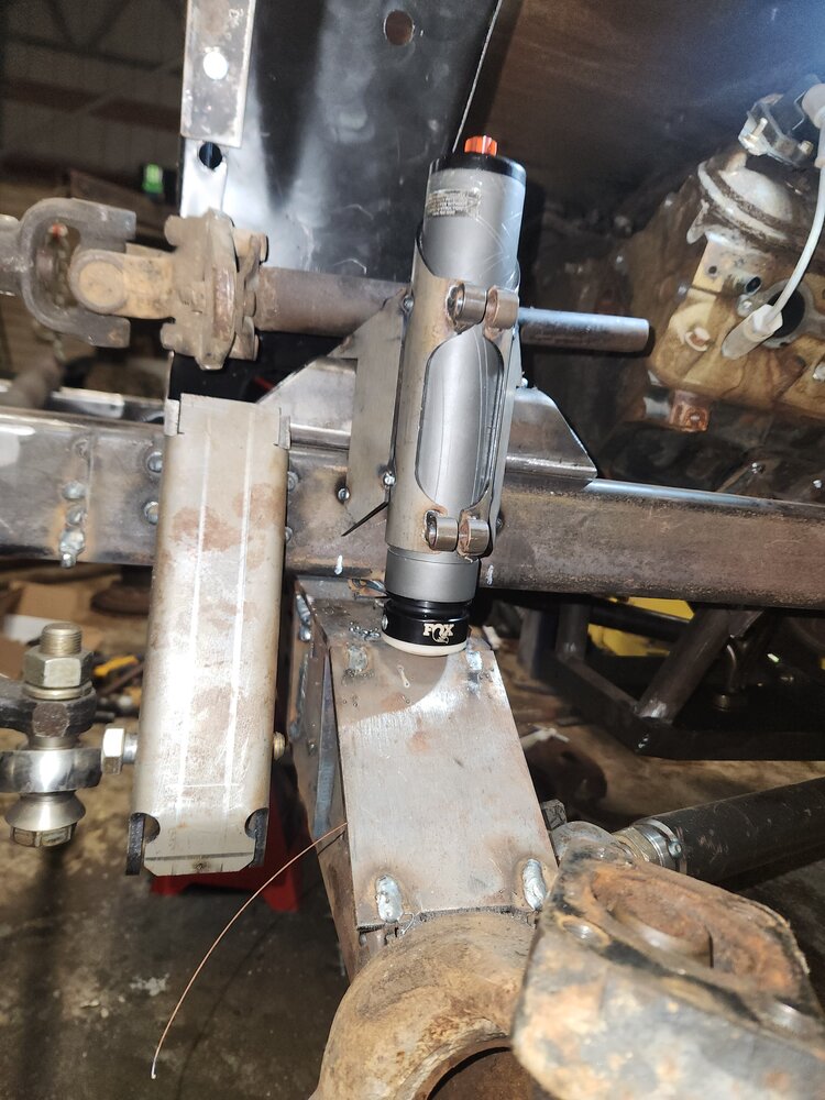

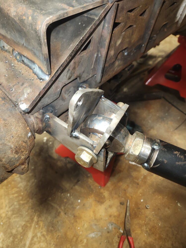

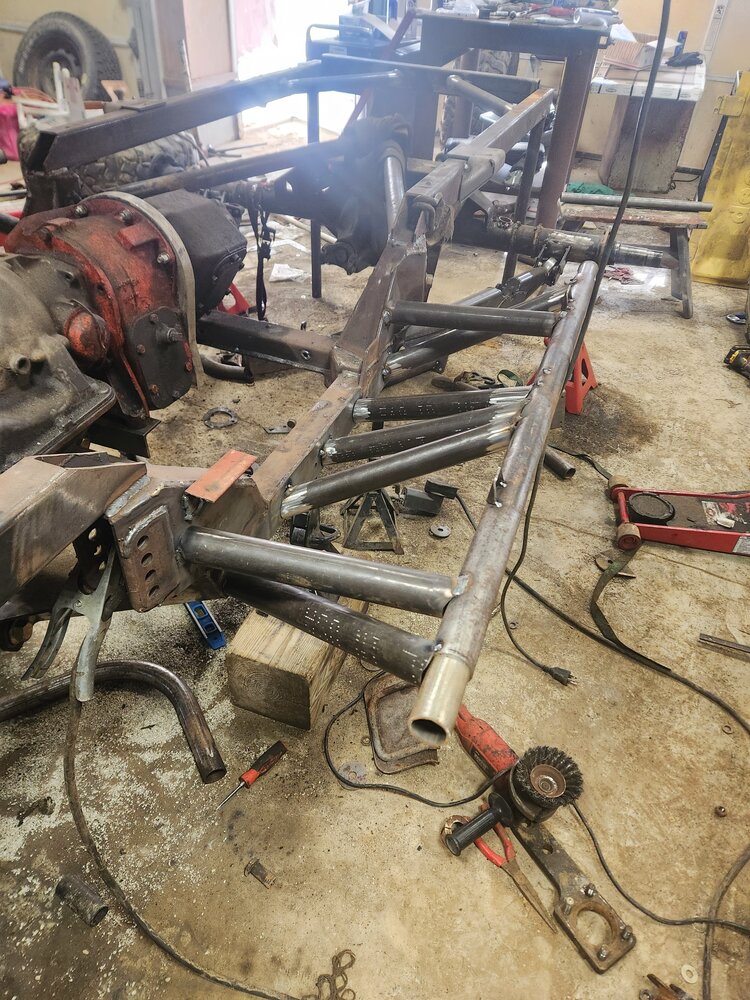

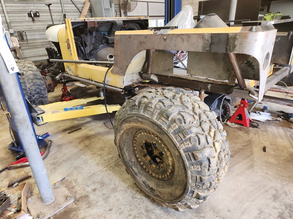

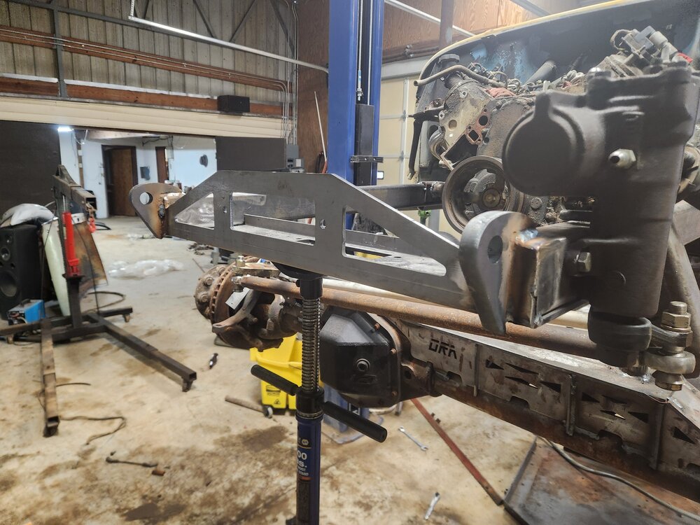

How bad am I fucking myself if my pan hard is shorter then my drag link? The angles are identical and they are parallel from front and top. My sharpy in a compass drawing says the bump steer is very minimal but all I've ever had was "SAME LENGHT" beat into my head. Is it one of those on paper its going to bump steer but in real world its not going to be notacble? Or am I going to cuss every time I hit a speed bump at the mall and its going to break my wrist?
Not going for "high" speed but want to be comfortable on the roads.
Thoughts?
This is at ride height with about 7" up and down from there. It will have hydro assist.
