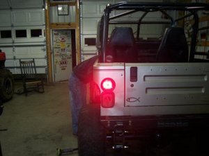

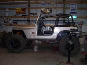

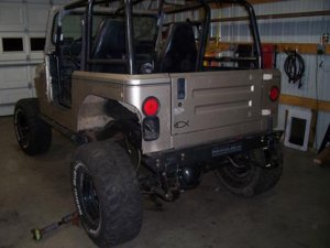

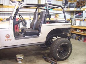

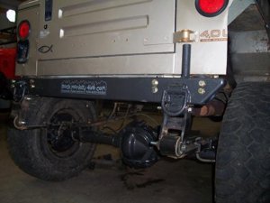

Little more progress....decided to do the cherokee leafs in the back and comp cut and move the gas tank to the back. Added some LED's and made the hangers on the back. Bumper with hangers is welded and bolted on. Sits a bit high in the back but this is unloaded with almost no gas in the tanks and when one person stands on the back it levels out. Still need to finish the drive shaft, strap tank down, build a traction bar, extend brakelines, get steering on the front, and a few other small things.
last....

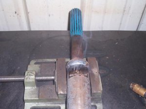

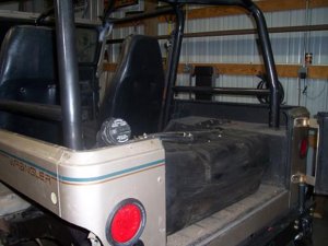

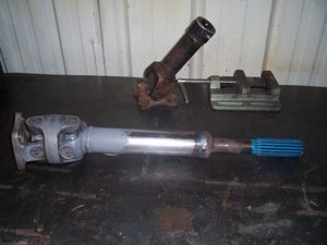

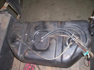

A little done tonight. Ended up cutting down an extra shaft a buddy had for the rear. Should work out pretty nice. Got a few pics of the tank in the back also since someone asked about it. Not mounted in place yet but the hoses are run and wires connected.
Tank relocation...

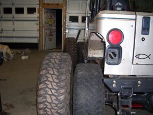

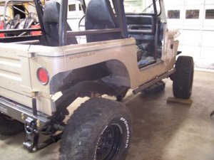

Got the 37's today. Now just need to get htem all mounted up...i know Brandon cant wait for that though so here are some teaser shots!
Thanks again Travis for meeting up and already being there when i showed up. We definatly have to go wheeling sometime.
