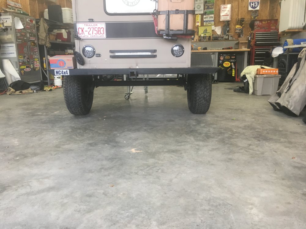

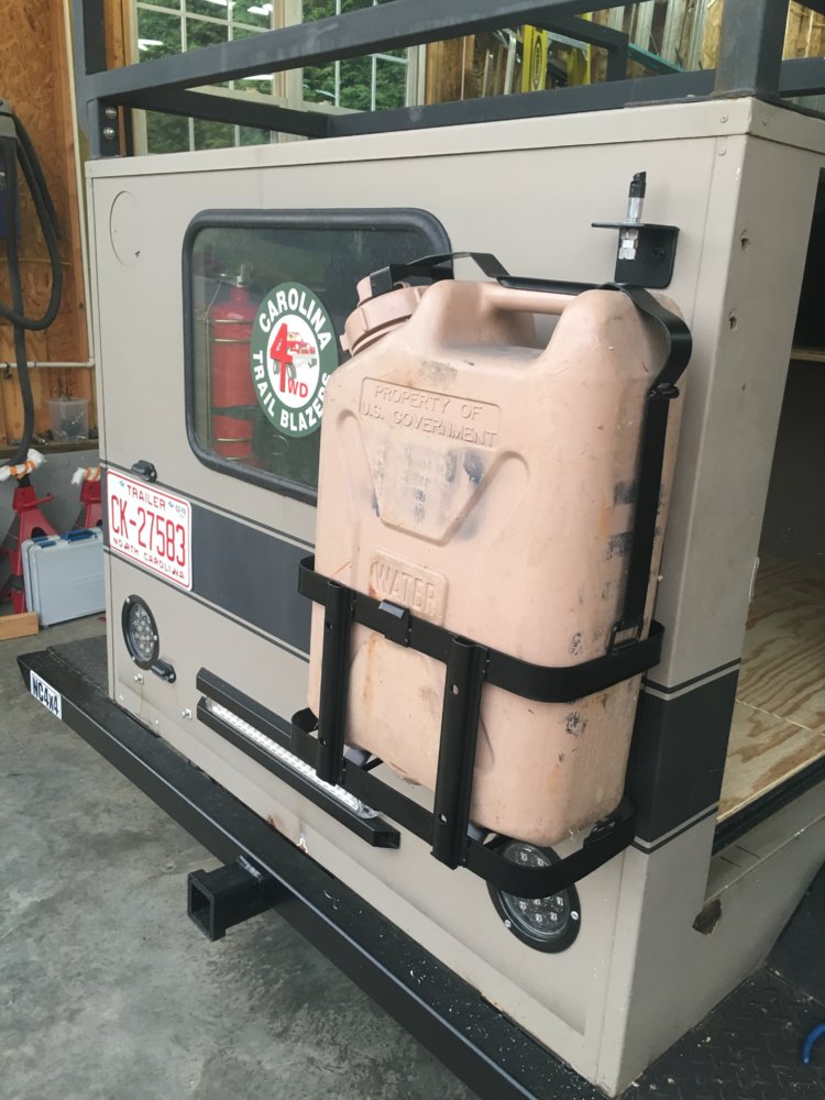

Added a Jerry can mount to the rear for a water jug.
So after putting about 3000 miles on the trailer it is holding up great. The only issue that I have is if I don’t load it properly with the heavy stuff in the front of the trailer there isn’t enough tongue weight and it sways. Thinking of either building a cooler mount on the tongue or moving the axle back to create tongue weight.
