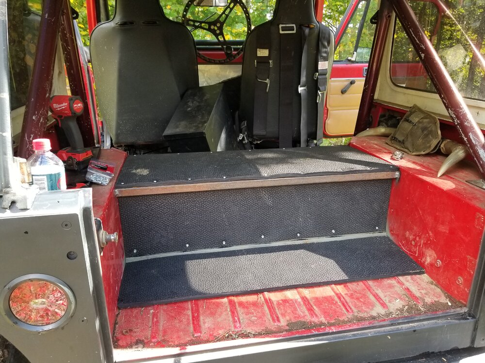

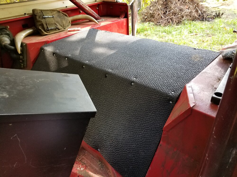

Got the rear floor closed up if only temporary. I used horse stall mat, worked really well. Replaced the front locking hubs. Then promptly drove it into town stopping at my LGS and Ingles.

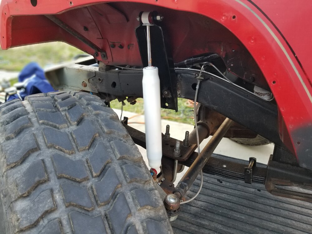

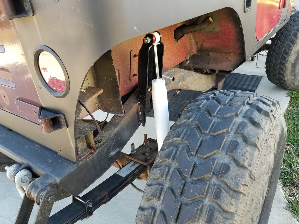

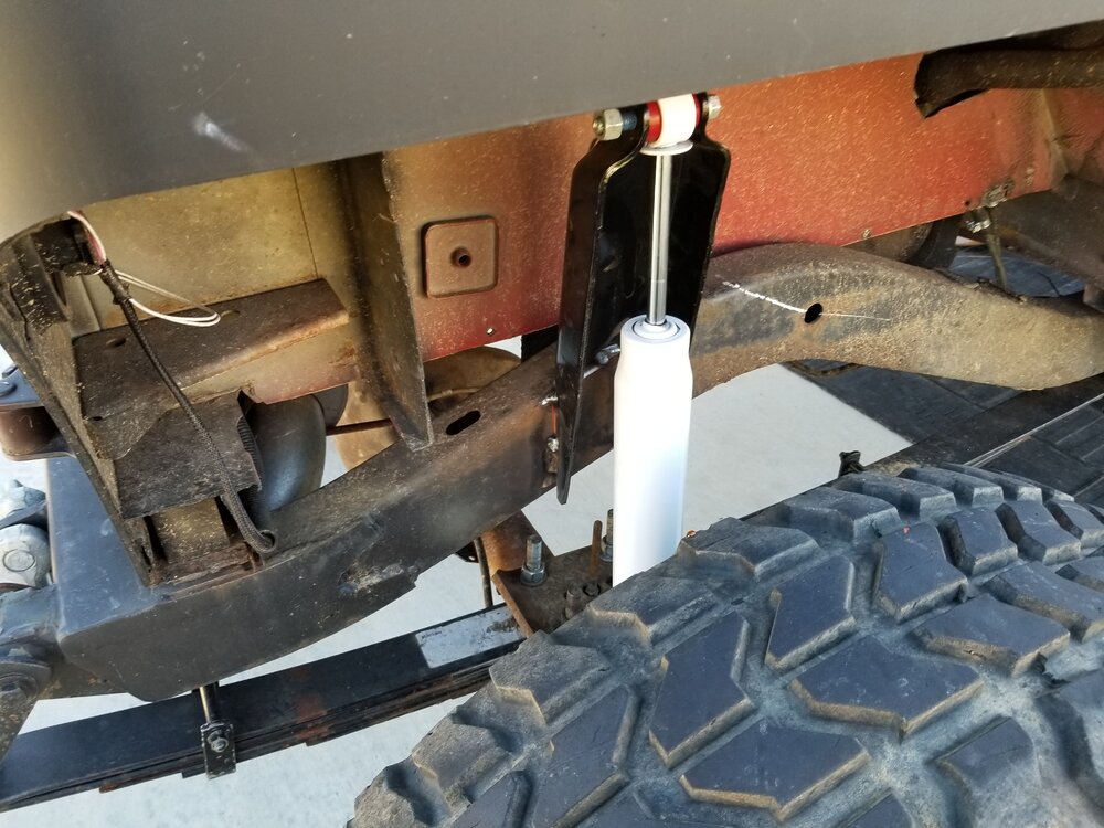

Got the shocks mounted.
I am kinda okay with how they came out... I mean they work, made driveability 1000% better.

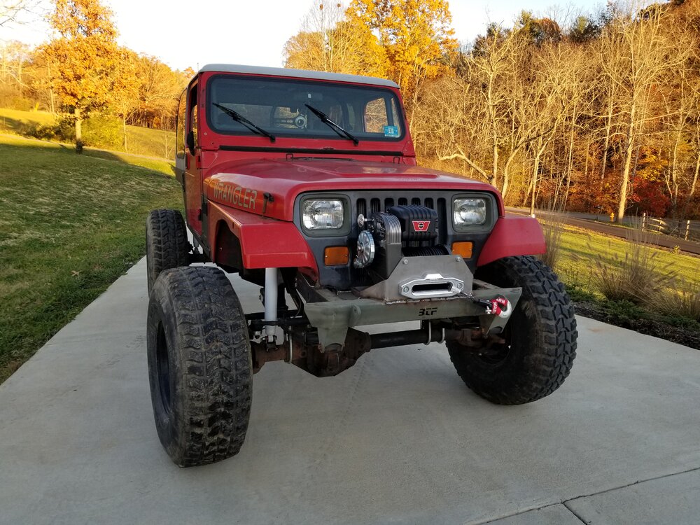

Ok, so this thing did well at the GTG this year but I do have some tweaks I want to make.
First being gearing. Currently it's a sm465/205 but that doesn't give me the low speed control I sometimes want so I was looking at the Atlas and also the JB conversions LowMax 3:1 builders kit so it's just a case and gears. I already have new shift rails and twin stick shifters. If I go Atlas those parts are of no use (wasted money)
Second being fenders which will probably be the Motobuilt
Last is to drop the winch down several inches.
Any Input or recommendations would be appreciated.
