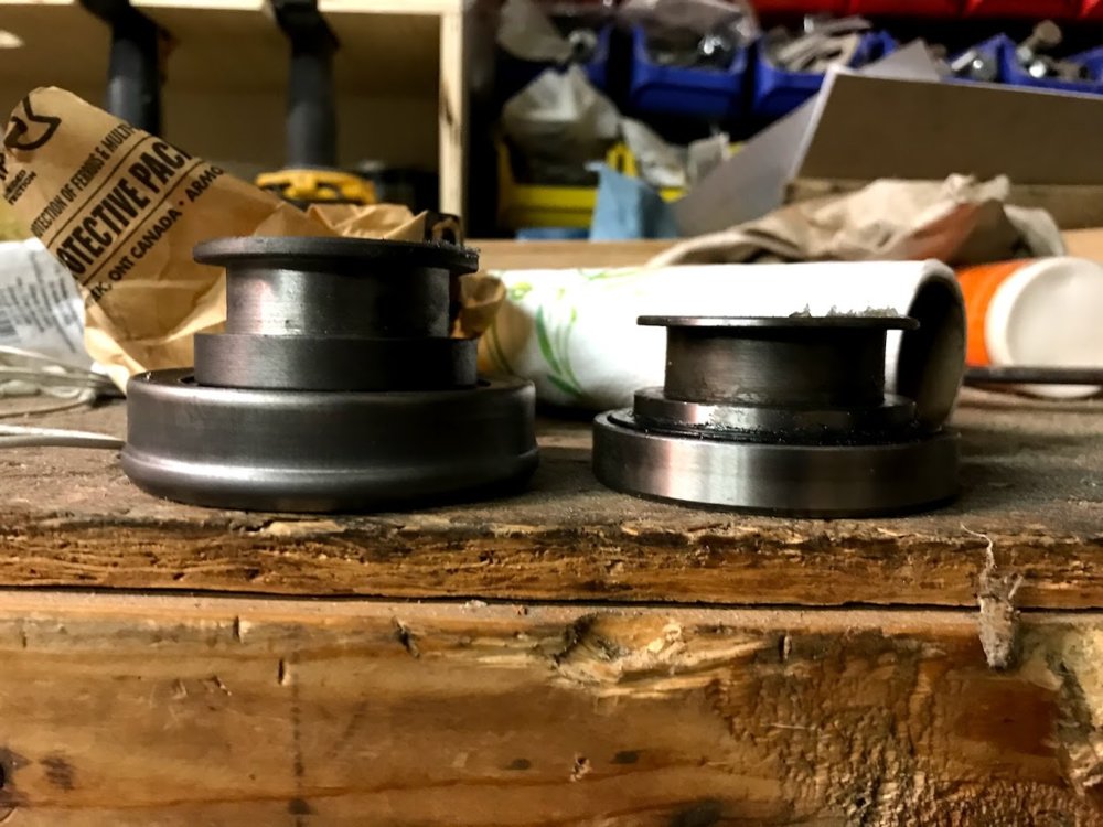

Apparently there are 3-4 different types of T/O bearings for the Sm420. You have the car version(what I have, the smallest) and then you have 3 different truck versions. I picked the middle of the 3 and went with that one.
Pretty sure I found the issue....
Bearing on the right was the original. Bearing on the left is the new one. I'm also going to be ordering a new clutch fork today as well. Hope to get it buttoned back up today/this weekend if possible. This should fix the issue. With the old bearing I was only getting about 1/8" contact on the clutch fingers. New one is a lot larger in diameter and also length.
So I'm gonna be a dick I guess, Have you solved the issue of the clutch/slave/linkage binding issue? I thought that it was the last known cause/issue?
Dick :flipoff2:. The slave issue has been sorted out. I redid the mount and it doesn't bind anymore from what I can tell. I installed the new T/O bearing and the new cast fork and it still doesn't shift with the slave:rolleyes:.
On a positive note, I can actuate the fork with a prybar by hand a LOT easier now. The new T/O bearing took up all the slop of the old one. I have about 1/8" or so of free play in the fork as opposed to 1/2" with the old one.
With the slave hooked up, it is very hard to depress the pedal. I can see the slave pull the fork back but its still not enough to disengage the clutch.
So, baby steps I guess, the new setup allows me to manually engage the T/O bearing a lot easier but still having issues with the slave. I'm thinking its air in the lines or my pedal travel now.
