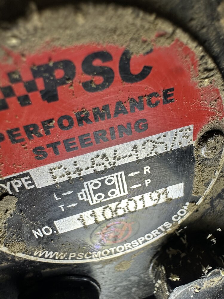

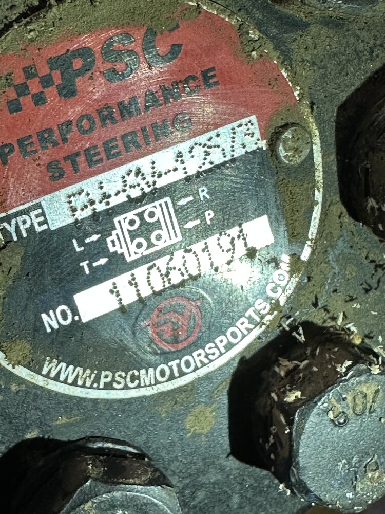

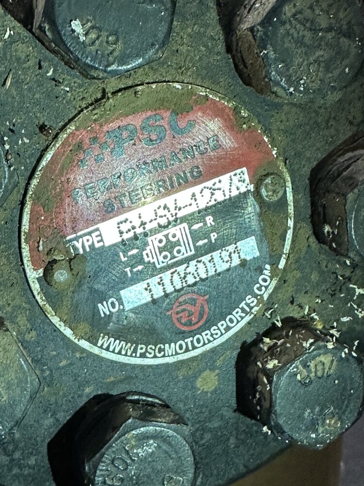

I’ve searched but not much luck. Can someone help me decode the numbers on this Psc orbital to figure out the displacement of it?
I see the problem with my “searching”. I was googling “ A1-6V-125/3” . Thanks @braxton357FH-SV 125/3. Its 125cc / 7.6 ci

3.3 turns lock to lock? Not far off from my current setup and ratio. It’ll be fine. I’d prefer a 9.7 so it would be 2.5 turns but I have this one sitting here.125 is damn slow
Easy swap later if I want quicker.
