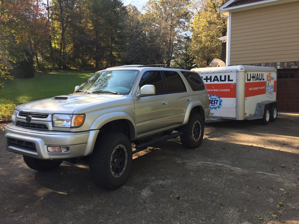

Not something I wanna do regularly, but it got the job done with no issues.
