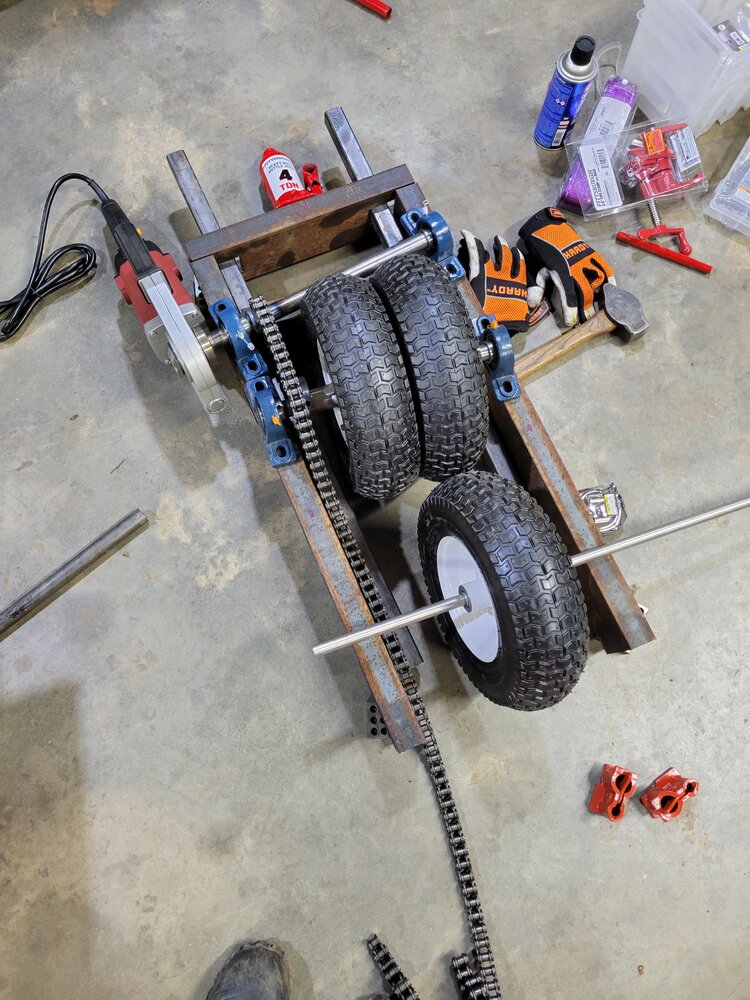

I'm actually 2 nights into building a pump puller for the plumber I do digging for, come try it out

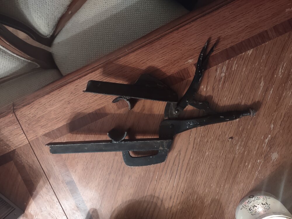

We used a skid steer with the forks on it, tied a prusic knot around the pipe and the other around the forks. Picked it up as high as the skid steer would go, clamped the pipe with that vice grip tool thing to hold it in place while we slid the rope back down as the forks lowered down, then repeat. It worked pretty good until we got to a coupling where the pipe was connected. At first I was going to cut it at every coupling, but I decided not to just in case the pipe slipped and we would have something to grab onto hopefully before it fell back into the well. We tried to raise the forks all the way up at one point where it had a pretty good arch and tied my mini skid to the pipe and pull it out. That didn't work, it kept breaking at the couplings, which would scare the shit out of me thinking it was going to fall back into the well. It was 1" schedule 80 with threaded ends on it.

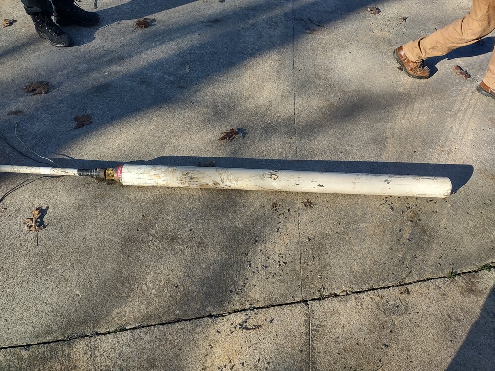

The old pump had a piece of 4" PVC over it. Quick YouTube search said it's to help keep the motor cooler. I asked a plumber buddy about it and he said he's never seen one done that way before. Asked the guy I bought the new pump from, he's done a lot of well pump installs and such and he said he's never used one. So I didn't put it on the new pump.
