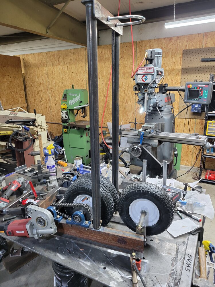

Glad you weren't waiting on me. Finally got time to finish this mfer.
