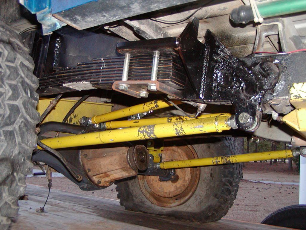

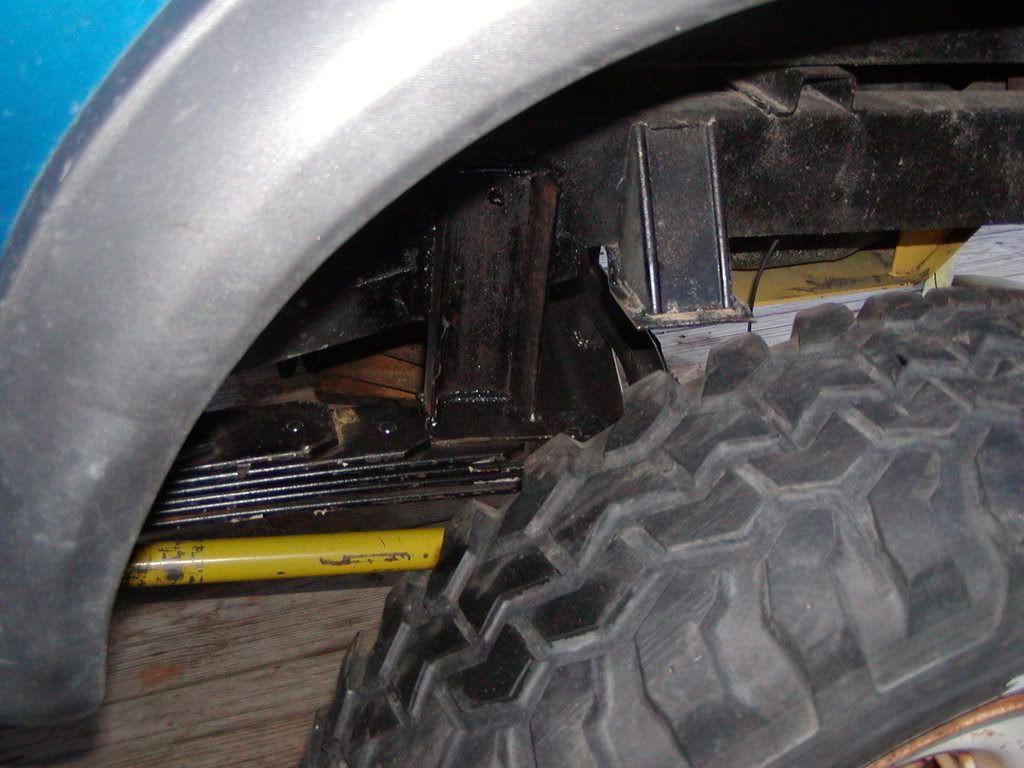

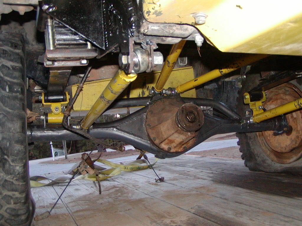

I could run over 70mph all day long on the set up I used to have, it had seen close to 100mph on several occasions, here's som pics.
thats pretty awesome...
my only question would be "why" when you have essentially done everything you would need to run coils aside from buying the coils or coilovers of your choice.
-Erik <--- would run that just to be different, but that's just me
Cost is a big factor. You don't have to worry about separation like you do coils. Limiting straps are a must, I would run shorter ones for the hwy myself. I have a friend that has them and if he nails the skinny pedal it will try to walk under the Jeep if no strap. But, the articulation is awesome.
upnover.........those are issues with the link setup, not the quarter elliptic. Like Rich said, it has more to do with the geometry than 1/4 elliptic
The 1/4 springs were stock MJ leafs cut up,shoved and bolted in a piece of box tubing. The shackles on the rear axle are stock XJ ones...cost $0, but yeah having them is quite the conversation piece.
