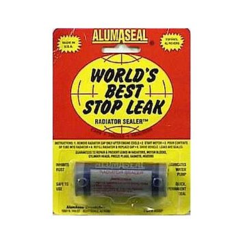

Alumaseal/solder seal is tiny, like glitter. It will not stop up anything. I have used it for years as a stop gap and once it stopped a head gasket seeping for over 50K miles. It comes in a little tube/vile and is about $3. It is not like big chunky stop leak brands and is a good product.
I've been using this stuff for four years in my wheeling rig after the third radiator with a seep at the tank (copper/brass) under a side strap where I couldn't resolder or job weld it I said screw it and dumped in a tube. Radiator quit leaking until the fan went through it. Heater never stopped up but it may have larger tubes than a more modern core too.
Had the radiator welded in the buggy but a pin hole didn't seal so I dumped a tube of that alumaseal in and it worked great. Stopped leaking as soon as it got up to temp and has stayed leak free.
